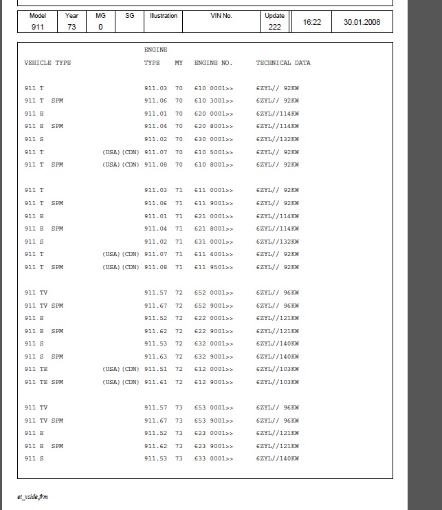

I have come across three 911's sitting in a yard. The one I'm really interested in has a serial #911021----, this would make it a 1970 911E Targa. It does have the 2.2 Liter still in it, but missing the injection, now webbers.
My question is; The 911 T, E and S had engine serial number to match the model, but I'm a little uncertain about what the sequence of motor serial number should be from the internet sites. Does anyone know for certain? When I look at the car again on Sunday, I would like to determine if it has a matching E motor.
Also, one coupe was manufactured 10/1973 and sold in 1974. It has had body modifications to 911sc spec's. With this build date could this car have been a late long hood model? Serial #9114100802

You can find the engine serial number and type number information for the 1970 E in the V-pages section of the PET software, which you can get for free from Porsche.
The coupe you mentioned is a '74 model, no chance it's a long hood.

This is from the PET V pages. Early 1970's engine numbers. Hope this helps

rkulina: JR is the Master on this stuff, so this is just additive to his post. The serial number on the 1970 indicates 1970 Targa E, but you need to post the engine serial number - should start with 620XXXX. Manual Trans 911/01 or Sporto 905/20.
Also suggest you look at 911 E registry if you have an E. Tons of info there, you can get a fair idea if engine and vin are matching - not exact.
