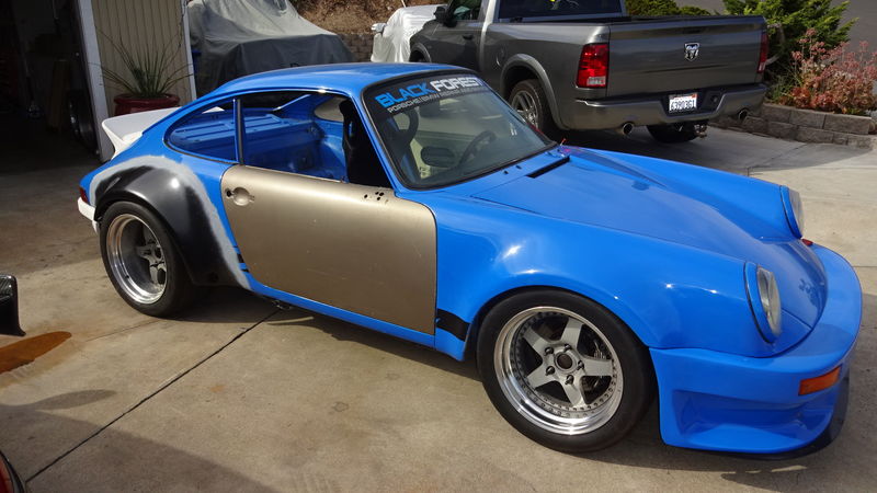

Thanks for comments guys. I always enjoyed going to the track events and watching my old cars run well. Getting it back and giving it a facelift is good fun. Was busy over weekend finishing up rear flairs and fitting new bumper from Dave Kealoha. It is so light it tried to fly out of my parts hauler when it hit boost.

New doors with power windows getting hung to replace gutted doors. Cage finally out after about 20hrs of cutting and grinding. Lindsey Fuchs getting refinished. Rally car shift tower leaving soon.

Actually I have no plans to neuter the car. The cage will be replaced with a rear bar otherwise same drivetrain and suspension so it can do an occasional track day. Its good hearing from all the people that got to ride/drive the car over the years.
