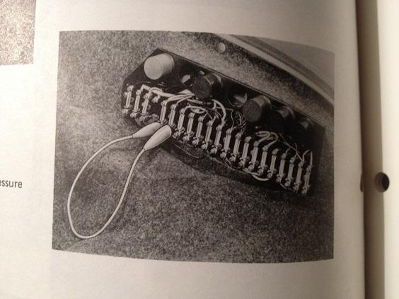

Pull the red relay in the front board.
Jump 30 and 87a, with key on, the pump will run

Hi Jason..or use a little jumper wire with crocodily end connector.Bridge fuse no.6 and 3-5 the pump will run...do not do it for too long.

If you are able to remove the AFS plug with the spring lock, your plug is already defective. You should not be able to pull the electrical plug unless it is no longer locking. If you want to test run the fuel pump, use the FP relay socket.
Remove the FP relay and jumper terminals 87a & 30 (relay socket) using a suitable jumper wire with inline fuse and switch and ignition switch @ RUN position. You need this jumper wire set-up for your fuel pressure reading tests. I just don’t understand why people want to ruin a good AFS plug by yanking it out to do a simple test.

I use 15 or 20 amps fuses for my jumpers. Actually, I prefer the lower value 15 amps for my bench tester and I run my FP’s for hours. The 25 amps is the recommended fuse in the fuel pump circuit but have no problem using 15 amps in my set ups.
Your engine wire harness has the two-wire white electrical connector as mentioned by Dennis. One wire goes to the CDI and the other brown/red wire goes to AFS switch (Or Terminal #85 @ FP relay socket). This is where you do your testing for troubleshooting your FP, AAR, WUR, TV, and AFS switch).
Search for DKLever48’s post regarding FP relay testing and you will have a broader understanding how the electrical circuit works. Be an educated troubleshooter and share your experiences.

I'll use 30 & 87A for testing, thanks

I like using the jumper on the Red CDI Power wire at the CDI T plug location as you can do it without running to the front of the car to mess around with the relay.
No fuse needed.
