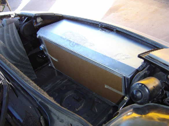

Well, it has been a long journey to get where I am now. It goes tomorrow to the muffler shop to get the exhaust system custom made and installed. Here are some pictures of what it started out as and progress along the way to where it is now. With any luck, it will breathe life this weekend. I am interested to hear any suggestions and comments. Feel free to speak up.

Ok, here are the exhaust pictures, I am very pleased with how it came out. First is a picture of this morning on the trailer before the muffler. The second is after, can you tell the difference? The third one is the underside. I can hardly wait to hear it run now. Saturday is the soonest I can do anything more on it. Too much work tomorrow.

Came out clean. You be sure to let us know how you like the sound of that muffler. Do the axles clear the pipes if you raise the car? Maybe some other things to check: keep the fuel lines as far as possible from the engine and headers. I slipped some armaflex tube insulation over mine (not the cheap polystyrene stuff) to keep the fuel line cool. Check the heat radiated off the exhaust over to your fuel pump. When the car is not moving (no air movement) then things can heat up and potential vapor lock. I got advice to drill holes in the thermostat. This helps bleed air out, but only drill one if you do it. I had 4 small holes and then it took a long time for my engine to heat up. I'm down to one and it still takes a while. Make sure all your metal fittings for hoses have a lip or rolled edge to capture the hose clamp. Don't want hoses to blow off. Just use water the first time to leak test, put in anti-freeze later. Will you be able to see your timing mark? Maybe I can think of some more stuff.

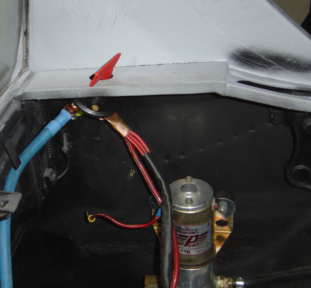

Well, here is what it looks like after the weekend of interuptions. I am still working on the wiring. The front where I put the battery is mostly done, once tested, I will mount the battery and clean up the wiring. The back is where I am at now trying to figure out where all the wires go and how to wire them.

Well, it's not as close to being done as I want, I tried to start it last night and it backfired and didnt start, I am guessing that the timing is way off. On the good side, it backfired and that means I am getting spark and fuel. I didnt get a chance to work on it today and probably wont tomorrow but hopefully this week I will get her fired up.
