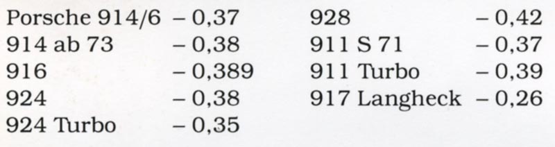

Originally Posted by Matt Monson View Post
Yeah, I wasn't even addressing the tendency of the 914 to get light and turn into a wing at high speeds. I was just looking at the coefficient of drag and what kind of speeds it can reasonably hit in a closed course environment. Being able to actually hit those speeds safely is a whole nother thing all together beyond having the power and gearing to get up there in the first place.
The coefficient of drag for a stock 914 is actually pretty good, in fact, it's better than a early 911 turbo ...
>> 1970, 914-6, 3.6L (Conversion)
>> 1970, 914-6, #374 (Original)
>> 1975/73, 914 Limo (Custom)

Posts: 23,649
I didn't say it was bad. But when we're talking about 170mph+ aero matters. An off the shelf 3.6l turbo swap is not going to be getting a 914 chassis up to those speeds to my way of looking at it.
