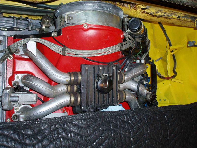

I just finished doing a 3.0L injected install and I love the way it starts on the first click! I modified my injection and removed all of the smog so if you are planning on keeping it smog compliant you will need to find out the minimum requirements for your location.

What fuel distributor/intake are you using there? Neat setup.

It is the stock fuel distributor on an early Volvo 242 intake!
I cut the stock air boot in half welded up the 90' bend then powdercoated it Yellow and attached the air boot to each end!

The Volvo stuff took me a long time to figure out and I finaly just welded up my own intake 90' elbow! It is very clean! I have thought about putting together a package and selling it!?

That might be something I would be willing to try to put together! The challenging part is the 90' elbow, the mounting brackets that attach the Volvo mount to the intake runners and the modified fuel/air boxes with the pop-off valve. But if people are willing to modify there own boxes then it could be done for a reasonable price!
Old 01-28-2012, 08:33 AM
Join Date: Nov 2010
Location: Discovery Bay, ca
Posts: 269
Here is what the modified fuel/air box looks like!
