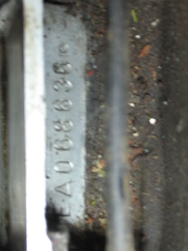

So my 2L GA motor has a 6 digit engine code with a small dot stamp after the last digit. Factory replacement motor? Any ideas?

I'm pretty sure all 914-4 engine numbers are 2 letters and 6 numbers followed by a dot. These are VW engines fully assembled in the VW plant so they follow the VW format.
The 70-71 1.7 motors start with "W". Codes used in 914 engines were:
W: 70-71 1.7
EA: 72-73 1.7
EB: 73 California-only 1.7
EC: 74-75 1.8
AN: 74-75 European-spec 1.8
GA: 73-74 2.0
GB: 73-74 European-spec 2.0
GC: 75-76 2.0
I don't believe that most of them would have a dot. There were extra marks added when a "factory VW" rebuild was done, though. A VW stamp surrounded by couple of arrows circling, I think.

I'm having a very hard time finding a case later than a "W" without the little VW dot at the end of the serial number

Ok, so the 6 digits after the GA is normal? In looking at one of the books, they must have additional 0's before the code that do not need to be accounted for. And my dot is the same as the above posted pics.
I think that is correct. Both my 1.7 and 2.0 are otherwise missing a digit.
