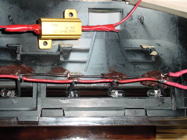

I can finally see my instruments at night. What an improvement. I dumped the old mirrored plastic light tunnels and have fitted 9 LEDS, 3 super bright white per section.
The intensity of the light is hard to capture on the above picture. The current LEDS aren only working at 50 % capacity.

Ok here are some pictures,
Hello all, I have been having trouble with the electricals in my dashboard since last friday. The wife and I took our 951 for a little fast run, and suddenly I noticed the 'BRAKE PAD INDICATOR'
light on. I wasnt sure of it at the time because the words came up in German.
Anyway, I wasn't going to post any pictures, but this afternoon, the alarm came up again and my water temp gauge went up to the red zone, which caused some concern, after all the cooling system has just been overhauled. New pump, thermostat, all hoses, the works.
I have noticed a blown diode, in the back of the cluster.
Here are some pictures of the LED conversion and the blown diode and track.
You must also use a resistor in line to reduce the voltage to the LEDS, reducing the voltage from 13.8 to about 3 Volts DC, failing this, the LEDS WILL BLOW.
The resistor I used is an 90 OHMS, 25 WATTS. I used one of the olD dash BULB HOLDERS to power up the LEDS. [img]

My plan is still to make an LED holder using perpex plastic glass, the same dimentions as the old light tunnels. Drill 3 holeS 5mm, and fix the LEDS. I tried it, but the plastic perspex glass was 6 mm, so it get cracking, I'm still looking an 8mm thick that may work.
Parts required:
1- 9 x super bright, clear white light LEDS ( Electronic store, like RS, or Farnell. Dont know part numbers
2- 1 x 90 Ohm , 25 Watts Resistor
3- common wire
Tools required:
Electrical pliers, soldering iron, soldering lead, Multi-meter
Method:
See drawing,
I - LED HOLDER
II- RESISTOR
III- Lamp holder
connect all negative legs of LEDS together (shorter leg of led)
connect all positive legs of LEDS together. ( longer leg of led)
Do not short between negative line and positive
Connect resistor to either one of the wires as shown.
The LED is polarity concious, so it will only work one way.
Use one of the old light bulb holders to provide you the power supply. Remove old light bulb, and refit back on instrument cluster. I used the middle light bulb holder, the lower connector on the pcp is the Negative. If it doesn't light up, reverse the old light bulb connector.

Here is a better drawing

good idea but it looks like you have a lot of shadowing going on there
