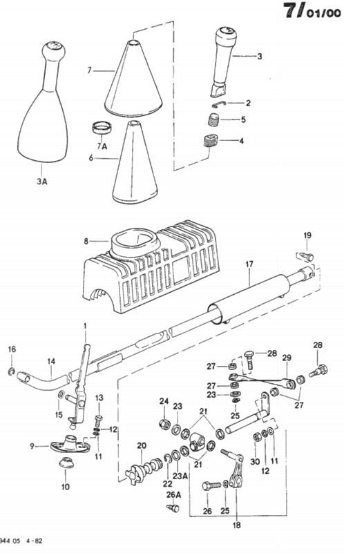

Just got my 944 together (came in pieces and it had been sitting for a while), and it was running funny. The car has a low idle and real trouble taking off in 1st gear, but no problem going in reverse. I think it is not even getting into 1st-seems like it is in 3rd- because when I shift to 2nd the car starts to really show improvement. I've looked over the shifter and played around with it, it does not seem to be the problem. So, I loked at the linkage tried adjusting this (pic) and broke it. Where can I get a new one and how much? What should I do to correct the problem, besides getting the new part?

If that is a bolt that is sheared on the end you can either drill it out and replace it or I have one from a 924 that you can get if you want.

Looks like both ends have the same shoulder bolt. Item 28.
If the threads are broken off in the trans housing you may have to drop the trans to get the threaded section out.
You can make a shoulder bolt by slipping a section of tubing with the proper OD and length over a regular bolt.

The short shifter still uses this part!
