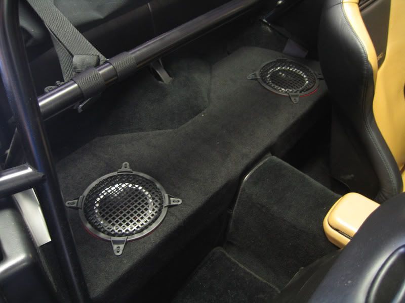

i built a unit that sits behind the seats, in the rear seat wells - it is a dual chamber unit, run in stereo - each chamber is .35 cu ft - each one has a JL Audio 8" 4ohm driver with a Profile 400 amp run bridged mono for each
i can still fit 2 cases of wind back there, and i get a back massage to boot
this shot is before i swapped out the drivers to the JL, but it looks the same
http://img.photobucket.com/albums/v481/flash968/IMG_1672sm.jpg

Hay flash....Where did you get those 8" grills? I haven't been able to find any good ones yet.

great looking subs flash.

thanks - now that i've finally nailed it, i think i'm actually going to get around to making reverse molds of the back shells and a template for the baffle plate so that others can duplicate it - i thought about selling the thing complete, but i really don't want to go into that business - it would be cheaper and i think more fun for people to just buy the backshells, make their own baffle, and upholster it how they want
i got the grills from either crutchfield or parts express - not sure - i'd have to go back and look
