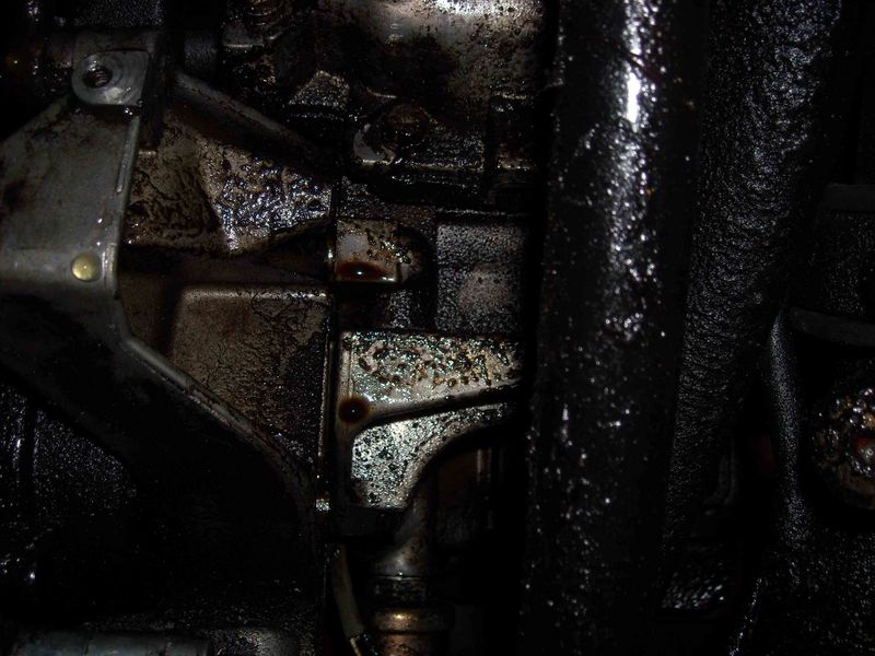

grand at a local shop, replacing some items from a parts car, and buying a new set of Bridgestone G009s, I was off and running. I spent the next couple of years putting 15k miles on her and learning how to drive a p-car. Over that time I only had to replace the thermostat, then later the thermo swith, and later the fuel lines. Not too bad for a 23 year old car. But then, there appeared a leak under the water pump. Called the shop and they said $1200 for new belts and water pump job. So, I starting shopping for some tools and reading up on the job. I settled on the Maxi 944 kit from Arnnworx. Bruce at Arnnworx also hooked me up with a kricket tool for my other belts. Thank you Bruce!
I got all my tools together and rolled up my sleeves. This would be the biggest project I've attempted thus far. I followed Clark's advice and tore into it. And then:
Holy oil leaks Batman!
The seals around the balance shafts were good as I had those replaced in March 08, but the crank seal, oil pump drive gear and o-ring were suspect. And, looks like the AOS seals need replacement.
Looks like the intake has to come off.
How about some oil in the intake?
I have lots more to post, but the wife is calling and I have to go. Stay tuned for more. Also, I ask for your patience as I haven't posted much and I'm still learning. Thanks.

WOW!
AOS defective seals will cause oil to be sucked into the Throttle Body. Clean out the Throttle Body and the ICV/ISV with Gumout Throttle Body and Fuel Injection cleaner. NOT Gumout Carburator Cleaner.
You could rebuild the Throttle Body WYAIT with the kit from Bruce Arnn Home
Yes the lower crank seal, "O" ring need to be replaced. If the oil pump drive gear has a seal groove---------------replace.
You'll be done in no time
GL
John

Uhgg! But fixing oil leaks is one of the most satisfying jobs there is in my book. A toothbrush and lots of engine brite will take care of that mess pretty well.

The "AOS" is the air oil separator - that black thing with the yellow top, you pour the oil into it when you are a quart down. There are two O'rings attaching it to the block, one upper and one lower, they are different and two different part numbers are needed for these. When these seals are gone/leaking it sucks the oil into the intake often.

The intake manifold has to come off to replace the AOS "O" rings. Since yours is off now with the head, it just makes sense to do it on a 25 year old car. You may not have oil in the intake now, but what about next year in Canada?

Making progress. Cleaned up the throttle body.
Pump came off fairly easily.
New AOS seals.
Intake off. Cleaned out all vacuum hoses to the ISC valve with some throttle body cleaner. Ran some wd-40 throught it.
Crank seal was leaking. So, I replaced the oil pump drive gear, the seal, and the o-ring. The drive gear had some visible wear, but I wouldn't say it was a groove. Anyone like the Gulp jar I used to install the seal? It worked great. Oops, gott go for now.

Nice work. Quite a difference from the top photos.
