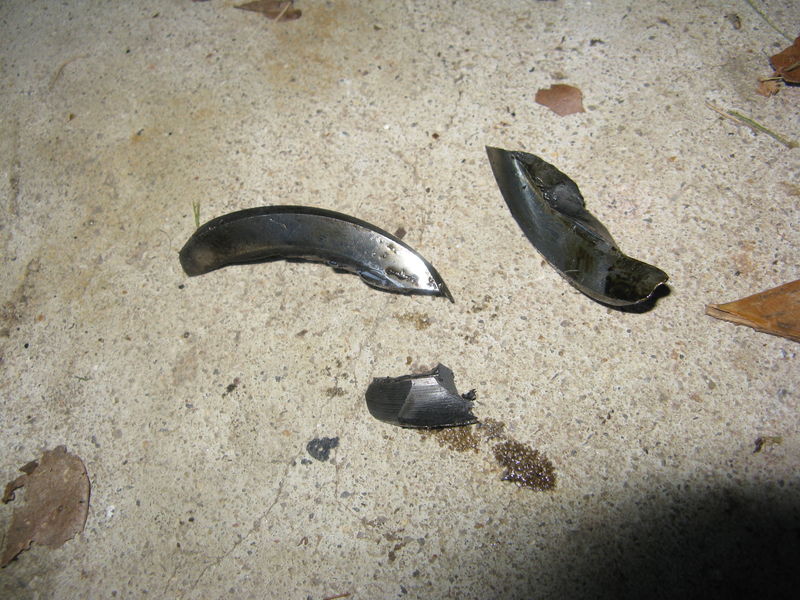

What you described was exactly what it was like when the final drive ring and pinion took a crap in mine a couple years ago. Just pop, clunk, clunk, skid to a halt. After looking under to see that the drive axles were still there and attached, the drivetrain would "bounce" off of itself against a very hard jam that was able to be muscled through with alot of very horrible noises. These transmissions are known to fail this way. Worst part was it did it out of nowhere all of the sudden just pulling out of a parking lot. I didn't even have the fun of failing catastrophicly doing a killer burnout or anything. Not that I ever would, but if it's going to break anyway... Sorry to hear it!

Nice video HDR!
...Redneck,
In the video the inspection plate, passenger side of the transaxle was taken off.
If you find nothing else wrong from previous suggestions, drain the transaxle fluid in a bucket with a rag over the top. Panty hose works. You may see slivers of metal. You might want to reuse the fluid if nothing is wrong.
If you want to go further, Remove the passenger side CV and axle.....Inside the transaxle hub is another bolt to remove and the hub will pull out.
Remove the 12? bolts around the inspection plate and pop it off.
With any luck, you will not see what HondaDustR had in his video.

worst pics and vid EVER HDR.. it will take me an extra hour to fall asleep Now did that junk the case and everything? or could you replace the R&P?

pete... N/a transmission are so cheap its not worth rebuilding after something like that. Bearings for the rebuild alone will cost twice as much as a used transmission then unless you know what you are doing its not going to last anyway. Then he would need to come up with a R&P...

Think the pics are bad? You should have heard the noises when it let go! And the noises it made limping through the intersection it died in front of. The case appeared to be fine and it was all sold for parts. It is possible to replace the R&P, but there's alot of press fit stuff, bearings that would need to be replaced, and even worse, the new R&P would need to be correctly shimmed. The workshop manual diagram for that makes heads spin. A good used NA transmission costs around $500 shipped. A R&P set alone is something like twice that.
I don't know if it was dumb luck or good fortune, but the night before I was driving home from NJ at 1 am. After the fact I really was pretty ok with it dying when it did.
