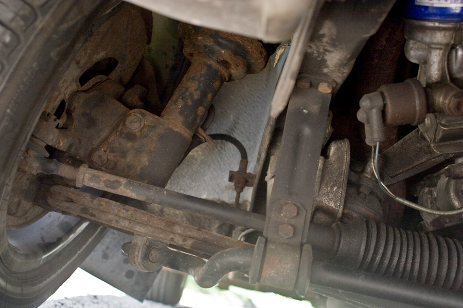

The front pass. side wheel is now positive cambered at about 30 degrees. I know virtually nothing about the suspension and steering systems on these cars, much less any car (never had to take care of an issue on that front... yet), but it looks like the strut is buckled. It'll roll but it won't drive.

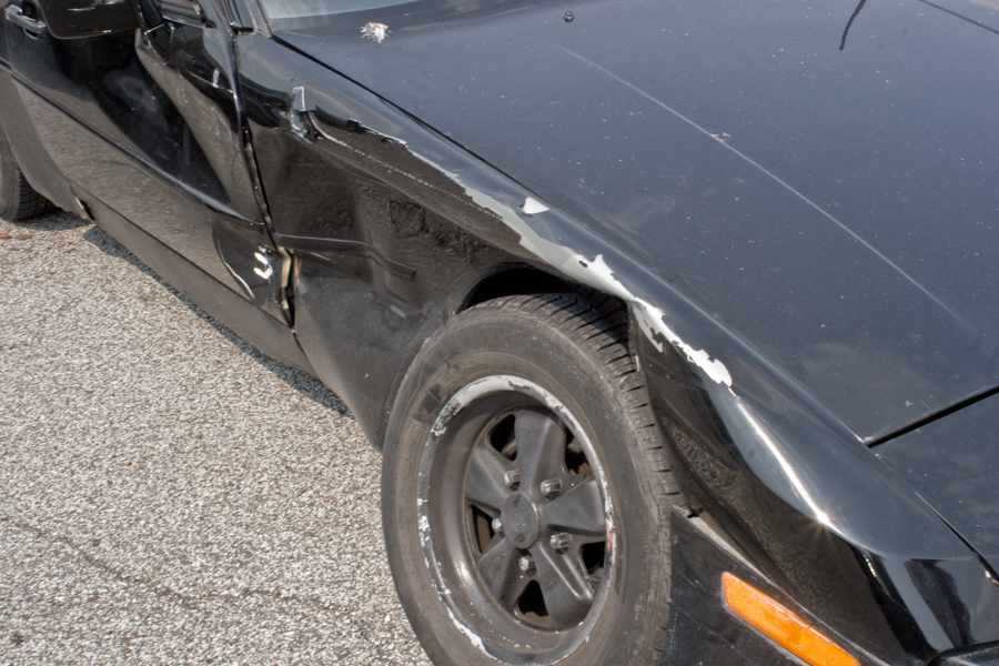

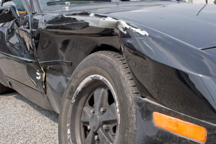

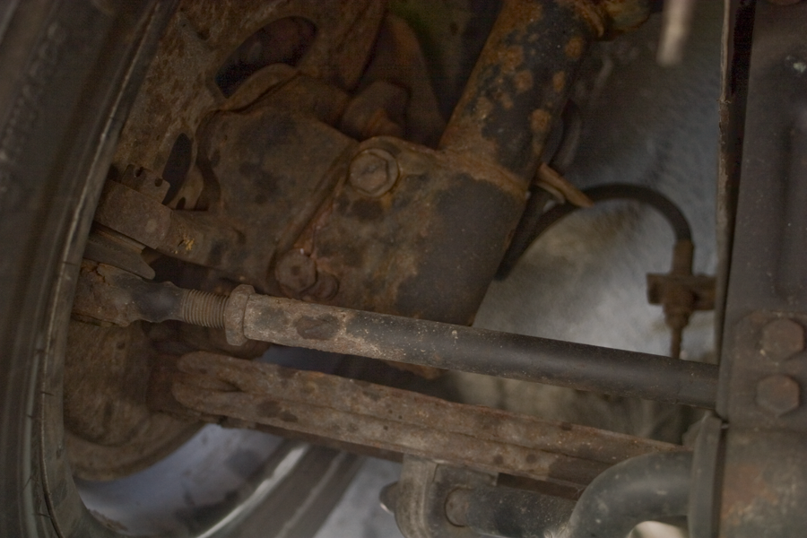

Well, here are some pictures of the damages. They're pretty ugly, so ready yourselves.
What do you think? Tow truck driver said it looked like the control arm broke, but since I know nothing about the suspension and steering... I can't confirm or deny that.

typically in a wheel cambered situation, the control arm does bend/break. but it looks straight from the picture. the strut is def bent. and the strut tower top moved so that accounts for the camber.
at this point...is it worth it bending the frame back?

So forgive me, I'm a newb; by the strut tower top, do you mean under the bonnet, where the strut mounts to the car body? As in that entire inner quarter section, not just the fender, was bent by the impact? Because under the bonnet, everything honestly looks fine... It looks like the fender and the tire took all the impact and left that inner quarter section intact.

it's not worth fixing. it is going to cost you a lot to straighten that strut mount back out, and it is never going to be the same as before. if you choose to take that route, bring money.

I got no money. Money enough for new panels, if I pinch pennies for a while, that's about it.
If you're right, and that mount has moved, then it really isn't probably worth it. I'll keep you guys posted.
