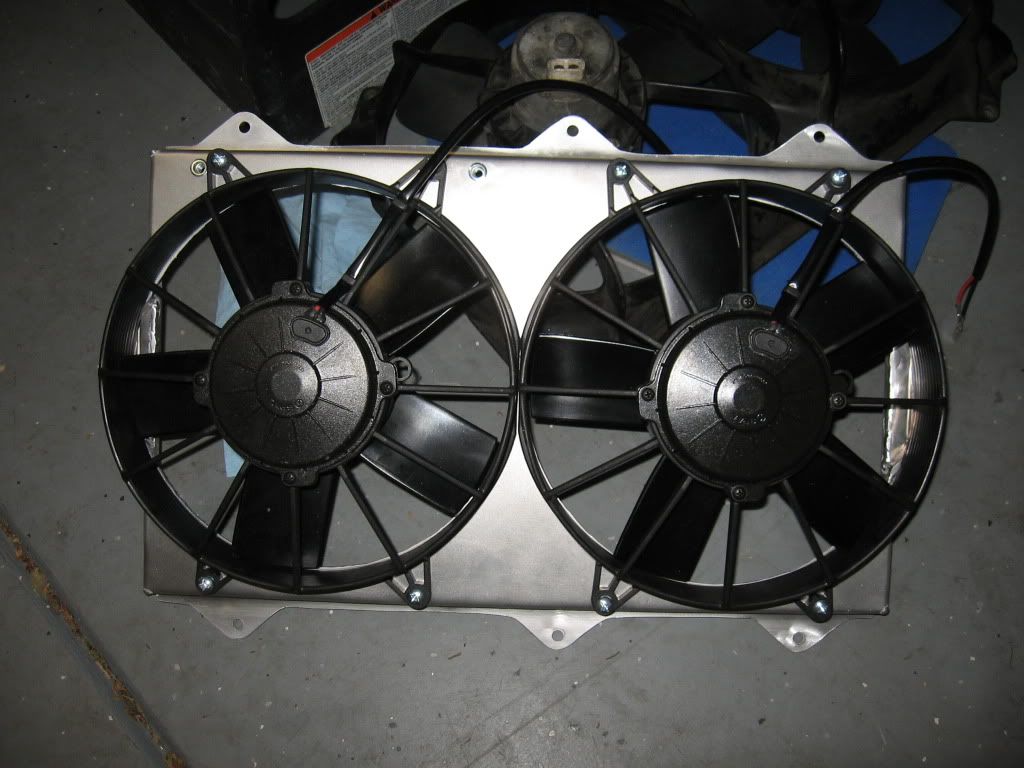

Housing is warped, fan is drawing too much juice, failure of fan relay is next.
Path of least resistance. . .junkyard replacement. Path of thexthiest resistance. . .custom aluminum shroud with dual modern fans.

Nice looking fan shroud, what fans did you use? Looks like the corner boxed edge is welded up, correct?
And....is "thexthiest" an newly coined term by you???
