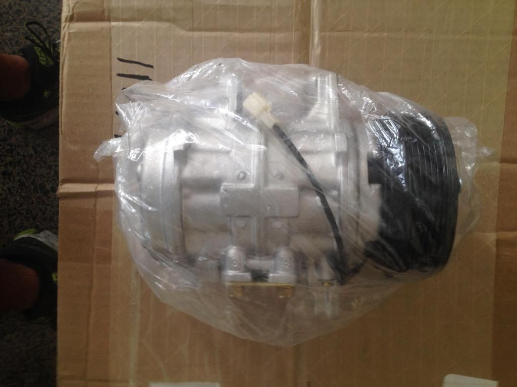

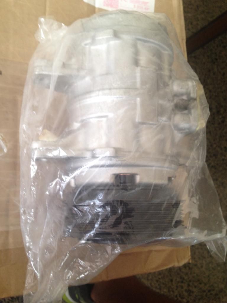

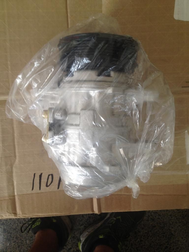

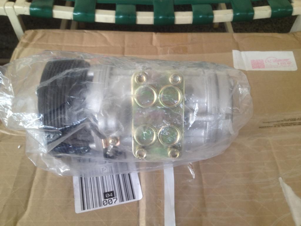

Which A/c compressor is this one?
I received this compressor from a supplier on HK.
It seems to be the same body as the Nippon 10p15e that we use, but mounting points seems to be on a different position.
Anyone know what model uses this compressor, of if I can use it on my 85.5 adapting the lines. Mounting points for early 944's are different than 85.5?
Any help is welcome!!

It appears (if an 85.5 is the same as the later 944's and 968's) that it is missing a mounting ear on it. There should be two (one on each side of the blank off plate), one for the forward upper mount, and another for the upper rear mount.
I just replaced my 968 compressor because I broke a mounting ear off, here is a picture:
Here is a detailed thread with lots of pictures:
AC Compressor Replacement - Rennlist Discussion Forums
HTH!

85/1 and 85/2 are two different animals,
what you got is "almost alike", return it and
buy one from the host, oe pn was 944126008

right compressor for an early car, but the case is 99% likely meant for a Ford of the same vintage.

almost right compressor for a "late" car, 85/2 but missing ear
