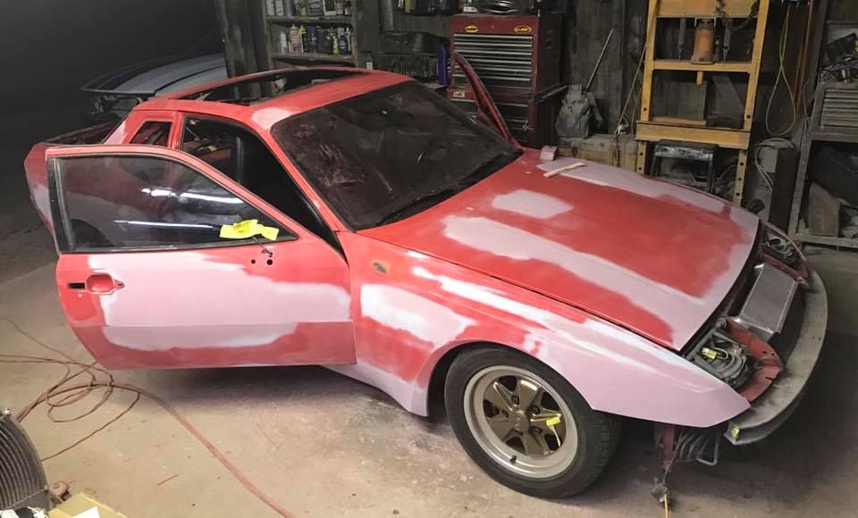

Progress so far

Looking good, man.. Like I said on FB. I gotta get me one of those units are Harbor Freight soon. I've got a roller with a few dings in it.

That is coming along nicely.

From porcupine to beautiful. Looks like you have good metal man. The British TV show "Wheeler Dealers" had a 924 with similar damage, Edd pulled out the quarter panel the old fashioned way with drilled holes and a slide hammer. A few seasons later he used a similar welding method on a Ferrari 308 and I was amazed. Very impressive system, hope I never need it

Wow. Nice and straight again. And did you decide to respray the whole car?
If your guys paint is as good as the bodywork, that will be gorgeous when done. Still lusting after your wheels.

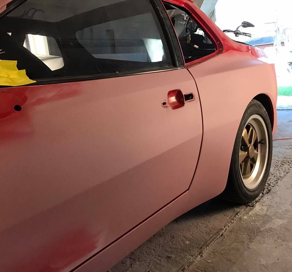

Nice job so far. Tell them to take the door handle off. It comes off super easy as in one screw!

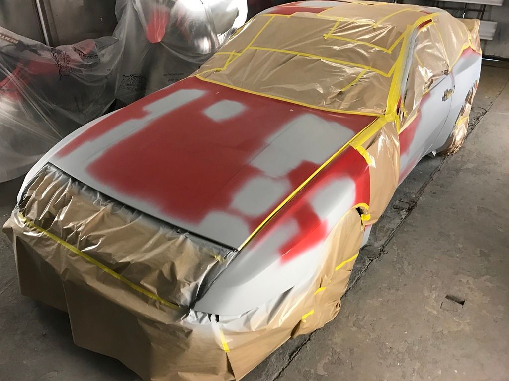

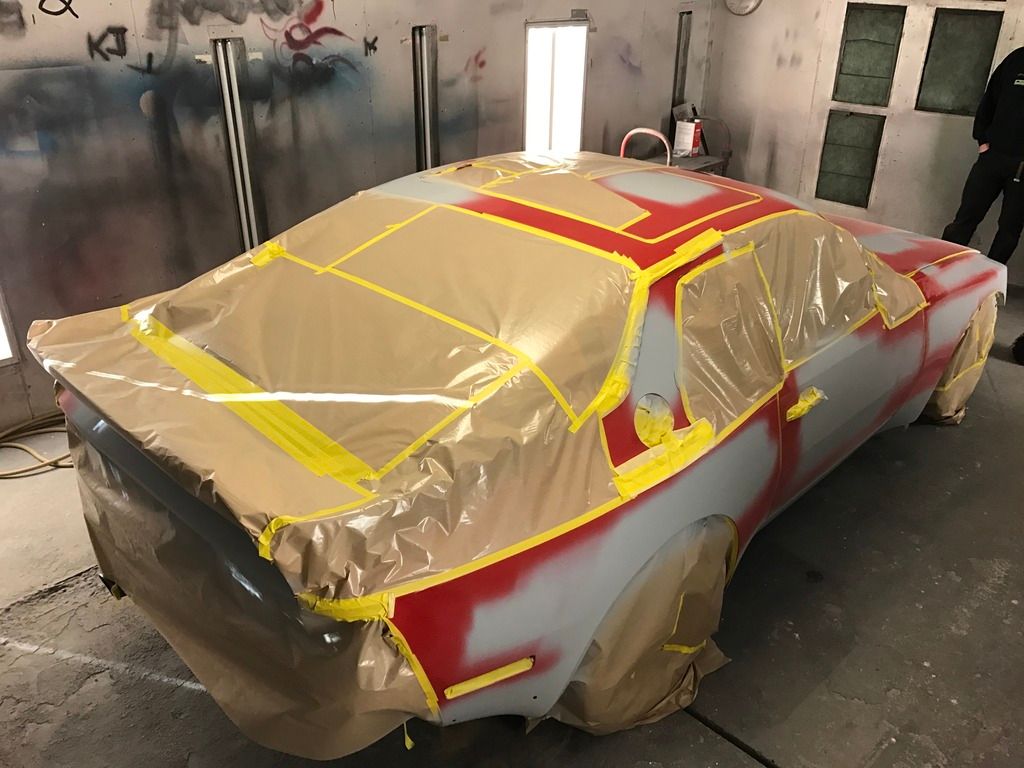

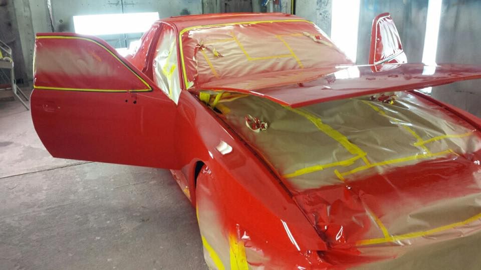

Door handles came off, we just weren't that far along yet. Some more progress pics:

Nice paint job, I had a looser pos crunch my door, hit and run. I found a door at a junk yard, had it painted , and with the help of a body shop buddy, I installed the door. Lots of fun stuff to break and disconnect on the 951, lots of stuff.......

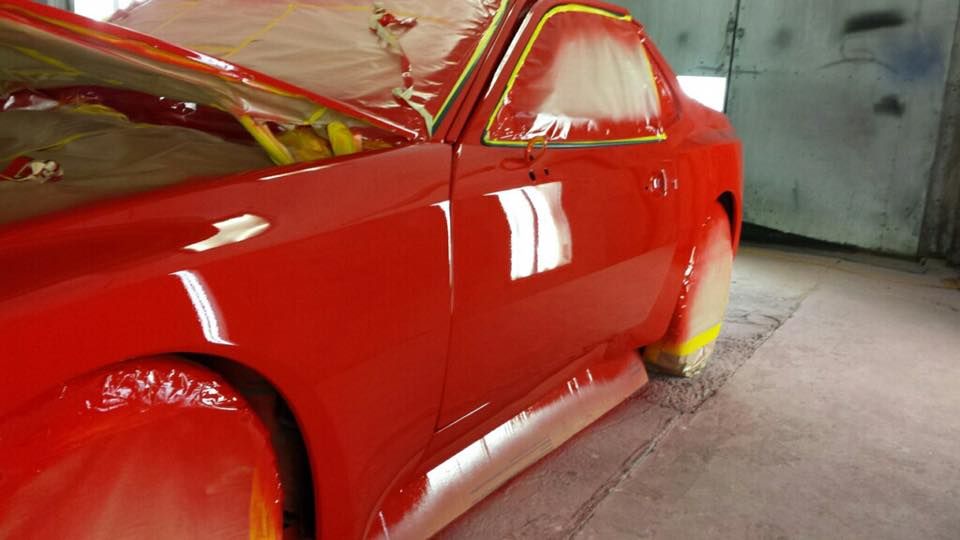

Old 03-14-2017, 08:12 AM
