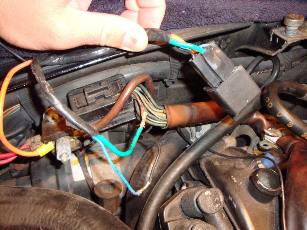

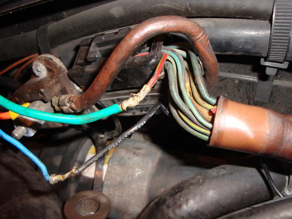

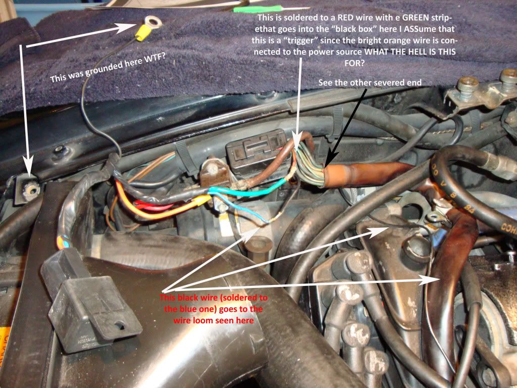

When cleaning and inspecting the grounds I found this precarious looking ground on the front fender (See pics) WHAT IN THE WORLD IS THIS FOR and where does that ground go that I followed under the car??

Looks McGyvered to me. Doesn't look stock at all.

Did you try and temporarily remove that non-stock piece and jump the correct wire together? That's what I would do. Start it up and just be ready to yank the jumped piece just in case all hell breaks loose. There could be a good reason for that splice to a Relay.

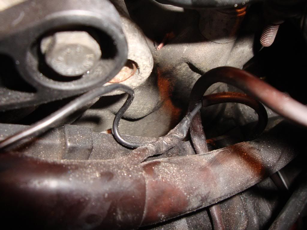

I knew it wasnt stock by the end connectors, My question was whats the Red wire with Green stripe for? Also where in the world does that ground go to down the front of the block, and what is the black wire trigger for?? WOW , all I can think of is a RON WHITE quote here that applys to the last owner " YOU CANT FIX STUPID"

I know what your saying, but why not connect all the stock stuff back with jumpers. You can always put it back. All that crap isn't stock and only you can tell where that non-stock black wire goes to in front of your block. Follow it and see, this will give a better clue on that Relay Jimmy Job is.

Could the PO have been trying to rewire the alternator or starter? Do you have electric fans?

As to that wire...if you can access the manuals, then you can look at the wiring diagram for that big connector, and start following lines from there.

Ugh. You should spend some quality time with a wiring diagram and get rid of that crap. Use some nice spilces with heat shrink...ahh. No electrical tape should be allowed anywhere near a Porsche.
Ground wires are brown from Porsche, not black.
