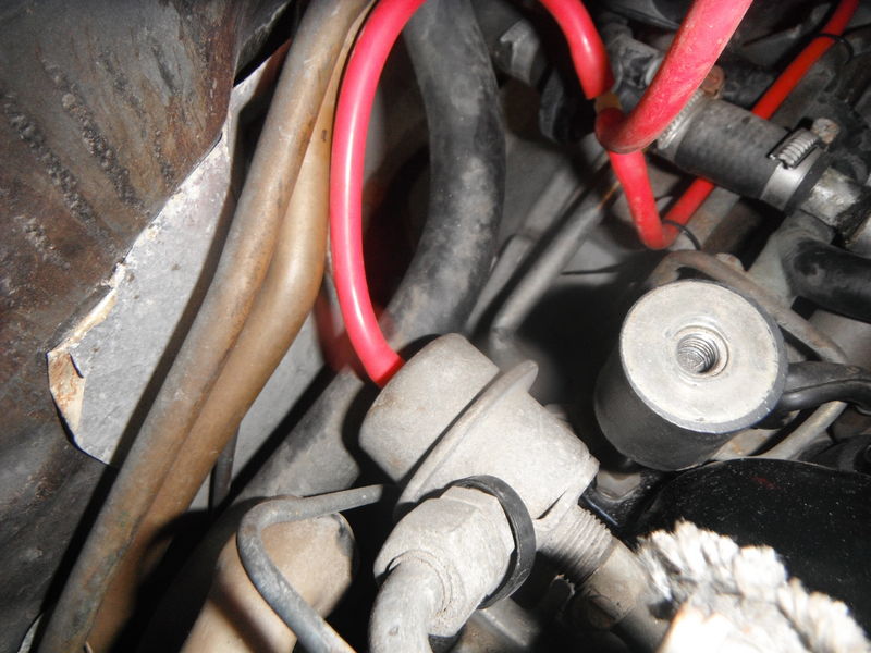

I just finished a little winter project i wanted to do, Have not been on here since I parked the car in December after it started snowing here in CT.
Had some parts powder coated, and put new in new silicone vac lines and manifold boots.
I replaced the vac lines one at a time, took one off, cut the new one to corresponding length but there is one line behind and under the intake box, I cant figure out where it goes..
Help?

To the air pump diverter maybe? Does it come from a V fitting on the head?

from a T fitting that is connected to 2 fuel pressure regulators.

SO i took the intake / filter box off. Seems to give me a better idea of what is going on .. I also found a diagram... I have the 2 lines coming from the pressure regulators, but the line splits, and I do not know where the goes....

according to the diagram it ends between the 2-3 intake tubes, but I am not seeing how. Maybe I hooked something else up wrong, but it seems to me, as I took each line off, i replaced one at a time to avoid this little issue.. going to be nice tomorrow, I wanna drive this hog!

If I read the diagram correctly, it look like the line you are holding (t'ed off between the two fuel pressure regulators - marked #5) goes to the front of the engine to the pressure damper - marked #3.
It looks like this goes through a 4 way 'T' that is between the decelerator valve - marked #15 and the throttle housing - marked #12.

I see the 4 way in the diagram, this makes sense now.. however I only had a 3 way. I cracked this 3 way changing my plugs before, and replaced it, upon doing this, I def noticed there were some lines which had been spliced, perhaps my lines were not hooked up correct initially.. so that pic from a functioning car would be awesome.

The lines from the fuel regulators go into the 3 way T. The line you have out then goes to a 4 way t under the intake runners. If you're looking at the 4 way from the front of the car the front one goes to the fuel dampner on the front of the engine. The rear one goes to the 3 way T where your vac line is. The one pointing to the passenger fender makes a u turn and then goes to a ddiaphragm on the base of the throttle body. The one pointing to the driver fender goes to a vac fitting coming out of the base of the throttle body on the driver side. In the second pic its where my finger is pointing. Hope this helps

Got it ! thanks, I had to get another T, I couldn't find a 3 way, so i just had to splice off and T twice.. much appreciated
