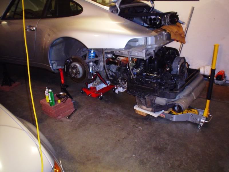

Hey BW, I finally had the courage to do the engine drop. You had inspired me to do it. This is also my first 964 engine drop.
Tonight, after coming home from work, I started unplugging electrical connections on the left side of the engine. I had to remove the blower assembly to gain access to the rear bracket holding the connectors and fittings.
Tomorrow I will work on the right side of the engine. Hopefully by Sunday, the engine is ready to come down for the clutch job, power steering reseal and oil pressure sensor reseal.

Hey BW, if you can do it with jack stands, why can't I with a Maxjax?
I measured the engine height from the bottom of heat exchanger to the top and it is approximately 28 inches. If you can get 32 inches from floor to bottom of bumper, maybe you don't have to take out the bumper with your ATV jack set up. I am using a furniture dolly and will just raise the car. Technically speaking, it is not an engine drop, it's raising the car with the engine resting on the dolly on the ground.
Yes I have amazon green coupe.
Hamptonsam, I just went ahead and got started not knowing if I will need special tools. Maybe not. The only challenge i see is the oil fitting in the rear passenger wheel well. Maybe I will need a crows foot wrench or just two big crescent wrenches depending how tight there are. Other than that, I think it will be just regular wrenching tools.
1993 964 C2 still makes me smile

Use a spare jack to support the transmission during the actual drop and put a piece of plywood on the ATV jack to help spread out the weight. The ATV jack will only go so far under the car while it's on jack stands because of the angle. Then when everything is dropped you can just roll it out of the way.

Hey BW, I have not done much after draining the power steering and undoing the lines. Been working late at work, already to tired to work on the P.
I don't think you have to drain the gas tank. Just undo the left side return and right side at the filter supply line and you should be okay.
List of things to do.
I already have the half shafts removed during the bearing change.
1. Remove the a/c compressor and move to the side quarter panel.
2. Undo the big oil filter oil line fitting on the pass side. DONE
3. Undo the transmission shifter DONE
4. Unwire the starter and ground to chassis
5. Undo the second oil line hose on pass side DONE
6. undo the accelerator cable (debating whether at the pedal or at the engine)
7. remove HE hoses DONE
8. remove the slave cylinder from the bell housing and move out of the way
9. remove sway bar DONE
I guess that's it and should be ready to drop by undoing the transmission mount then the two rear engine mounts.
