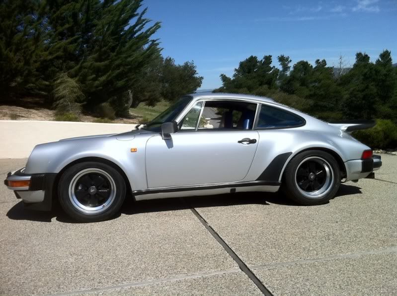

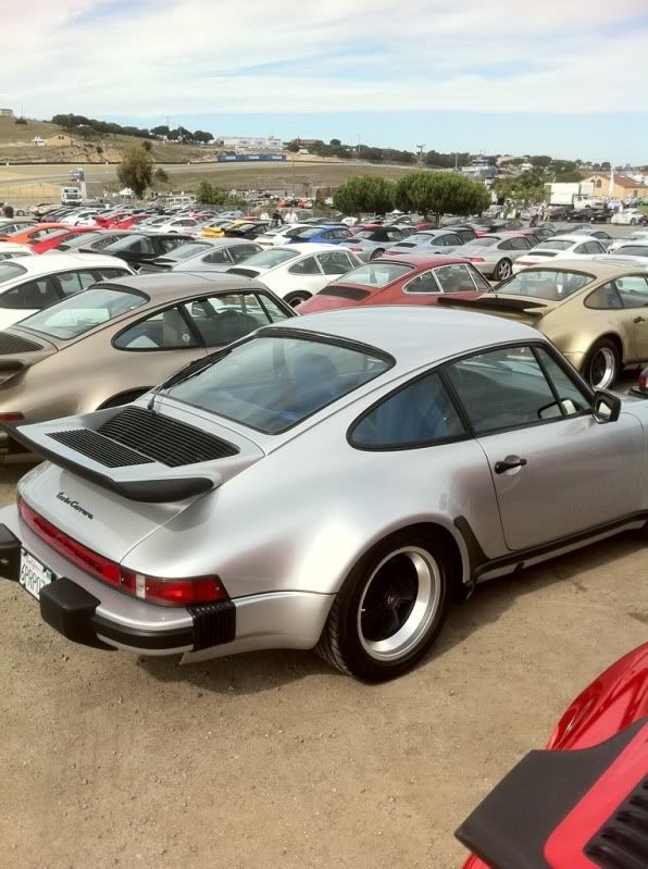

need honest value on my 77 930 turbo
I would like to get some honest opinions on what my 1977 930 is worth .Can't hurt my feelings.
This was a fun project. I am about done with. As you know you are never done with these toys. I got my eye on something else. No I am not a mechanic. You better be if your buy one of these old relics.
I am thinking $32k
at Rennsport
at rennsport
no service history,not original paint, so all the Germans STOP READING maybe just for parts
1977 930 turbo, USA model ,rare sunroof delete, AC, LSD, 90 K miles, been in California for a long time, unmodified,stock, lowered ride height, no rust, no major accidents.

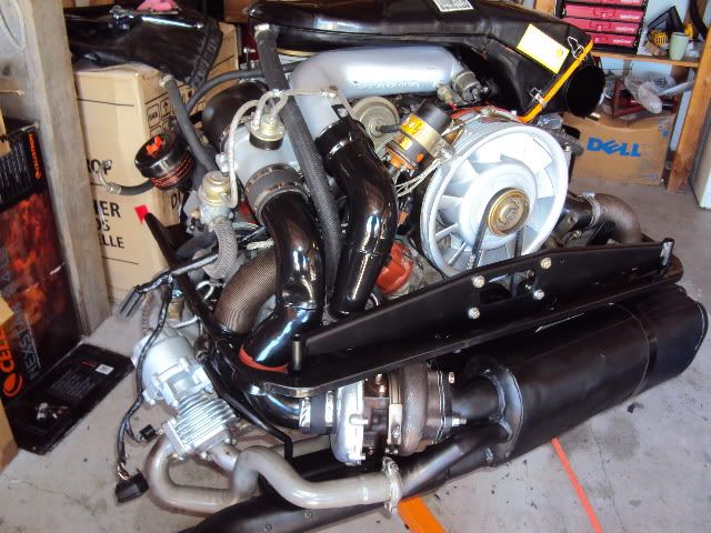

Original Blue leather leather interior, front dash and rear speaker shelf changed to regular black due to warping. I have color matched dye to change, leaks a little at front shifter seal, Engine has had Carrera tensioner upgrade, head studs have been changed at one time, engine pulled, almost all gaskets and seals replaced, had one intake valve sticking, head rebuilt, replaced one cam ,had rocker arms and shafts reconditioned. engine runs great now, Turbo kicks in nicely, 0.8 bar, Innovate LC1 to keep an eye on AFR's, No Major accidents, front drivers fender may have been replaced. Original Fuchs, New tires, nothing fancy, just original size. Car is as clean on the bottom as on the top. All gauges work, auto heat works. Car still needs a few things, alignment, bit off from when I changed the front Koni struts. Brakes though new need a little tweaking. Only driven it a few times, brakes get better each time i drive. pretty smooth on the hiway.alignment should be offa little from when I changed the front Koni struts but it goes down the road straight and no wobbling. Camber is probably off, but not noticiable.

Engine had great compression tests except for #6. The intake valve was not closing. Engine/transmission pulled. Oil tube in cam carrier was plugged. Hole is normally the size of a needle. This caused the valve to become stuck open due to lack of oil. One cam reground, 6 rocker arms, 6 rocker shafts refurbished, by Dougherty Cams.
#6 head rebuilt, by German Precision
Engine runs smooth, sounds good, no smoking from exhaust.
Runs cool
All engine tins, brackets, aluminum, steel parts bead blasted and painted.
If taken apart all new gaskets and seals installed
2 new oil return hoses from engine to thermostat
2 new oil return tubs
New starter
New battery
Carrera cam tensioner upgrade
Smog pump, tubes, in place, new check valve, new smog pump filter, passed California smog easily.
New thermo sensor, newer cold start valve
newer boost sensor
New oil pressure warning sensor
6 new fuel injector blocks
Fuel injectors cleaned
Turbo rebuilt.
Original exhaust, all professionally rewelded
W pipe headers, all gaskets new, thermo reactors gone, bad for motor
New Exhaust studs
Innovate LC1 wide band AFR gauge
New oil tank sender gasket
New spark plugs, rotor and cap.
New fuel filter
New fuel accumulator
New air filter
Engine detailed, while on engine stand
New Main oil lines from engine to thermostat.
New Silicone valve cover gaskets
New Diverter valve seal
New engine belts
Carrera front oil cooler added, new outer air seal gasket.
New heater duct hoses

Old 10-24-2011, 11:16 AM
Join Date: Sep 2002
Location: Johns Creek, GA
Posts: 1,445
seems reasonable @ $32k given the description. postive to me it's stock since the 76-77s build numbers are low. i have seen others asking not much lesss money that you are and the cars were not attractive.
Charles
88 911 Cab
74 TR6
88 CRX Si
79 930 #632 (sold her and survived her)
Old 10-26-2011, 06:05 AM
jr993's Avatar
Join Date: Aug 2010
Posts: 68

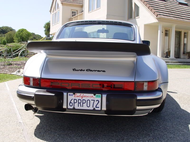

Very nice. "USA Model" with euro-sidemarkers? Seems like prices on these are stronger than they were 10 years ago.
Old 10-26-2011, 01:54 PM
dhg1337's Avatar
Join Date: May 2010
Location: California
Posts: 464
It is a USA model, per vin # Thats why I wrote one of the fenders may have been replaced. Need to add one on the other side. Can't be perfect, that going to cost more.
Can anyone ID what else is not correct on the outside.
Old 10-26-2011, 02:15 PM
Join Date: Jun 2004
Location: Oxford, Ct.
Posts: 2,301
If your car is as good as it appear it's worth 32 all day. I think the early Turbos (75-79) especially real clean stock ones, are going to be really strong going forward. If you've got time I'd ask 36 I think you'll get it
07 GT3 Cup S 4.0, 00 986, 78 911 old school gt car
77 BMW R100S
99 Ducati 996S
04 BMW R1150R
DanielJacobsLLC.com
Old 10-26-2011, 06:03 PM
Join Date: Nov 2006
Location: Naples Fla / Avalon NJ
Posts: 5,877
These cars are artwork. I agree $32 is reasonable.....
63 356 2.1 Rally Coupe
75 911M 2.7 MFI
86 Sports Purpose Carrera "O4"
19 991.2 S
25 992.1 GT3RS
Old 10-27-2011, 10:37 AM
Join Date: Sep 2002
Posts: 1,445
i agree. put it out ther for $36 and see what happens. more than liley you will get folks from EU calling. there are just not many 3.0s for sale.
Charles
88 911 Cab
74 TR6
88 CRX Si
