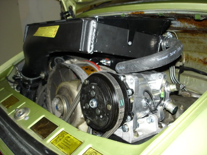

I am trying to get some good cold A/C in my 930. I put in a bigger I/C so I had to lose the stock york compressor.
This is a sanden 508 and it just barely fit.

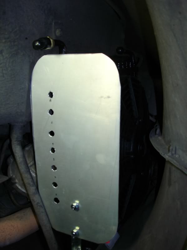

I also had to remove the rear condenser because of the intercooler. So I had to get some other ones. I put one with a fan behind the rear tire.

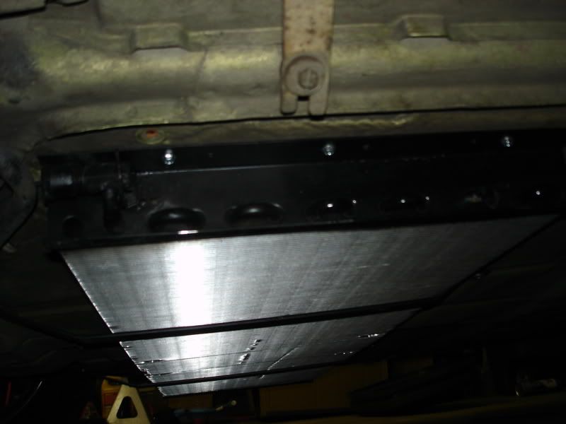

Then I got the big performance aire underbelly one as well.

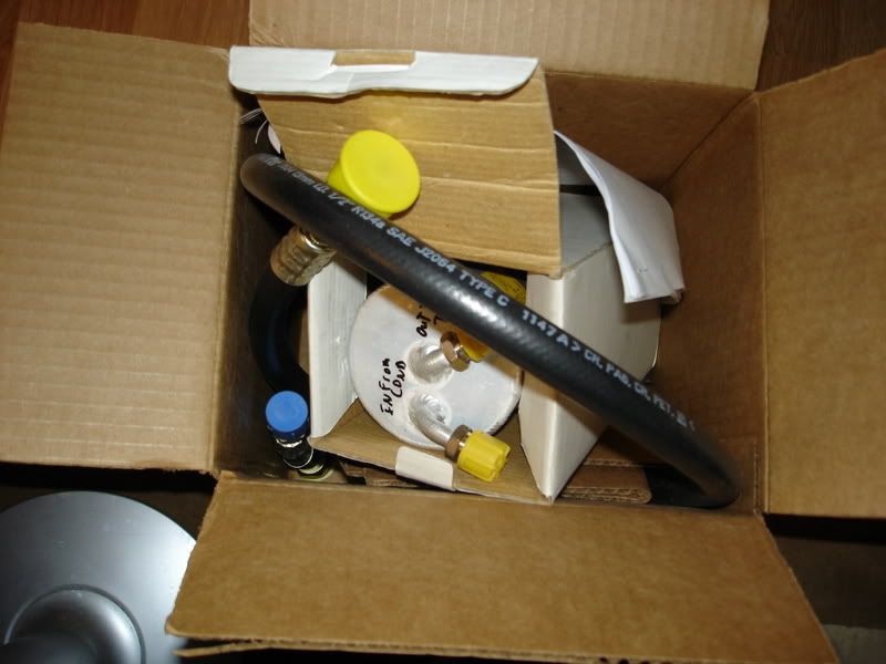

I also picked up a pro-cooler. I had originally wanted to make the Jim Sims subcooler but didn't have the time or skills to do so.
I haven't hooked this up because I hear it is suppose to be done last. I still have a few things to work out.

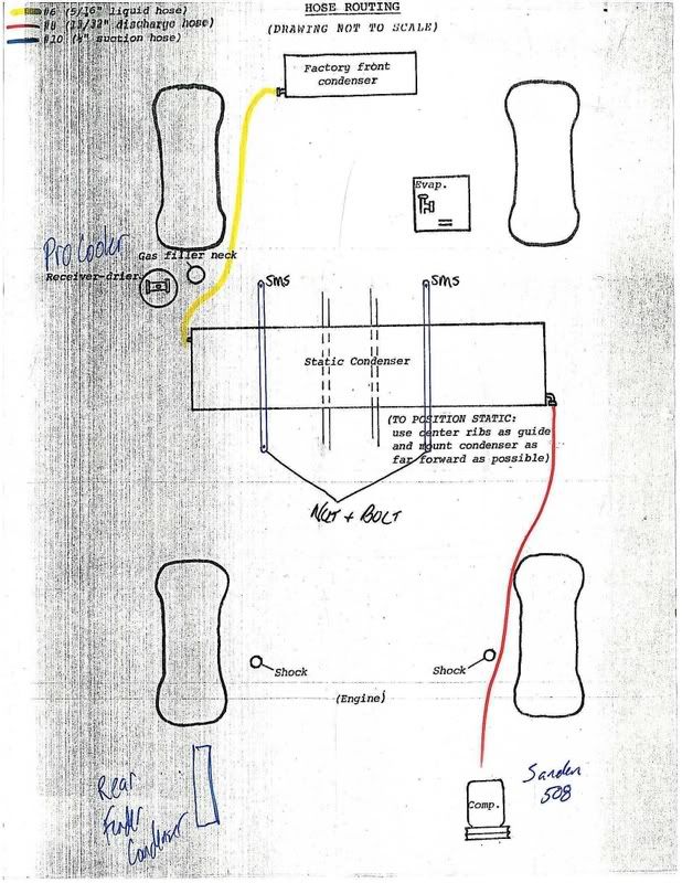

#2 I will have custom hoses made, but I am still not quite sure what order to route the lines. Can anyone help me with this diagram on how to pipe in the rear fender condenser?

The condensors are hooked up in series, so it seems to me you would want the high pressure discharge hose from the compressor to go to the LR fender condensor first and then on up to the big underbelly condensor, and then on to the front condensor.
Then the outlet of the front condensor would go to the inner wall receiver dryer portion of the procooler (top fittings) before going to the expansion valve inlet side of the evaporator.
The outlet hose connection (now low pressure/suction side) of the evaporator goes to the outer wall section of the pro cooler (side inlet connection) and the bottom connection of the pro cooler (outlet) goes to the large diameter suction hose that takes the refrigerant back to the low pressure or suction side of the compressor to start the cycle again.
The large suction hose is routed back to the compressor on the passenger side of the car origonally but with a pro cooler and hose kit from Rennaire it routes back to the rear of the car under the driver side rocker panel next to the thinner diameter high pressure line.
The large suction line then crosses over to the passenger side in front of the transaxle at the back of the floor pan and goes up to the motor compartment between the firewall bulkhead and shock tower cross member just ike the origonal suction line did.
Then again if you are having your own lines custom made you can have them made whatever length you want and route them wherever you want.

I noticed in your picture up the page that the sound pad is removed from your engine bay.
Mine is too and I didn't need to tie ropes or tie the lines together to feed them up through the corners of the rear bulkhead/firewall.
While lieing under the car I could see enough room up there for 3-4 hoses on each side without all the foam rubber crammed in there... I simply fed it up through there from the bottom, no drama, and then pulled them up the rest of the way from the engine compartment.
If all the rotted pieces of foam rubber are crammed in around the hoses still and the sound pad is in place then maybe you would need to tie the new hoses to the old ones and pull them up through.
Afterwards I stuffed some new foam rubber in around the hoses in the corners and a long strip between the bulkhead and shock tower cross member the whole length because thats a big air leak in relation to the engine fan and how much air it sucks through the intercooler and rear condensor, that is if you have a condensor in the tail.
