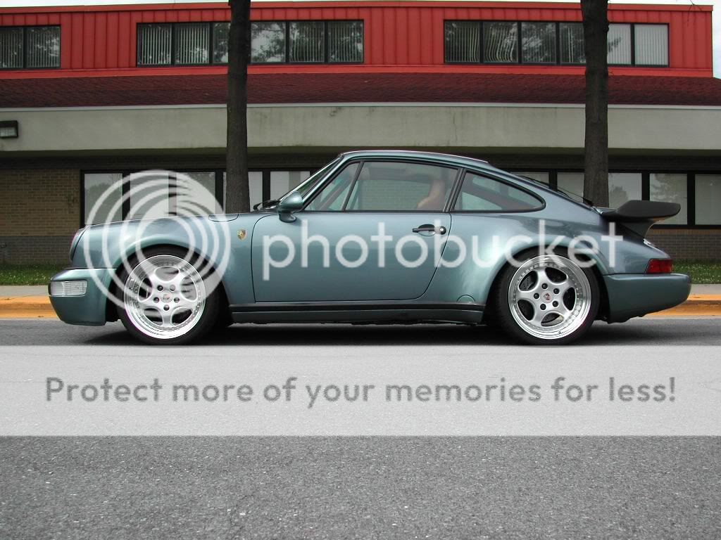

Here's my old 930

Here's my old 930
It seems that so many people sell these cars only to turn right around and buy another one. What is the story this time?

No story just stupidity for selling it. But its ok, if I get this one all is good
