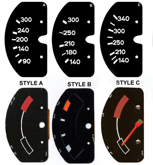

Neat option for real numbers on the oil temp gauge
Found these when I was looking into wiring up some of their gauges in another car. I've always wondered how hot "8:00" and "9:00" were...

Given that 210 is in three different positions on the three faces, how do you decide which one is correct for the real number?

If you look along the edge of the original gage overlay you can see the temps written in °C. A small flashlight and a bent neck and you can see them on your mounted gage.

Good to know, now that you mention it I can see it in the above comparison photo.
