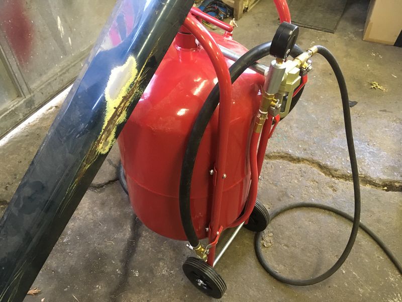

got a big pressurized blaster but need to decide and get the media.
started thinking soda, but read about the residue issue affecting paint adhesion. just tried a little shot of walnut shells. worked great, but need to read some more to determine if they also cause paint adhesion issues. found the most recommendations were for plastic bead, but a bit expensive. drag it out to our side lot and if I use plastic lay down a large area of tarps to capture as much as I can. if I go walnut shells, will just let it go into the gravel...
soon ..... very soon ......
test was just a few seconds at 90psi. encouraging.

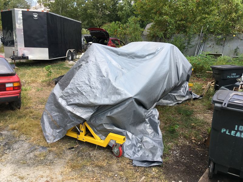

plan to start blasting with walnut shells today. and keep covered when not working on it. I expect this to take a few days....

after some false starts trying to figure out what works, starting to make progress.
got some stripper, turns out the 'good stuff' is being recalled, but found some. when applying the stripper, wiped off after setting for a bit, then tried blasting with walnut shells. initially got the course stuff that clogged in the blast gun. then got the fine stuff and it worked better, but still tended to clog occasionally. finally resorted to 80 grit glass bead.
the stripper takes the paint off right now. but the underlying primer is tough. even after spraying with stripper it fights you.
so I am now leaning toward just going to fine sand. but still use stripper first. next effort will be using just stripper on the roof, see how much I can get off that way. then I will not have to hit the car hard with the sand, just blast over it lightly to finish off what the stripper did not get.
will strip the exterior body but not sure how hard I will work on the interior / engine bay / trunk / etc. areas. may just sand blast lightly to make sure anything loose comes off. talked to the painter and he said not to worry too much about those areas. once clean and all loose stuff gone, clean and paint.
but FINALLY we are getting some much needed rain, so will be a couple days before I get back to it. in part my 41st anniversary is Monday, so spend the day with the wife and take her out for a nice dinner.
to be continued .......
