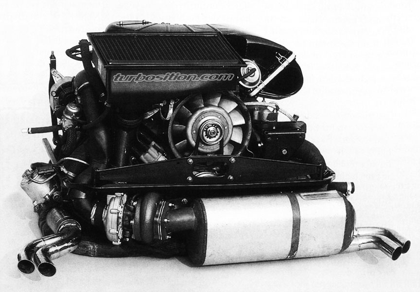

First time posting,hope my pictures upload. I have had my 1983 ROW 930 since 2005. It has a 930/66 engine #67D0551 with a TURBOCHARGER CODE= 53279707006. FAMILY K27-3. The intercooler does not look like others I have seen. My airbox also has a notch in it. I will try to load pictures. Could this be a 930S motor? Any easy way to know if I have SC cams? It appears factory. Thanks, jeff

I've seen that one before. It's made buy the same company that makes the smaller original one on regular 930's. Maybe it came on a 930S or a special wishes car or something like that.
I think it uses the same core as the old RUF intercooler.
It's probably worth a bunch to someone that wants it.

Looks like a 930S

Just to compare to the old RUF (without the fins) notice the cut away airbox:

Wow, you have the 930S engine. The larger intercooler and the diverter valve next to it gives it away. Do you have the four pipe stainless steel exhaust. If you do the pair on the left side should come from the wastgate.

Check out this site.
http://www.turbosition.com/_files/images/exclusive/Porsche_Motor_930-66-S_SOW020.jpg

Edwin, More pictures. My exhaust is on the left as well as the wastegate dump pipe. You can see where the parking light was previously mounted. This was the sticker in the engine compartment right siide . AMG apparently brought it in. They cannot tell me anything about it. Could be they changed the exhaust at that time? Steering wheel is different also. I guess I'll try that C.O.A. thing and maybe find out something.
I need to address a severe shuddering when you first release the clutch in first gear ( rubber centered clutch, engine/trans mounts, omega spring?) With engine out I can learn more , identify cams, and add this incredibly great exhaust that this really nice guy from Alabama sold me a embarrissingly long time ago. Jeff

The compliance tag is '93 and for a 3.0l engine? Not that it matters much in NC I doubt you smog and there could be a typo on the engine size....however
1993 compliance on an '83 gray market car you could have anything in your engine today.

I believe is it properly referred to as a 930SE
And yes, that is a very special collection of parts. Look like a RUF aftermarket exhaust though.
That intercooler, the "SC grind" cams and the K27 made up the SE package. I am not completely sure, but they may have also put a stiffer boost spring in the waste gate also.
