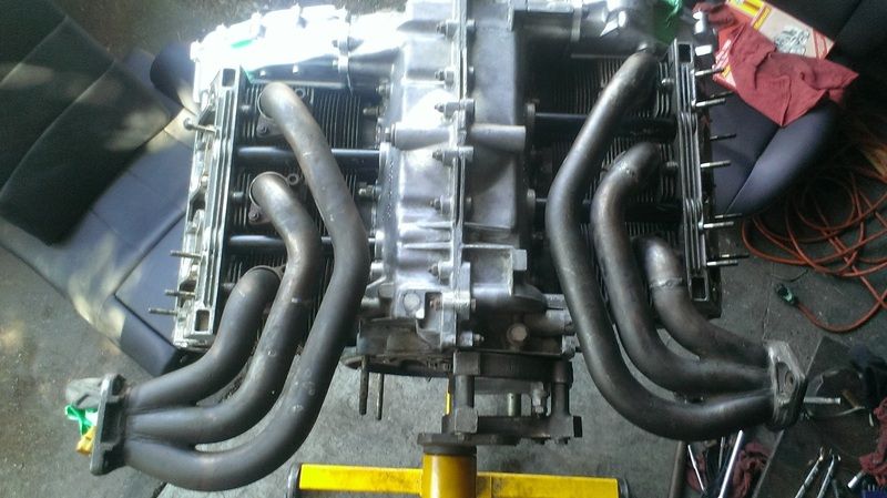

This is a while back, I removed the tin off the carrera manifold and flipped one out, to get a nicer look and then I planned to bring them back individually. Yes one flange is upside down this way, thought about flipping it also but it doesnt bother me much honestly.
So from here I can stay seperate per side and do twin easily ,
