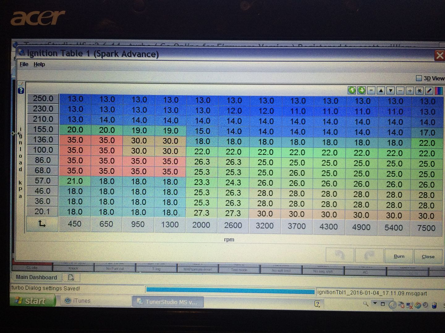

I am going to be running E85 most of the time, and started the transition today, just hoping that Microsquirt automatically compensates for the change in the Gasoline/ethanol mixture like it is supposed to.
I copied someones timing table to get me started. Does anyone have a timing table from a 9.5:1 compression car that i could look over to make sure i am in the right ballpark?
Also, was planning to keep it at at .60 Bar, am i running safe here with 9.5:1 compression?

Just hoping someone could critique my ignition table. I wanted to be a little conservative under boost. Am i too conservative?
Old 01-04-2016, 01:12 PM
Chain fence eating turbo
Join Date: Dec 2008
Location: Austin, TX
Posts: 9,141
I'd say you are very conservative.
But, one thing that jumps out to me is your low RPM high load cells. 35° is way too high.
In the 450 RPM/100kPa cell, I'd put 0°.
This is the cell where the engine is starting in. It'll help the starter to spin the motor and reduce kickback.
Once it fires off, the timing jumps up due to vacuum to help keep it running.
What Sal pointed out, too high of timing at low RPM makes for a situation where the piston is literally being pushed backwards, making for difficult running.
