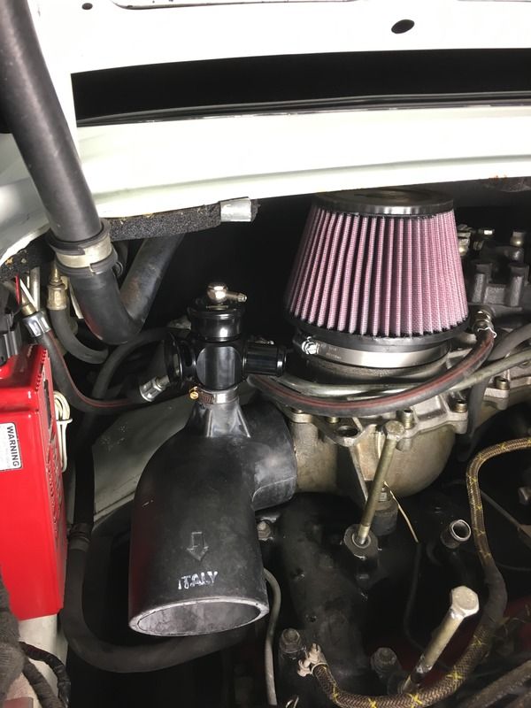

I think i would make it myself Havent recived the new ic, and i dont have my car here with me.
Do you guys have the dimension of the throttlebody without the old system and also the dimension on both the inlet and outlet on the Intercooler? The area with o-rings. Tried to find the dimension of the o-rings but i cant find it.
And also the dimension of the threads on the boost switch if any of you guys know it
Thanks!

You can leave your original cast magnesium intermediate manifold/blow off recirculation manifold in place and just disable it by removing the long spring inside behind the piston and replace it with a piece of PVC pipe to keep it shut.
A piece of broom handle or electrical conduit would work too.
Might be a good idea to replace the two seals under the two cast aluminum end pieces if they are dry rotted. After 20+ years they probably will be.
Doing that will let you keep and use the short neck intercooler you have.
For the black rubber factory elbow hose with the 1" diameter 964 turbo recirculation valve fitting on top you can get it cheaper from some Porsche dealers than anywhere else.. and somebody posted they have one to sell above.

You still have the problem of that housing's volume, and that air leaks around the factory piston even if you replace the end plate seals.
Buy a damaged factory boost recirc housing and and modify it, or convert your own IC to longneck, or purchase a finished bolt-on package.

I have now changed out my old IC with a Andial IC, and also changed out the blow of valve to a new type. Tried to put the vacum line on the same hose as the decel valve, but it doesn`t seems to work good. Where have you taken vacum for the bov?
I am also thinking about removing the decel valve since i have very high idle when the car is warm, and i have read that the decel valve could be the problem? Will there be a different problems than more crackle and popping in the exhaust?
Thanks!
