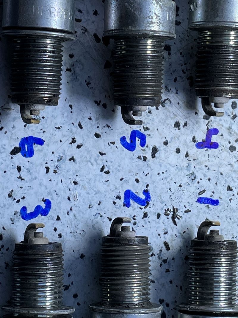

In case a picture of the plugs give any additional clues.

Posts: 3,346
Sounds to me like a normal good running engine. Nothing to fix.

Those plugs look consistent and pretty darn good. I concur with the "just drive it" group.
