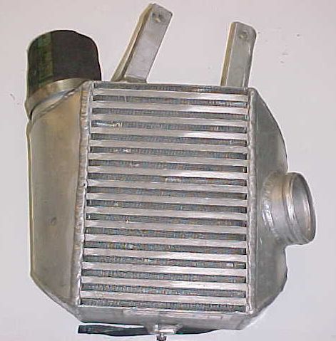

Continuing the mid-engine turbo theme, this is a 2.5 liter short stroke engine I built for a club racer back in the late 80s. The case was an aluminum 2.0 with stock crank, 90mm RS pistons/cylinders and Carrillo rods. It used 2.7 heads and a custom built 930 CIS with fan cooled inter-cooler.
It made 345 on street gas with 1.0 bar of boost.
Henry Schmidt
