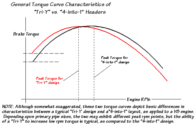

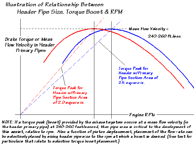

you would need at least displacement and rpm to make an educated estimate
but here the theoretical max n/a flow per side vs rpm @100% VE
and some other pertinent info
ti Ys are common 4 and 8s and inline 6s but hard to package on a 911, though it can be done

The basic idea of sizing is to balance two things, flow velocity and pressure build up.
Essentially you want as high a non turbulent or laminar flow as possible, but bends merges changes in cross section also affect this
then there is the other aspect, acoustic tuning, A properly designed set of headers can generate a nice strong rarefaction signal at the exhaust valve at TDC compression, w/ the right cams this vacuum signal sucks additional mixture into the combustion chamber yielding extra torque & hp.
The strength of the rarefaction signal is proportional to the change in cross section area of the pipes, there can be be more than one signal if here is more than one change in cross-section area, the bigger the cross-section delta the stronger the signal, to get the best result the collector must be open to atmosphere or to a set of tapering megaphones which add additional tailoring to the signal depending on their geometry. W/ a muffled system most of this acoustic tuning component is lost due to the reduced cross-section area of the transitions from pipe to muffler, the distance from the cross-section delta times the delivery of the rarefaction, hence the concern about pipe length.
unfortunately what works great at low rpm falls on it's face at high rpm and vice versa.
similarly using too small on a big engine works great at low rpm not so much at high rpm
