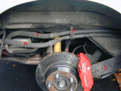

Oil lines with SSIs
Could someone post a picture showing the location of the oil lines on a 3.0 SC engine being updated (downdated) with new SSI heat exchangers. I am about to mount the exchangers and it looks like it might be easier to install one of the oil lines now rather than later. I know I can figure it out with the engine installed but I am hoping a picture will save some time later. Thanks

The line that mounts to the engine needs to be installed prior to the SSIs. The tab on the line attachs near the oil cooler. This photo shows a small portion of the lines location.

Follow the picture above closely and you will see how it differs from the line you have now.
Yes you need a need line with SSI.

Just what I needed. Thanks.

A pic from below
and the wheel well area
