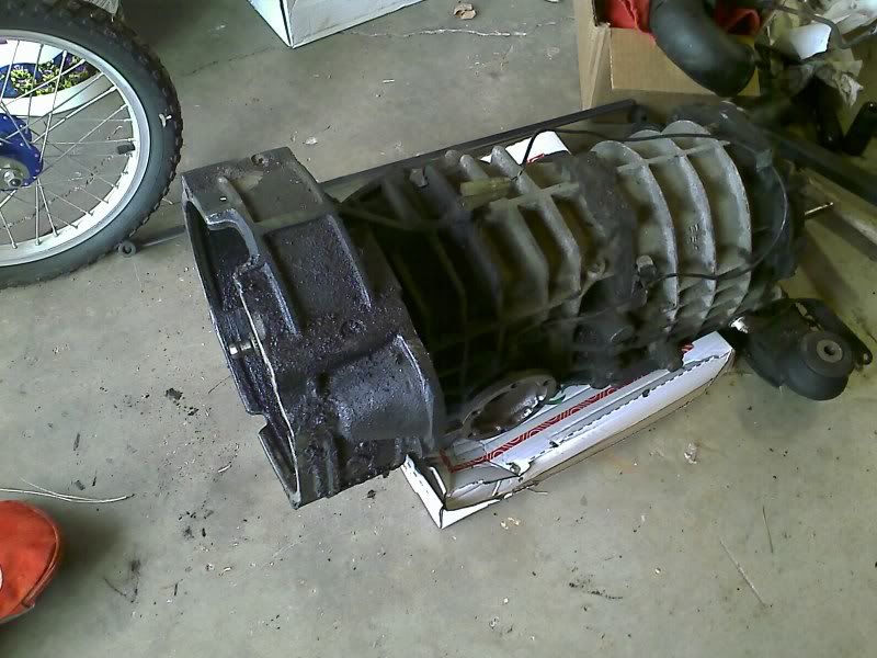

Split the case today, such a shame...
.....that I have to go into this engine. Due to my mis-shift and bent valve issue, I'm rebuilding my130,000 mile engine. I split the case today, and to me, the main bearings and crank looked great. In fact, the only visible sign of wear was the layshaft bearing. Oh well, it'll be "better than new" when done.

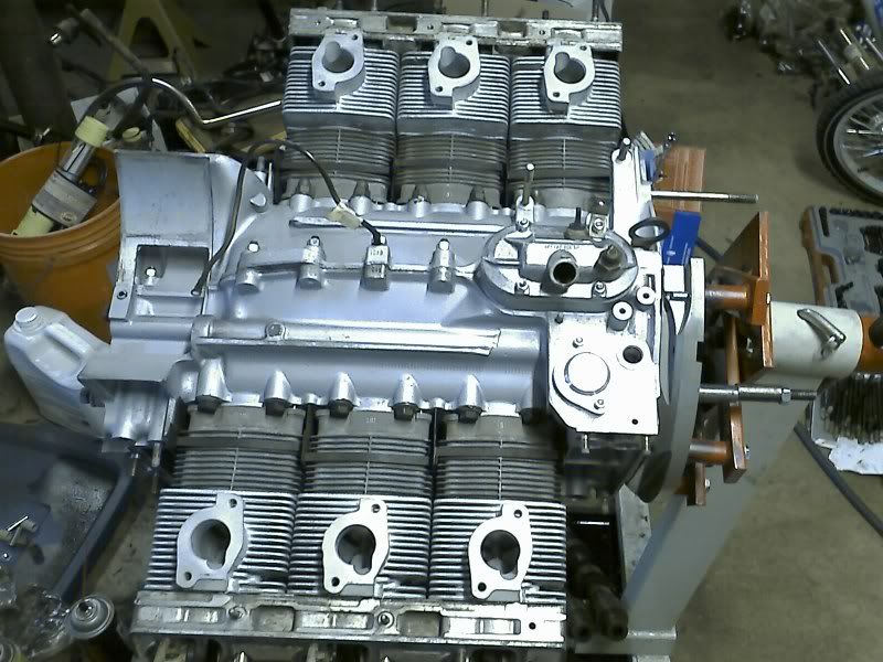

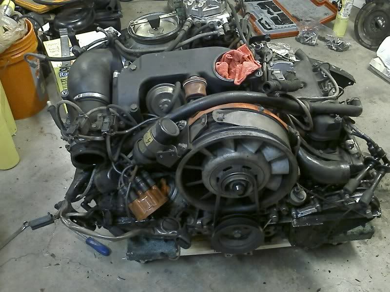

The bearings in my 87 930 looked very similar @ 20yrs old and apparently over 150K miles.....
I was totally amazed. I was almost a shame to do all of this work for 1 cylinder leaking 20% thru the exhaust (the motor had never been apart) and some oil leaks, but I 'should' be set for 20 more years once it's back together.
This was the dirtiest motor I've ever owned - it was basically embarassing - the PO must have ignored leaking oil for many years....

kellcat: That thing was dirty, but the case looks sparkling in the after pics. What did you do to the exterior?
After I get the crank and heads stripped down, I'll be into it for some cleaning prior to machining. Then, when they come back, more of the same.
