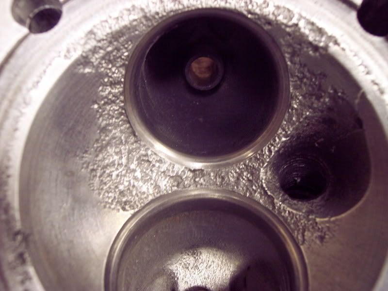

Hey Dave: I have a 2.7 head you can have for your collection on how not to time an engine!

Damn Craig! I'd add that to my 3.0 head with the screw loose...no really, a sheetmetal screw was loose in the combustion chamber.
So that's what it looks like after really, really bad detonation? Or was that mechanical...

Its real bad bad detonation! Have you re-checked the valve adjustment since the rebuild? We have several thousand miles on ours now and many hard track weekends and have never touched them yet but that was with an original set of cams. Were you running new cams?
