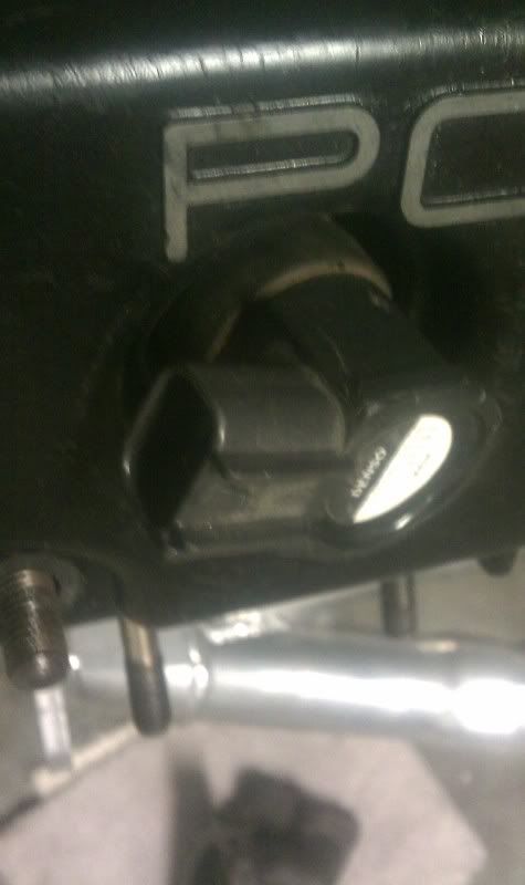

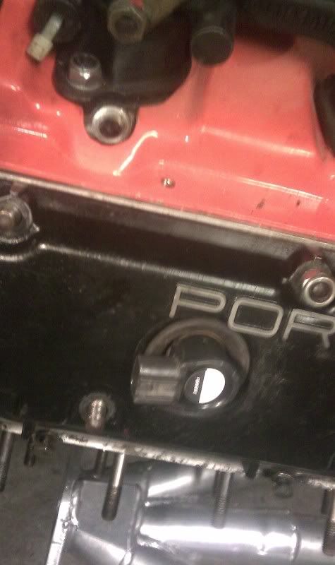

I did a test fit last night to check how well the Kawasaki (Denso) coils fit our engines. Net-net...amazingly well. :cool:
Length: Very good; comparable to Beru plug leads.
Fit: You have to unscrew the spark plug terminals to expose the threaded ends on the plugs for these to attach. The coils, as a result, grab on tight and don't let go. I don't foresee these things letting go.
Plug hole size: The coils are quite a bit wider than the stock plug wire leads, but are still small enough to accept the Beru rubber surrounds. :D
Summary: These things fit great, hold great and look damned close to stock when using the rubber plug surrounds. I do not see any issue with these, in terms of fitment. If you are worried, it would be easy fabricate a bent sheet metal piece, attached to the closest head cover nut as extra insurance on the bottom plugs.
I say use them! Here are some crappy camera pics to illustrate.
Without rubber surround:
http://i25.photobucket.com/albums/c7...n/IMAG0209.jpg
http://i25.photobucket.com/albums/c7...n/IMAG0207.jpg
With rubber surround:
http://i25.photobucket.com/albums/c7...n/IMAG0210.jpg
http://i25.photobucket.com/albums/c7...n/IMAG0211.jpg

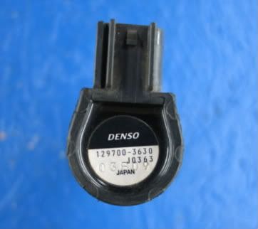

For reference, the ones I tested with are the newer Kawasaki ZX9/ZX12 coils. There seem to be several variants between the different bikes - the earliest ZX6 coils look a bit longer, so I'd avoid them as I think these fit awesome. Here are some reference shots of the Denso part number and side profile:
http://i25.photobucket.com/albums/c7...Denso_Part.jpghttp://i25.photobucket.com/albums/c7...Denso_side.jpg
