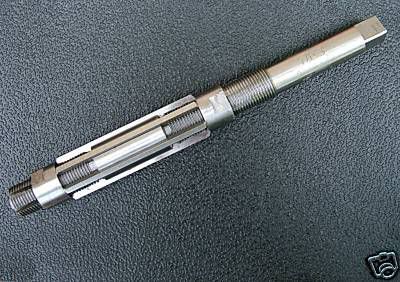

Old 02-27-2009, 05:34 AM
idc1873
coxy's Avatar
Join Date: Jan 2006
Location: wigan lancashire
Posts: 59
Not a hard job, one of these "Adjustable Hand Reamer" can get the job done
