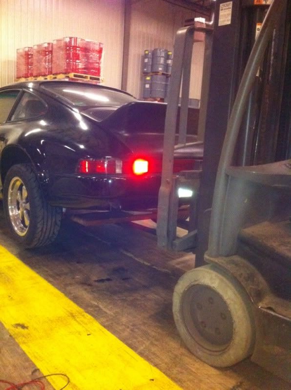

I've seen that forklift is a great body straightening "bench" too........
Indeed, who needs a Celette when you have a Crown!

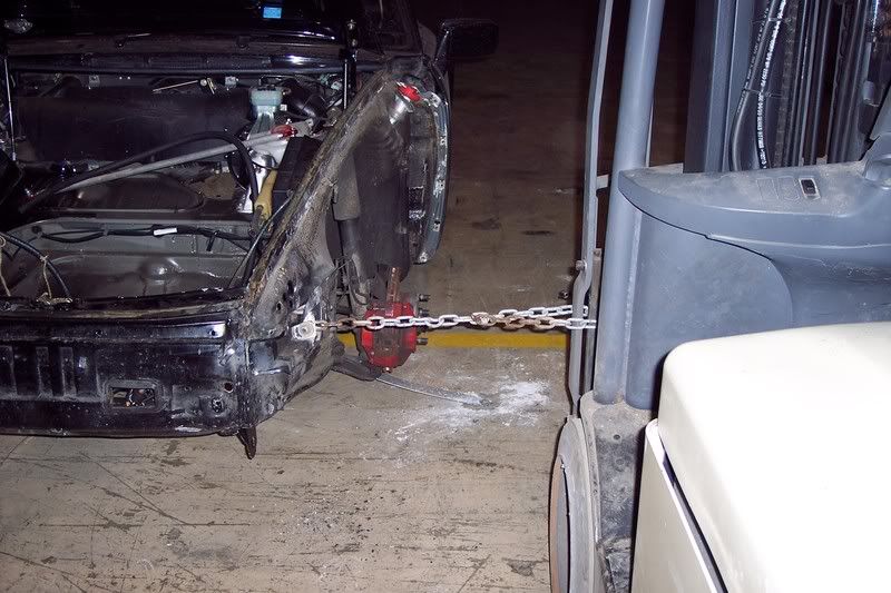

LOL this car was balled up at Watkins Glen, and was third in class in Le Mans in 2003...
we used creative lift anchoring and stretching etc. To pull the tub straight..restored it to factory specs
