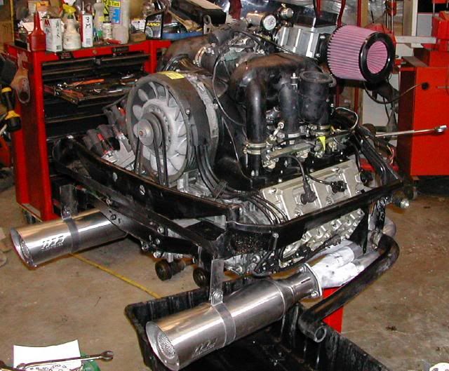

You can call me for pricing and further information, but if you are using stock or RS cams, porting your heads will not make a big difference, commensurate to cost. We don't use titanium valve springs as I think thats a poor choice of material for that application. We do use Ti retainers since the OEM sintered metal ones do fracture from time to time with catastrophic results.
I will tell you that your exhaust, as pictured, will cost you a lot of torque & HP with an engine in that configuration.
Steve Weiner

Advice on to port or not
Hi, Steve:
Thank-you for your reply.
Oh that engine is from the Timmins website.
I was just curious what the going rate was to add RS valves to the heads.
Is it even worth to add lumpy cams and larger valves to a stock 95 3.6?
Oop's yeah I meant titanium retainers.
Thank's in advance.
