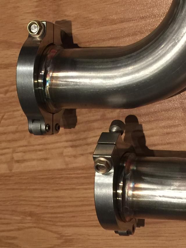

  • The wastegate pipes are also welded onto the V-band flanges for the Tials; again, a temporary measure to enable exhaust ducting in the dyno cell to be fixed onto them, they'll need reworking once the engine's back in, bumper on, etc.
    http://img.photobucket.com/albums/v2...0E78C018A6.jpg
    http://img.photobucket.com/albums/v2...9038A92644.jpg

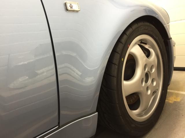

  • The new tyres are on the Cup1's, and now mounted onto the car after a couple of coats of wheel wax application. Easier to do it now rather than clean off brake dust later. They don't fill the arches quite so well, but are lighter (ca.4kgs/rim on the fronts, about 1kg on the rears) and I have to say, glad I've now got what Porsche designed the suspension with. Reduction in unsprung mass is a great thing, and the slightly narrower track at the front should help us dial in the chassis setup as I want it.
    http://img.photobucket.com/albums/v2...BB29F3FF3A.jpg
    http://img.photobucket.com/albums/v2...2C93892FBB.jpg
    http://img.photobucket.com/albums/v2...904CDC13C8.jpg

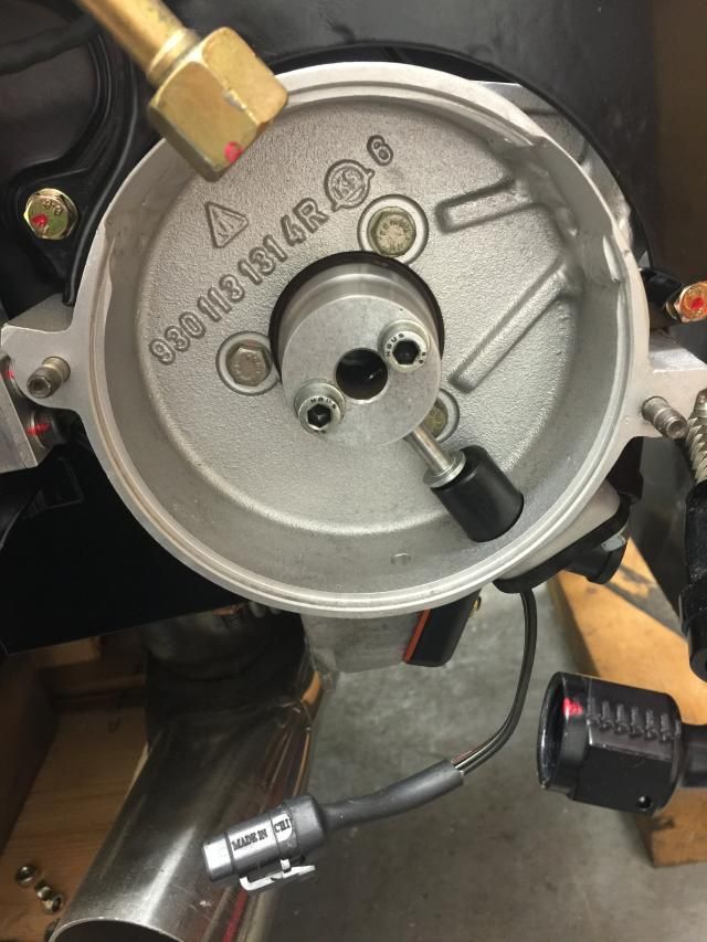

Whilst doing a bit more homework for the dyno session, and measuring the rotational angles between the 60-2 toothed FW and the crank sensor, I also needed to take some pics (and measure) the position of the cam sensor vs the pickup, all whilst #1 is a TDC on the compression stroke.
The position is configurable in the MBE, that's no problem, but the one place you really don't want the pickup to be @TDC is right over the sensor.....
.....no prizes for guessing where mine was.....
God know's how I managed to do this; the position of the sensor boss was something I chose a couple of years ago, got it fabricated, etc....the pickup I drilled/tapped into the boss of what was the smog pump drive pulley, and I can see why I mounted it where I did, it's right in-between the two drive lugs for the oil pump....logical enough...but by happenstance (I think) the sensor is exactly in the wrong place. Leaving it like this, it can present an indeterminate position.
http://img.photobucket.com/albums/v2...C4D993C24D.jpg
Good job we checked now. So, time to re-engineer it.
I could've drilled and tapped another M8 hole at a 45˚ offset, but in hindsight M8 is way too big.
Time to make a new boss......
http://img.photobucket.com/albums/v2...9BA6D105_1.jpg
http://img.photobucket.com/albums/v2...B430752B_1.jpg
This time, knowing that if we do need to move it whilst on the dyno, I've pre-emptively drilled and tapped 6 holes to give us complete flexibility. Of course, only really needed 3 holes, as the boss itself can be rotated 180˚....but by drilling the other 3, it looks symmetrical and is probably balanced better.
Also made a new pickup that has squared off leading and trailing edges...again, no idea why I made the last one from a machined down cap-head with round pickup. New position with #1 @ TDC/compression....
http://img.photobucket.com/albums/v2...8C6C4EE919.jpg
Something else I checked was the position of the drive pin for the pump in relation to the capheads that drive it; it *probably* would've been ok, but it was a tad borderline with the pin only just engaging deep enough between the heads. So, a couple of 1.5mm ally spacers now sit under the bolts that hold the boss onto the end of the cam.
Can't believe that this has taken the best part of the day to re-do. Oh well, will try and modify the chassis lifting plates first-thing tomorrow (see one of the early pages; the Pelican supplied plates that come with the engine lifting bar, I presume are for earlier chassis than the 964; they're far too small to bolt onto the chassis' engine mountings). Dad's then coming over to assist with the installation of the engine/box....hoping to show a few pics of the engine sitting in place, and the car looking a little less 4x4, for a short while at least.

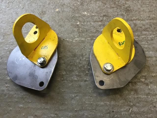

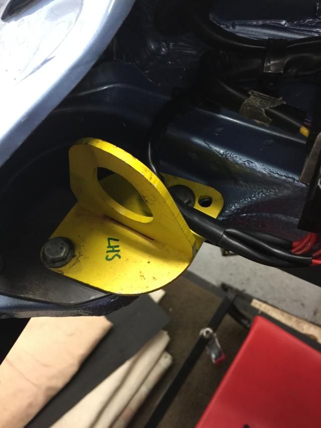

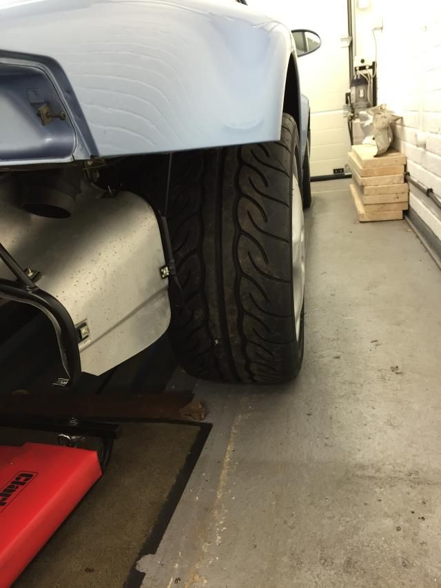

Bright and early start to make the chassis lifting plates, mentioned yesterday. Some lovely weather this morning meant it was time to any the neighbours with the angle grinder, and after an hour or so, got them made --->
http://img.photobucket.com/albums/v2...1EDA354298.jpg
http://img.photobucket.com/albums/v2...0939DC93E1.jpg

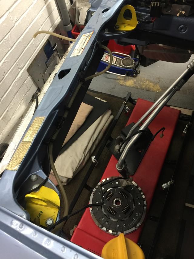

The asymmetric design of the slam panel on the 964 (is this the same as the early chassis?) means that the LH eye is completely inaccessible if mounted on the rear-most bolt hole. Ridiculous. So, some re-drilling and re-positioning of the yellow plate onto the new base plate has got it a bit better, but certainly wouldn't start hoisting the car without packing the slam panel well with some rubber matting, the chains and hook are far too close.
http://img.photobucket.com/albums/v2...72D2C4ADF6.jpg
http://img.photobucket.com/albums/v2...952801985B.jpg
The RHS is fine....
http://img.photobucket.com/albums/v2...30EBCB6E93.jpg

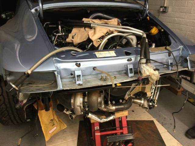

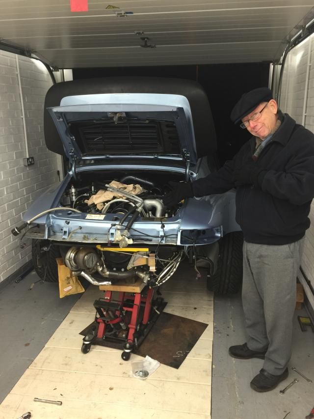

Then it was time to give my Dad a call and for us to get cracking with the dry-run installation. A good opportunity to practice the procedure, and had a great afternoon together, on the same wavelength and making steady and careful progress.
Car rolled halfway out in readiness....
http://img.photobucket.com/albums/v2...33336EA54E.jpg
The engine and gearbox all bolted up and ready to manoeuvre.....
http://img.photobucket.com/albums/v2...433BB84889.jpg
...and, er, Dad getting ready to move the unit ("no, not that bit Dad..."). Actually...this pic looks a bit strange now.... :eek:
http://img.photobucket.com/albums/v2...CE27F06A94.jpg
Fear not, the engine was chocked from underneath, it wasn't about to fall off the ATV jack.
Slowly but surely....
http://img.photobucket.com/albums/v2...42495C19FD.jpg
Gradual lowering of the chassis, and raising of the ATV jack, literally millimetres at a time...check, double check, lower, check again. A bit like patting your head and rubbing your stomach, checking 4/5/6 things at once to ensure no cock-ups.
http://img.photobucket.com/albums/v2...A3713C068F.jpg
And once the gearbox mount is bolted, it was a little easier knowing that dimension had been taken care of, time to just square it up, raise a bit more and....
http://img.photobucket.com/albums/v2...30CDF5653D.jpg
Dad looking very pleased with progress. Actually, think he was more pleased with the fact I hadn't subjected him to a barrage of ill-tempered swearing and spanner throwing!
http://img.photobucket.com/albums/v2...3B74C1D4F6.jpg

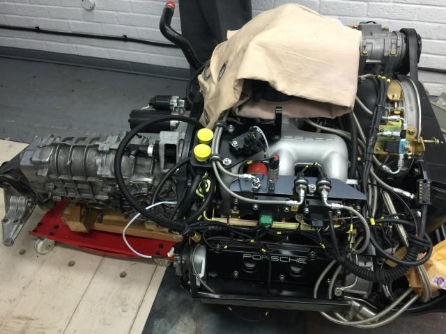

Spenny_b 02-22-2015 02:51 PM
Then time to find that box of engine mounts I bought over 3yrs ago from Gert at Carnewal ...very nice guy, and a day-trip that Dad and I went on, over to Belgium for a car parts shopping spree.
A set of genuine 964RS engine mounts, and amazing how much lighter they are versus the stock items. These with the firmer G50 gearbox tail mount from Chris @ TurboKraft plus the Golden Rod shift linkage, should tighten everything up very nicely.
Anyway, the mounts seem to work a treat, easy to line up..unremarkable in that respect.
http://img.photobucket.com/albums/v2...D81559FFAE.jpg
....and she's in....
http://img.photobucket.com/albums/v2...57142B2F27.jpg
And now I have something resembling what I remember my car looking like, rather than some horrendous monster truck thing....
http://img.photobucket.com/albums/v2...D6A85C87_2.jpg
Can't tell you how chuffed I am. Has the engine got to come back out? Yes, of course it has, but it was only 4hrs of work to put it in this afternoon, and that was with tea break, and some stopping and re-remembering the procedure, then having to remove the AC pump (to clear the slam panel) and starter motor (to clear the RH driveshaft). Getting it back out won't be a big job, there's not going to be any oil filling, just purely an opportunity to check everything but also, now I have a few weeks spare, I can look at fabricating the air intake tract to the turbo. And by God it looks bloody tight, so definitely not something you can do unless the engine's in.
Now...I may just be tempted to go back outside this evening and try fitting the intercooler....well, it'd be rude not to, eh?...

preston_brown 02-23-2015 06:26 AM
Nope, the earlier chassis didn't look like that. They looked like this:
http://forums.pelicanparts.com/uploa...1424701596.jpg
Symmetrical.
Spenny_b 02-23-2015 12:16 PM
Symmetrical.
Thanks Preston, yes, I can see now how they'd work far better. I did feedback to Pelican after I bought it 3yrs ago that the lifting bar is of limited use with the 964; no idea whether they've now changed the item description.
