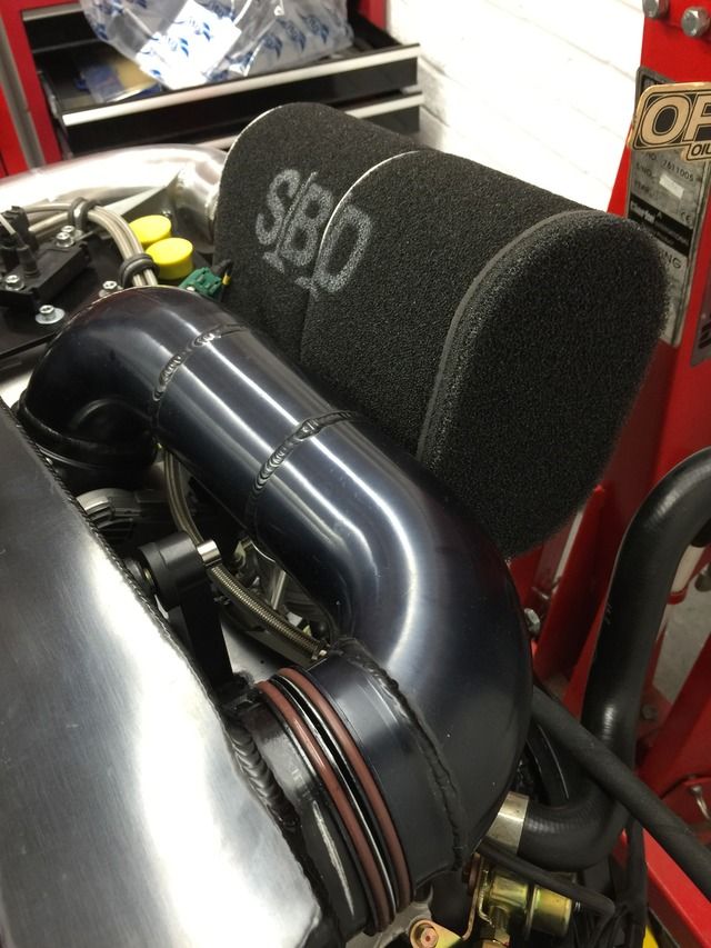

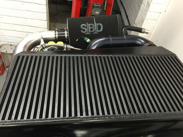

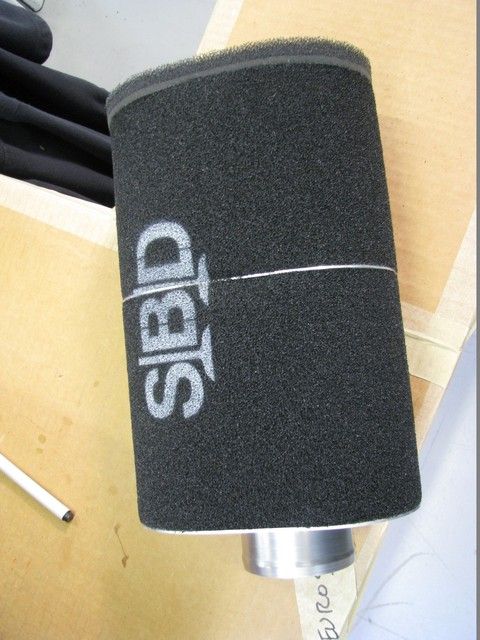

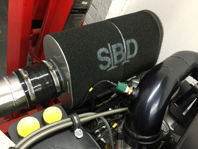

The new air filter is complete!
Andy and the guys at ITG have done a great job for me, he sent me the following pics earlier this morning. It's now winging it's way to me on an overnight delivery, in readiness for Monday.
The calculations that Andy made for this filter are that with this grade foam (their finer grade option), with the internal dimensions we've got, it will support 611bhp for a N/A engine. Andy then generally adds 10% for turbocharged applications, raising it to "a very conservative" 670hp. In reality, he anticipates that so long as the 3" pipework doesn't become the bottleneck, then it may well be able to flow well enough for an 800hp application (!!).
....hope I got my measurements correct!...

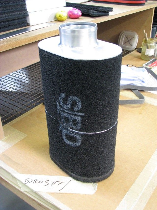

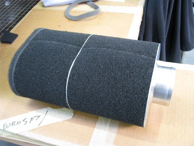

Spenny_b 04-11-2015 10:40 AM

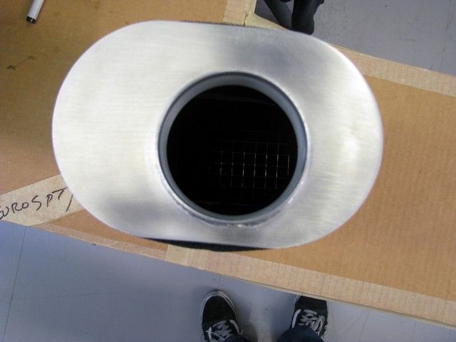

Filter arrived this morning, and thankfully it fits like a glove!! Obviously, am hoping the fit is equally as good with the engine back in the car, but the positioning of the 76mm outlet is spot-on to my scruffy template, and it misses the BOV perfectly.
The aluminium plate halfway down the filter is only the same thickness as the foam depth, and is there to prevent any deformation under full "suck" (i.e., not to join together two chopped filters!)
It was just quickly pushed into place for these pics; it's since been straightened:

jsveb 04-12-2015 03:10 AM
The filter looks great!
Only thing I'd change are the clamps. That style does not look at home on your absolutely amazing build.
Spenny_b 04-12-2015 05:26 AM
Agree Jesper, they've now been swapped to some 70-90 stainless hose clamps, and rotated 90º....they were just some half-decent ones I found in the garage before I remembered that I bought some new ones a few years ago, that were stashed in the box of new parts. There's no need for jumbo Mikalor clamps, the hose is under suction.

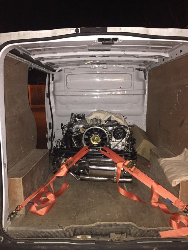

Evening guys,
Just a quick check-in this evening....

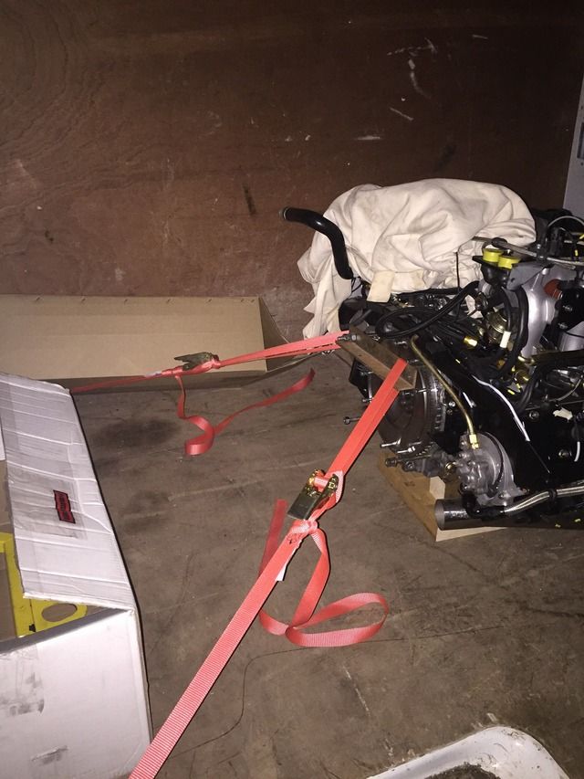

The engine was loaded onto the van yesterday afternoon, big thanks to my Dad, Brother and neighbour Ian for the required muscle to manoeuvre the car and keep an eye/hold stuff whilst getting it loaded.
I don't know how, but no matter how much planning and thinking ahead I do, be it packing to go on holiday or getting stuff ready for the dyno, it always goes down to the wire to get it all done in time....last night was no different....still doing some last minute checks and tightenings on the engine, whilst in the van.
Lashed-down and ready to go...
http://img.photobucket.com/albums/v2...F4054094F2.jpg
http://img.photobucket.com/albums/v2...2ABEC04D29.jpg
Fully laden with everything that I may possibly have needed (I live about 100miles away, so not the work of 5 minutes to go and get something I forgot), a 6am departure was achieved. Sun was out, some good tunes on the radio, no snarled traffic around the M25/Dartford Crossing....good signs indeed.

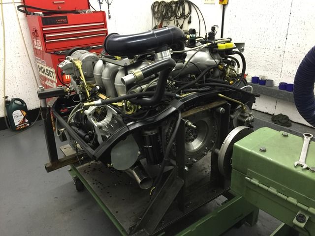

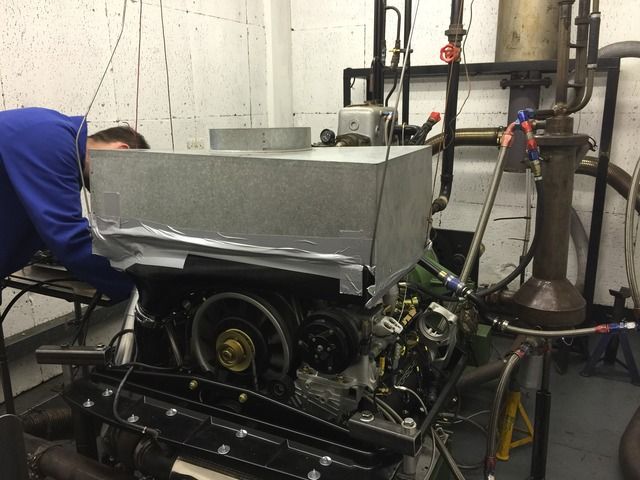

Arrived at DTW around 8.15, quick drink then Dave and his son Alan arrived. No messing about, engine straight off and we're into making the parts needed to mount the engine onto the base "trolley". They had 4/5 different Porsche engine cradles for the front, and 2 for the rear, plus 9-10 different generic adapters for the dyno driveshaft. So, everything just bolted on, right? Not quite!
Some very nice setting up of the adapter plate onto a rotary table, got the 9x holes drilled perfectly first time around. Bravo Alan!
Then time to make some spacers for the bell housing studs; of course, these are very tight to the flywheel, so flats needed milling. Rear cradle then mounted.
The front cradle took more head scratching. The 4 of the ones they have were nowhere near for this particular application, but one was pretty close. Close but no cigar, as the turbo position and the wastegates prevented it sitting under the mounting bar....so, time to think creatively and adapt it with box section and spacers to mount onto the bar from above. All sounds remarkably easy now I type it, but it's taken all day to get everything done in a way thats's bloody rigid and dead parallel with the trolley.
The engine's so wide, it also required the door of the corridor linking the workshop to the dyno room to be removed. Anyway, it's now in the dyno room ready to have the oil and fuel lines plumbed in. These were prepared today in readiness for a fairly early start tomorrow. After that, a quick removal of the plugs to spin her over, build oil pressure, then look to do the initial fire-up. Steve (SBD) will be present tomorrow for mapping duties, so fingers crossed for another update in 24hrs time.
Unfortunately, we were so busy working, I forgot to take any pics; will do so tomorrow first thing....but here's the pub I've just mozied down to for a couple of pints and fish-n-chips. Quintessentially English and a lovely spring evening.

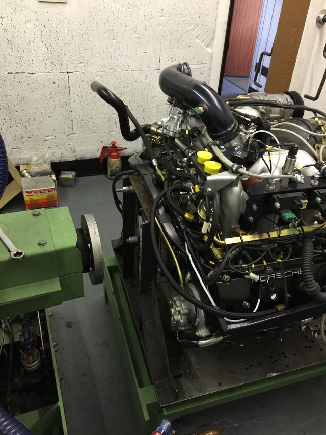

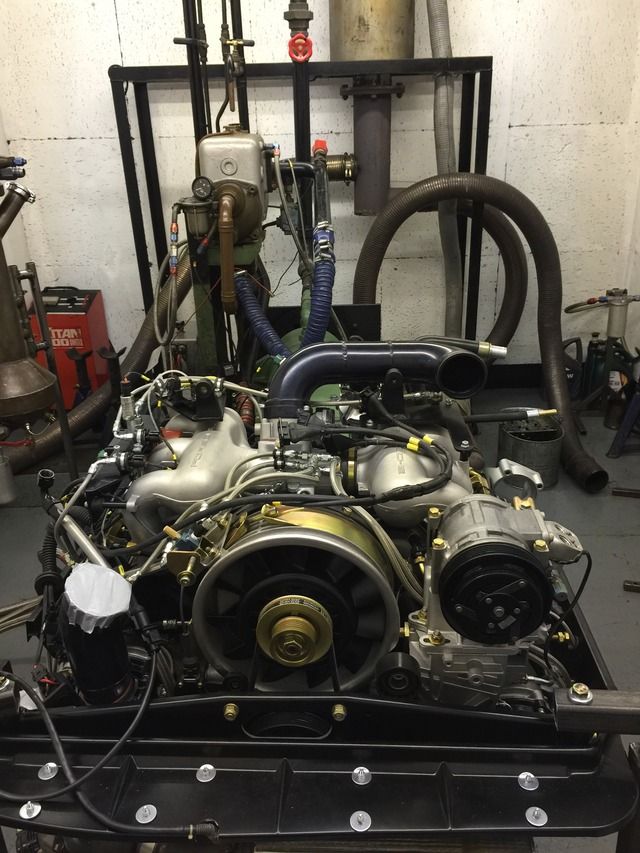

Day 2 & 3 update....
Yesterday was a day of 2 halves; the beginning half was to finish off mounting the dyno sled to the dyno itself, which meant a little re-jigging of the engine on the sled to the enable everything to marry-up. Then time to plumb in the wet stuff. Fuel pressure came up no problem, no leaks or even weeps on the whole circuit.
Oil pressure was then driven up on the starter - this also came up well. Phew! No leaks, just evidence of oil being pushed around.
However.....gremlin time, some electrical snags with the eGas setup, both the 997 Carrera throttle body and the potentiometer itself.
First issue was that the s/w we thought we be correct to drive the self-check sweep on the eGas wasn't quite right - resolved by using another version of the code. We also have Chris @ MBE at the end of the phone who's cutting us new code as-I-type to increase the power to the drive.
Second issue was that **somehow** I've ended up with the wrong potentiometer unit....despite buying what I thought was the right Bosch part number, I look to have been sent something different; same form factor, pulling mechanism, etc, etc...it looks identical....but it's acting as a switch, which leads us to believe its a kick-down unit rather than a throttle drive.
So, yesterday evening, a complete lap of the M25 was driven by me in the van, to go to the SBD workshops and collect a couple of known good pot's. While I was being white-van-man, Steve and best mate Matt were working frantically to sort the eGas issue, which they did successfully. Thanks guys!
Currently sitting in the dyno control room, seem to have another slight issue with crank position sensor not picking up teeth on the flywheel....will update later when we know what's going on.

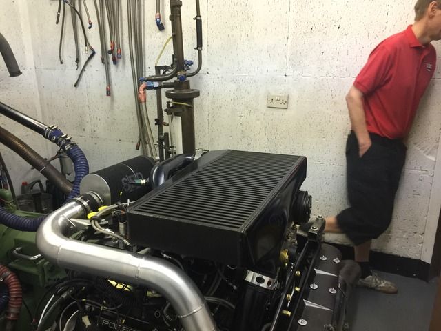

Spenny_b 04-16-2015 12:43 AM
Day 3 Update.
Well, lets start with the positives....IT LIVES!!....at 6.20 this evening, she burst into life, pretty much first time. After some idle checks for leaks or any evidence of anything not being right, we began the running-in procedure, taking the revs up to between 2500 and 4000, checking, dialling in more fuel when needed....all the time with Dave (Mr DTW) listening to the engine with his det headphones....listening to The Waltons on Radio 4

Now, Dave is one of those guys who's forgotten more than most people know, been in this game for decades, seen most things, bought T-shirts every time. He's also ex Brain Hart, i.e., Hart F1, F2, etc, etc. So, how happy was I when he looked at me, gave me that smile and a nod of a job well-done. Of course, we've got a long way to go yet, but by the end of play this evening, we had just under 2 hours of running complete. Oil pressures looked spot-on, as did oil temps and head temps.
http://img.photobucket.com/albums/v2...D7D0D5859B.jpg
http://img.photobucket.com/albums/v2...815AB08367.jpg
http://img.photobucket.com/albums/v2...8E5B7ECD73.jpg
http://img.photobucket.com/albums/v2...4875D32135.jpg
Steve, proud member of the Ministry Of Funny Walks...
http://img.photobucket.com/albums/v2...9ACA31D215.jpg
Intercooler shroud in place, taped-up to force as much air through it as possible.
http://img.photobucket.com/albums/v2...829F22B26D.jpg

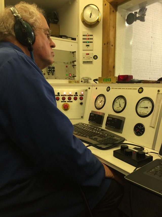

Dave & Steve in the control room....
http://img.photobucket.com/albums/v2...01073EBAD9.jpg

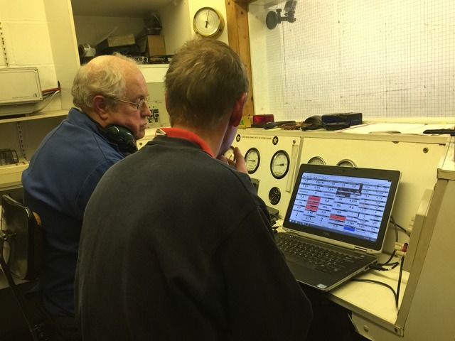

We have a couple of things to look at though; primarily, we need to get the Lambda sensor working for closed loop mapping. Up to this point, we swapped in one of Daves Lambdas that hooks up to his MoTeC monitor in the control room. This could be another electrical issue, which will be resolved first thing in the morning (we've checked another sensor hooked up to the MBE, and that gave the same result). Once fixed, mapping will be far quicker - doing it manually will be extremely labour intensive.
Up to this point, I was ready to sell the bloody lot. More gremlins today, which probably isn't something for me to detail here just yet, until we know more. Suffice to say that what we found was that we couldn't see a crank pulse at all. We switched sensors, inputs, buzzed things through, checked voltages, but it proved utterly baffling. In the end, for the sake of getting something done and burning as little dyno time as possible, I did another lap of the M25 this afternoon to go and collect more parts to test with. It paid off though, and for the time being we've switched the hall effect sensor for crank pickup to an inductive type. This also means that the ECU needed switching to one that is built for a mag crank sensors/HE cam phase sensor, not HE for both.
After some modifications to get the positioning of the crank sensor correct (it's directional, not a centre pip type), we then had a live engine.
The other thing which we need to possibly look at at some point is the fuel pressure regulator. At the moment, we're seeing upwards of 70psi. At 3000-3500rpm, the duty cycle of the injectors (690cc Siemens) is so low - approx 8-10% - that any adjustment to keep the AFR in check is very sensitive. The injectors not quite being in their sweet-spot, as they're flowing too well. May need to get an adjustable unit, don't know; we'll see how we get on tomorrow.
Simon is going to come up first thing to help assess what's going on with the Lambda system, again, to save time. We weren't initially planning on using a 4th day, but hey, these things are never as straightforward as you'd hoped. Thankfully the dyno is available, the B&B have a couple of spare rooms and Steve is already up here.

This morning and early part of this afternoon was spent working on corrective activities with Simon; checking, double checking, re-working some connections and enabling others. Still some finishing work to be done once the engine is back home, but in the interests of getting stuff sorted ASAP, things have now been tidied up from initial diagnostic work over the last few days.
Wastegate springs reduced to 0.6 bar black springs; my bad, I misread which model Tial WG's I had (on first glance the MV-R and MV-S look very similar; stupidly a year or so ago, I fitted the correct springs for 0.7 bar if it were the other model, but in my model, the poundage was too high (1bar). So, heatproof gloves on, and time to swap them out while Steve was building some maps.
We've changed tactic and not gone with mapping for TPS (which is 99% of what Steve gets involved with) and instead gone for pressure based mapping. Now, initially we shied away from doing this, as it's potentially a longer job (apparently). But, pleasant surprise of the day was that the engine really is behaving itself nicely, holding true with any adjustments that are needed, rather than wavering all over the place. The latest MBE algorithms which control target boost control and the boost control valve duty cycling also look to be crazy efficient. No wavering about with small variations as it approaches target boost, it's there, bang-on, instantly. It goes straight to whatever we set it to, and is rock solid. This got Steve and Dave VERY excited, potentially making life so much easier as the boost mapping process moves on.
We've now got the cam phase sensor plugged back in and working. This means we've now switched across from wasted spark to sequential spark, giving the ignitors (and COP's) an easier time. A comment from Dave was that when listening on the headphones, the engine suddenly sounded a lot smoother once this switch was made. Interesting.
I then disappeared for 30mins to get some fresh air and do the chocolate run...when I came back, some very cursory low-rev boost runs had taken place, with one running it up to just under 1.2bar and 3k rpm.... Bear in mind that at this stage, the fuel and ignition wasn't dialled-in 100% - some refinement to be had, but at 3,000 rpm, we're making a conservative 249hp and 369lb/ft of torque.

Day 5 Update - Part 5 - Concluding Thoughts (for this phase, at least)
The day ended after Alan and I unhooked the engine from the dyno last night, still the work of a couple of hours, then carefully loading onto the van and tying it down for the drive home. It was a strange feeling on that drive home; (bear with me here) very similar to the day my daughter was born insomuch that the whole week was a massive emotional roller coaster, where on the day Lucy was born, I left the hospital in a state of disbelief and shock - delighted of course - but not quite able to take-in what had just happened. The same last night; elated that we’d got exactly the numbers out of the engine that TK Chris and I had planned for….but….I can’t honestly say that the preceding time up to the point of 6.00 on Friday was “fun". For sure, working with Alan and Dave was great; Alan and I (it turns out) had very similar apprentice training, and he’s the kind of guy where nothing is too much trouble, his diligence and ability is first grade. Dave’s experience and ability in the dyno room is exactly what I was hoping for; unflappable and completely in control - the hospital Matron that you first entrust to hold your new-born. Nice guy as well. Of course, I’ve known Steve for over 20 years, so I know his ability with the laptop!
Dave and I had a chat after we’d finished the runs, and I was kind of comparing the dyno event as my “olympics”….almost 4 years of giving the project everything I’ve got. Learning as much as I can, spending as much time as I can in the garage, every waking minute where I’m not with Lucy or working, I'm thinking about the project, planning, researching, driving about delivering and collecting parts or documenting everything here. Financially it’s also a massive investment, and ultimately it ends on the dyno, where your homework is well-and-truly marked.
By putting an engine on a dyno, the amount of instant validation of your work is incredible…all those pondered moments over the years about whether you’ve done something well enough, or made something strong enough, or timed the cams accurately enough, or used the right mixture of components, or, or, or… It’s almost impossible to list all of those “oh yeah, that worked” thoughts, I don’t think I’ve had them all yet, but one that I hadn’t even considered until the drive home was that there are no engine leaks - the “Engine Sealant” thread in this forum having proven invaluable with the list of various compounds to seal things correctly (thanks Henry, it was your recommendations I followed).
As I type this, I can’t quite believe that my engine, my spannering and countless hours taken to assemble the core engine, have proven absolutely, 100% robust. Nothing fell off, nothing let-go, nothing went bang, nothing leaked (boost, fuel, oil) despite Alans continuous scrutiny whilst running. It sounded so sweet on the dyno, so I couldn’t be happier. I’ve allowed myself a little self-congratulations, and am actually quite proud of myself (hope that doesn’t come across as arrogant or big headed).
I have a copy of all the data logs, although frankly, I’m not interested in loading them this weekend and diagnosing them…mentally I’m shot at the moment, happy just to watch the MotoGP, F1 and Superbikes, unpack the boxes, manoeuvre the engine back into the workshop and do not a lot else….maybe some gardening.
So, just to wrap up the week, Dave will be sending me the dyno graphs on Monday; I’ll post as soon I have them. I *think* I have a couple of the final power runs on video, which I’ll edit and upload to YouTube.
The plan to get a load of recording went south. With all the issues we were fixing, I overlooked things like switching off a couple of the cameras and flattening batteries, as well as forgetting to start/stop recordings and running out of memory card space. But I’ll see what I have.
