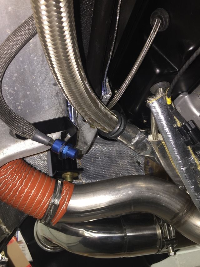

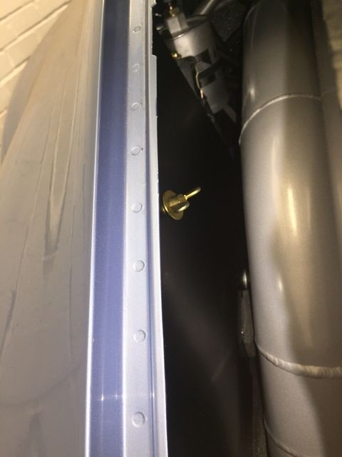

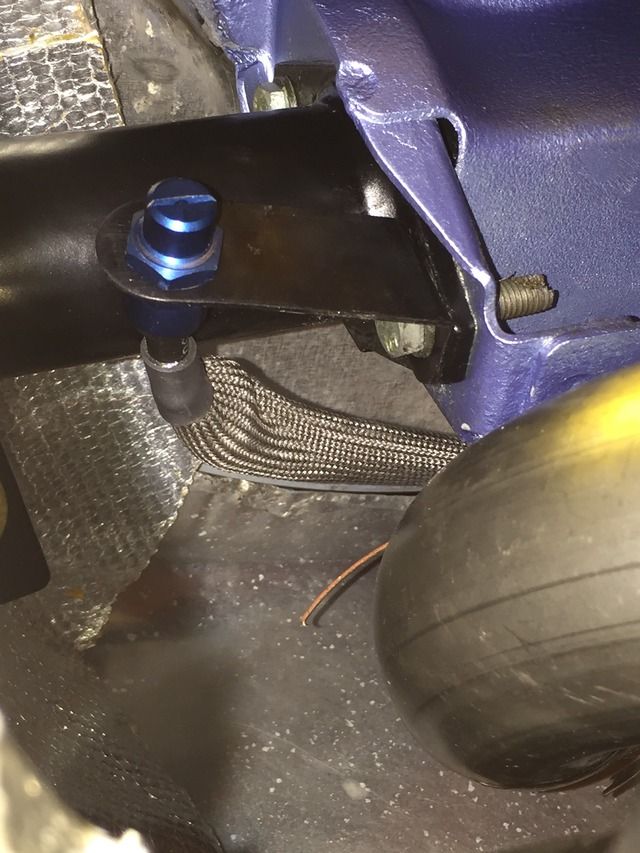

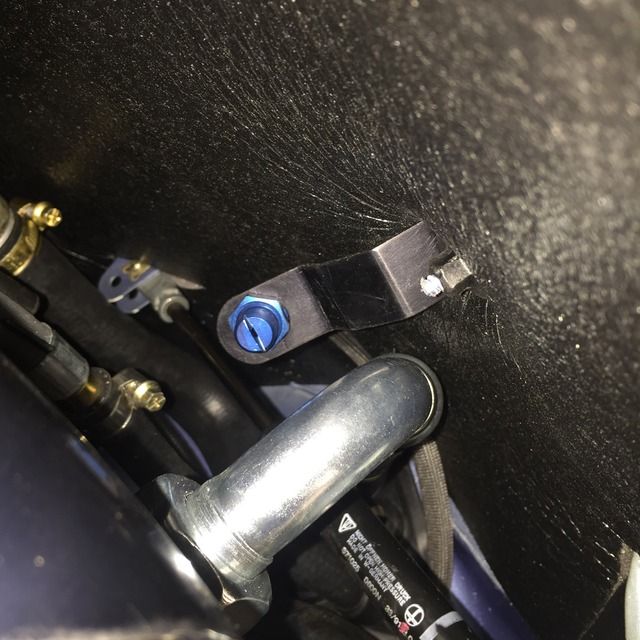

Primary goal tonight was to finish installing the newly anodised extinguisher nozzle mounts; the easy ones were already done, but the two underside brackets needed the hose trimming to length along with the sleeving, then terminating with the heatshrink.All easy enough, just a contorted working position to get to them!
The LH underside, using the lower tubular bumper mounting bolt to mount the bracket...
http://img.photobucket.com/albums/v2...B2763F85E2.jpg
The RH underside, using one of the heatshield fixings to mount the bracket....
http://img.photobucket.com/albums/v2...3920F8F7C1.jpg
All now done, with hoses all retained along their route. The 4th of the top-side nozzles is also now mounted, fixed to the neck of the oil filler; quite pleased how that's turned out, with a perfect position to smother the injection rail and power steering hose > pump....

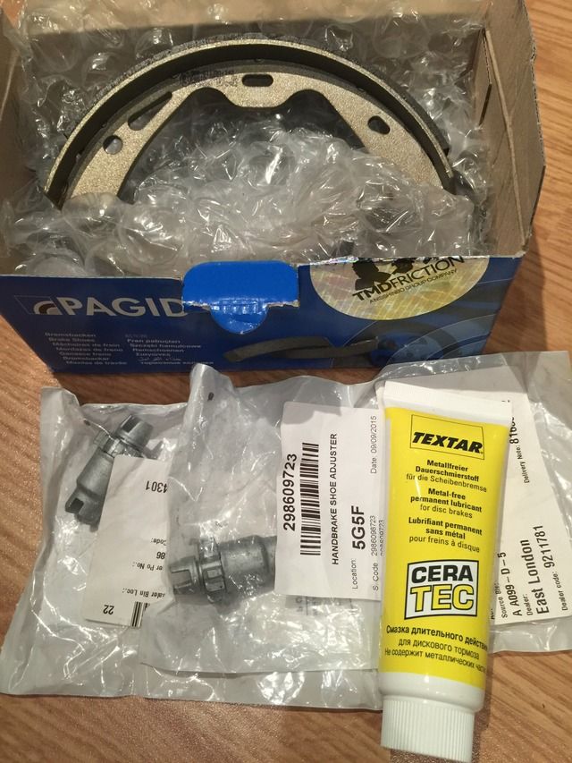

The new set of handbrake shoes arrived today, no reason to spec original Porsche items @£110/set vs £30 for these Pagids! Got some new adjusters while I was at it...only $5 each for genuine items, it'd cost more in degreaser to clean the old ones!
http://img.photobucket.com/albums/v2...98FBAA67A9.jpg

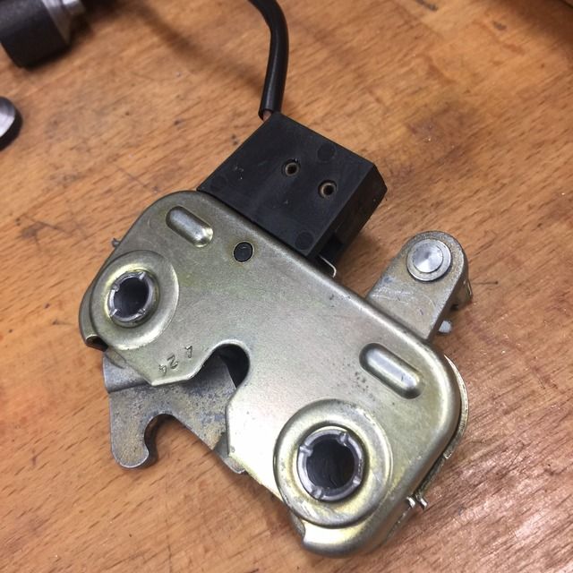

  • Get the wheels back on, car out of garage and the spare engine lid latch down from the loft - I can then swap over the broken microswitch and make up 2 new tubes for fastening it shut.

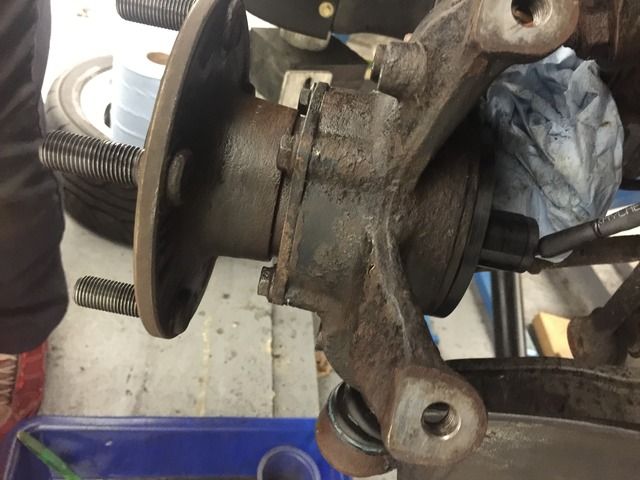

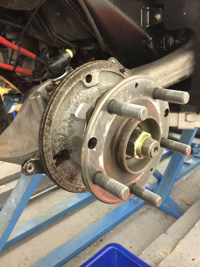

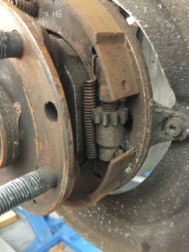

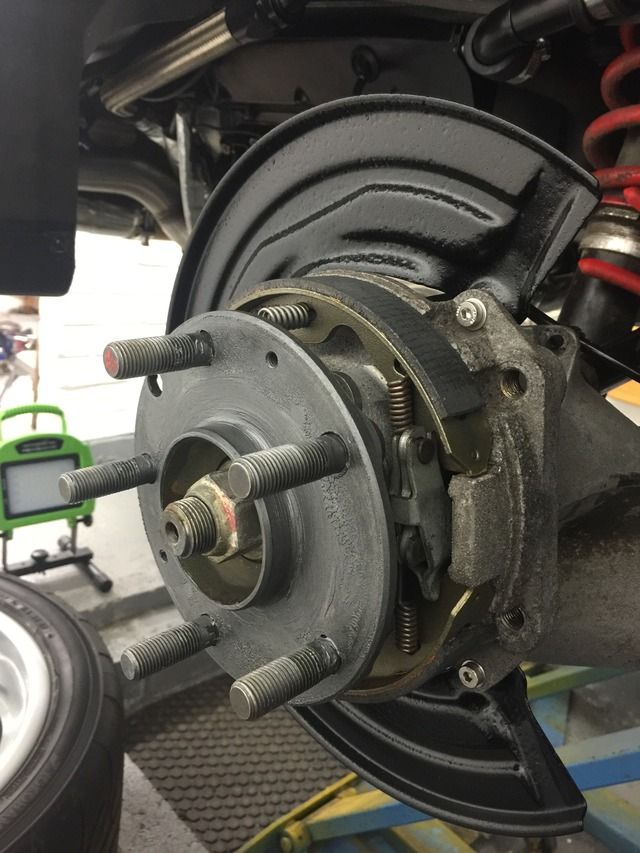

….time to get the Gunk Engine Degreaser opened, facemask on, and new wire brush set out, and go-ape.
The before picture of the rear axle….
http://img.photobucket.com/albums/v2...37CF1D4CF1.jpg
http://img.photobucket.com/albums/v2...F24BB66F9C.jpg
First job was to dismantle the handbrake assembly, not too tricky, then dunking the springs in to the cleaning solution. New shoes and adjusters….
http://img.photobucket.com/albums/v2...6A9CD693A1.jpg
http://img.photobucket.com/albums/v2...C76FC49E80.jpg
http://img.photobucket.com/albums/v2...C20AD2B3AC.jpg
http://img.photobucket.com/albums/v2...FB189C5FB6.jpg
Not a perfect job with cleaning the rear swing arm, that will wait until the suspension teardown, where everything will get vapour blasted. This was just a case of getting the loose stuff off and getting it “socially clean”.

All of the brake disc shields came off easily enough. Judging by the state of the fixings for each, I was anticipating a nightmare, but using a graphite based penetrating fluid a few hours beforehand, really made things easier. The rear shields look fine, just a bit grubby with surface corrosion, but the fronts are beyond saving. Glad it was this way around, the rears are over 2x the price of the fronts. The rear shields are going to go for blasting and powdercoating, the fronts will be replaced with another shopping list of parts I need.
Next, time to address the front axle. Far simpler, although its frustrating to be unable to really get the steel uprights totally free of surface rust and flaking paint….have to keep telling myself, it’s a job for another day!
Before....
http://img.photobucket.com/albums/v2...C72A3CF52F.jpg
After....
http://img.photobucket.com/albums/v2...FA93B2E28C.jpg

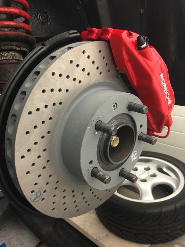

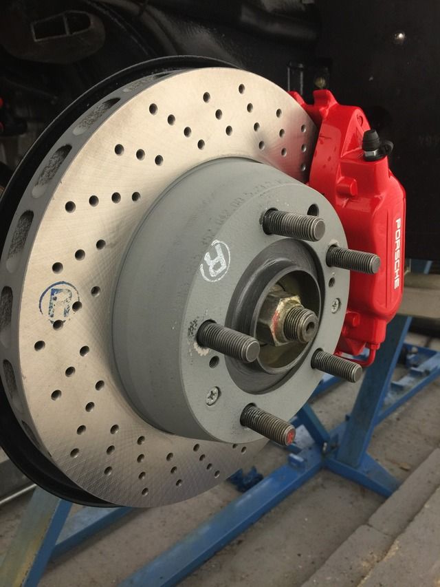

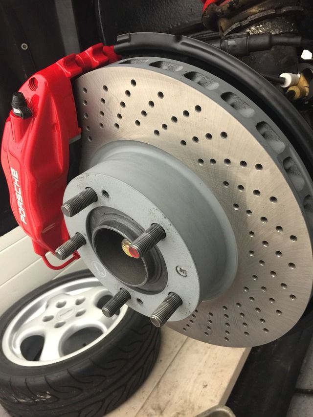

All the new discs are now fitted, light coating of optimoly on the hub faces to prevent any rusting, and she’s looking great! Can’t wait to get the “new” calipers back again and installed - that’ll be a very quick job now that everything’s cleaned.
http://img.photobucket.com/albums/v2...82B06877E5.jpg
http://img.photobucket.com/albums/v2...CE9DEFEF3C.jpg
http://img.photobucket.com/albums/v2...3525FC9D57.jpg

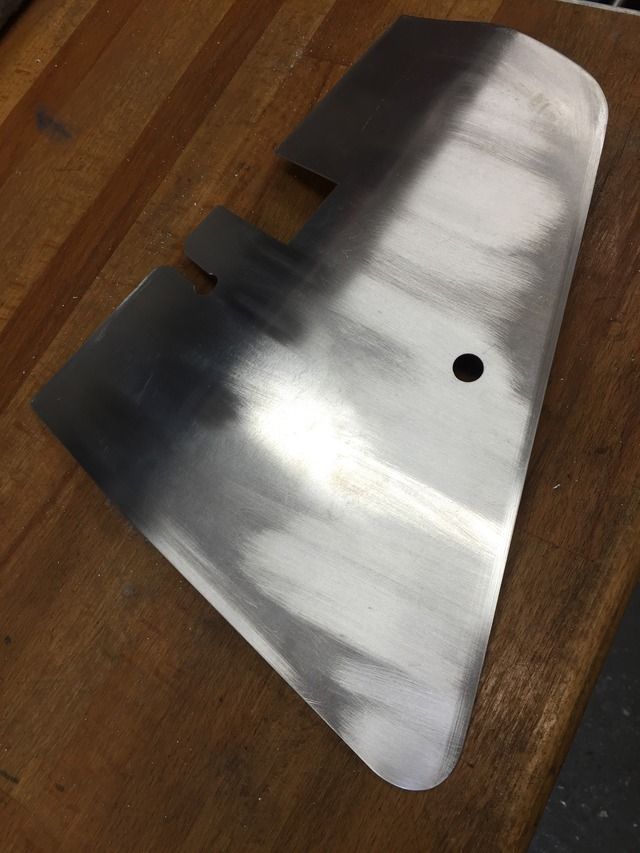

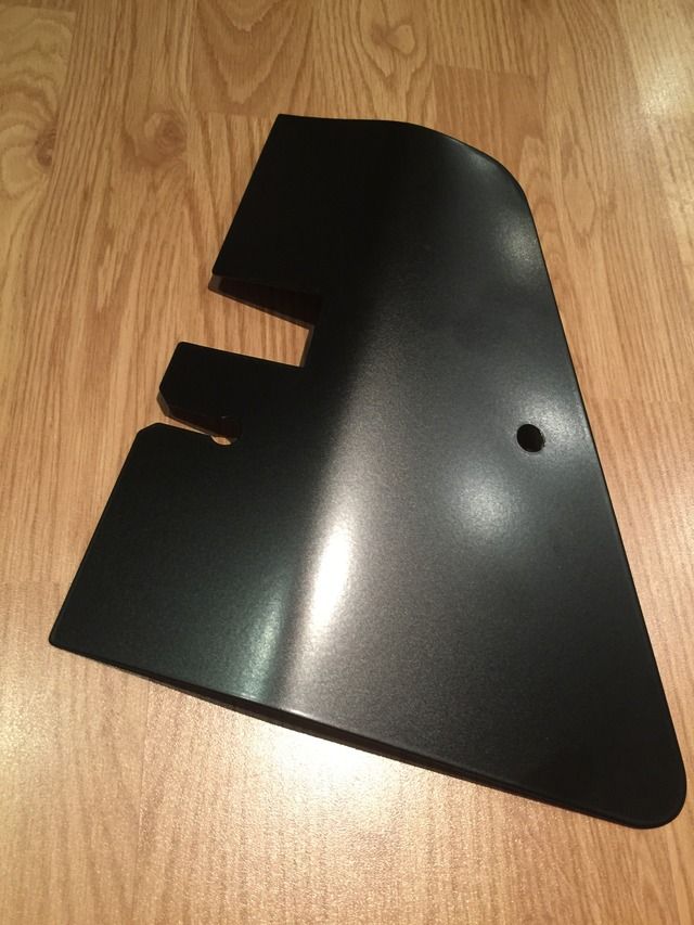

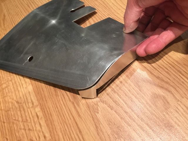

The fuse and relay panel cover....
Finally...after attempt #4, I've got something I'm really happy with, that fits perfectly.
The first attempt, many pages ago in this thread, was making it out of ally but I tried bending it in the sheet metal bender. What I hadn't really appreciated was that the original plastic cover is radiused in a way that isn't parallel with the bottom of the cover, and there's ever-so-slightly a compound curve to it. Plus, the rigid fold line looked rubbish.
Plan #2 was to modify the plastic cover, cutting out the protruding section that once shielded the 4 fuses on the outside of the tray. These interfere with the intake pipe, so have been moved to the inside of the tray (some of the relays are no longer needed, so they freed up some space)....however, the ally infill panel that I planned on bonding to the inside once it was powder-coated, also looked naff.
Plan #3 was a flash of inspiration - so I thought - and so I got Googling for local 3D printing companies....perfect part to print, perhaps with a CMM input to create the CAD file. I kept the search regional, hoping that I could perhaps drop-in and explain what I wanted, and leave the part with them. I contacted one company this time last week, and to date, not so much as an acknowledgement. I hate these "Contact Us" hotlinks that generate a web email query, complete black hole when it doesn't go through your email client....grrr. It seems that in the UK, it's still very much a hobbyist part-time business - what I was hoping for was an outfit like the water jet cutting place I used; small family business, big enough to get it done, small enough to be interested.
So, Plan #4, buy some thinner gauge sheet metal from Pete/Lewis, so that I could hand-form it and shape to suit. I used the spare length of 3" diameter ally tubing, securely mounted in the vice to act as the former. The radius is tighter at the short end, and about 25mm out of parallel with the base. Surprised how quickly it came together, whilst watching last nights Colts/Pats game on replay ;)
Can't believe it looks SO flipping simple in the photos...believe me, it isn't easy getting it to fit in (what is now) a very tight space, lining up with the mounting holes, sitting over the rubber harness grommet and clearing the edge of the engine bay bodywork lip.
http://img.photobucket.com/albums/v2...754E7D6411.jpg
http://img.photobucket.com/albums/v2...A9061850FF.jpg
The return that is on the plastic part proved to be easy to make; I've only rough-cut it out at the tapered end, to allow Pete to weld it without blowing the corner away. That'll get tidied up once welded and radiused. Hopefully I'll get it dropped over tomorrow lunchtime.

So, the fuse/relay cover was welded over the weekend by Lewis - another fine job, and after half an hour with a set of files, I got it looking like this, in readiness for powder coating:
http://img.photobucket.com/albums/v2...E817E1907C.jpg
http://img.photobucket.com/albums/v2...DF7E372A7B.jpg
This lunchtime I got a phonecall saying it had now been powder coated and was ready for collection...
http://img.photobucket.com/albums/v2...C8A75623AC.jpg
http://img.photobucket.com/albums/v2...51C166A312.jpg
To me, it still looks ridiculously simple as a part, to warrant the amount of time it took...but there you go.

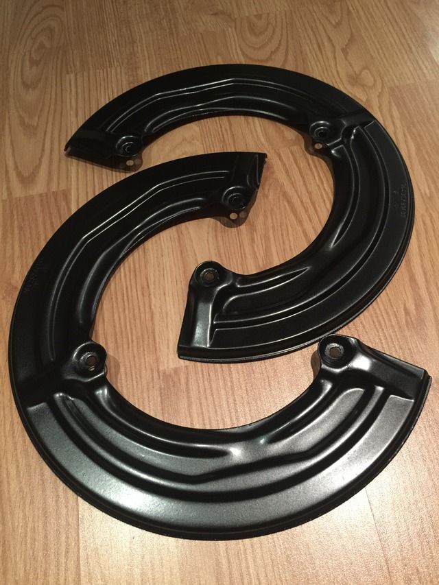

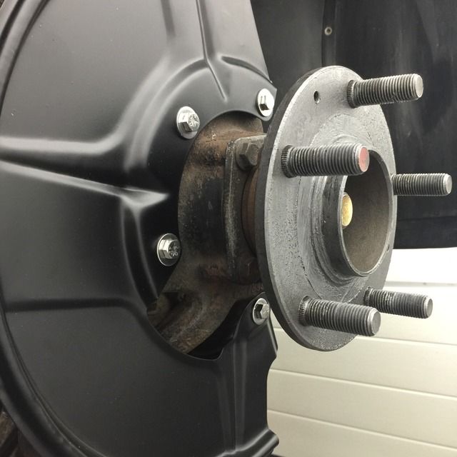

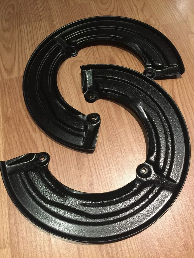

The 2 x rear brake disc shields were also done. The cover has come up very nicely but the shields not quite so well...very pitted on the inner surfaces, in fact there are a couple of places where the material has burst through once they were media blasted. They're good enough, I guess, and the visible side looks far nicer...but at £75+VAT each for new ones, they'll suffice.
http://img.photobucket.com/albums/v2...BCC44C3E07.jpg
http://img.photobucket.com/albums/v2...84AD694BE2.jpg

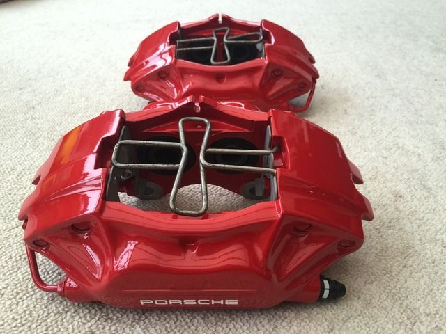

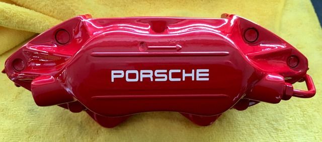

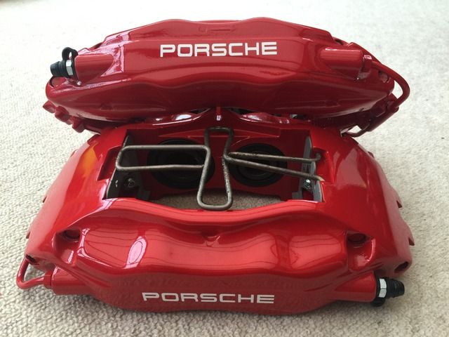

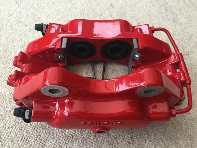

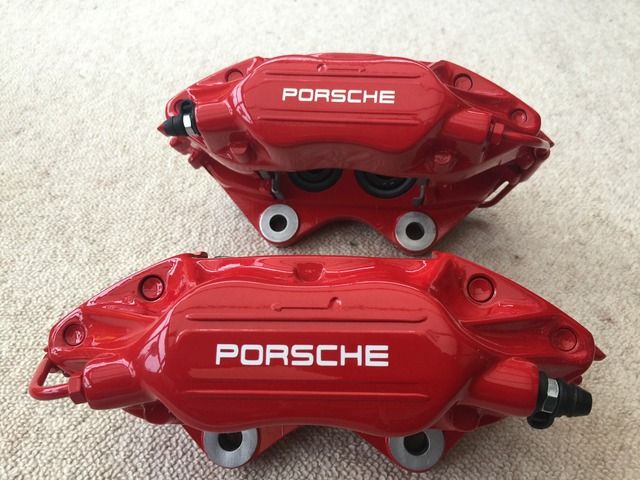

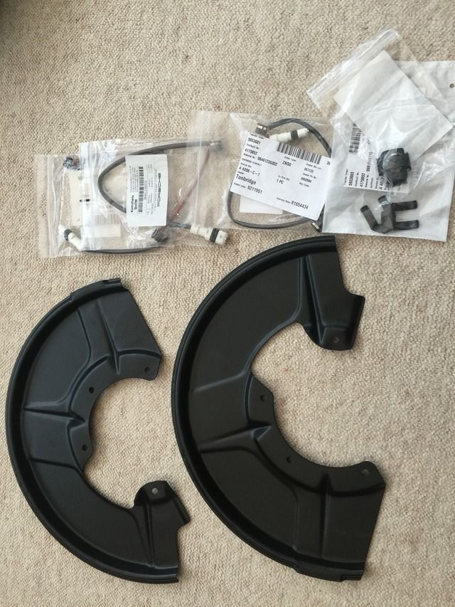

More parts are en-route to me from Tonbridge OPC; front brake shields, the remaining 3 pad wear sensors (the old ones were toast) and new brake hose retaining clips - the little square clips that hold the union between the rigid lines and flexi lines to the chassis and rear trailing arm.

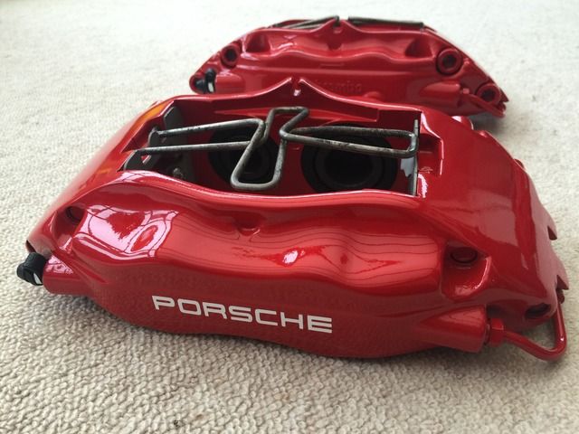

The most exciting news is that my calipers are almost finished. I spoke with Jonny again on Monday, they're really pleased with how they've come up after sanding and painting, but are just being extra cautious with shipping them before they're fully hardened...usual thing, the longer they can be left before handling, the better. With some rescheduling at my end, I asked them to hang onto them for the rest of this week, build them up over the weekend or early next week, then get them back to me midweek-ish. New fluid seals are always done, but I also asked him to install new dust seals regardless.
A couple of work-in-progress pics that Jonny sent me. I'm chuffed to bits with them, especially the logos which I asked to be the same as the ones previously, i.e., the old script, not the newer flatter logo...
http://img.photobucket.com/albums/v2...81ADF2C836.jpg
http://img.photobucket.com/albums/v2...37EAB3B7FE.jpg

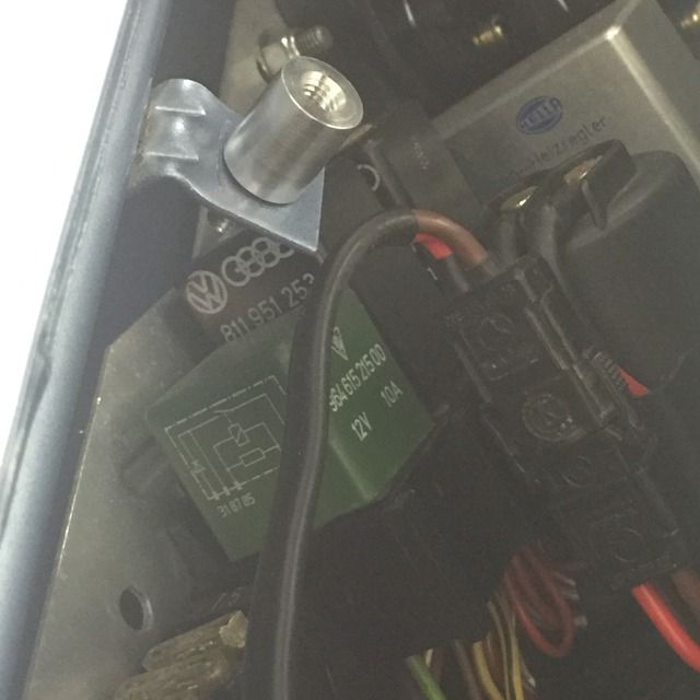

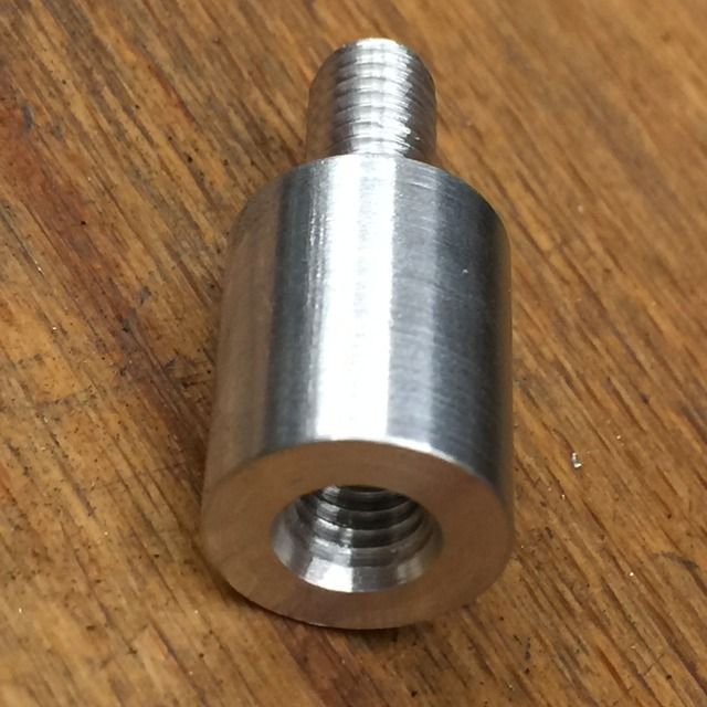

The fuse/relay panel cover is now finished. First job of the night was to make a stand-off for the cover to sit against; if you refer back to the pics of the original plastic cover, there's a moulded recess with the clearance mounting hole. It's this recess that spaces the cover correctly from the bracket which the M6 wing-bolt screws into.
So, half an hour on the lathe and this is what I came up with...
http://img.photobucket.com/albums/v2...0BA20EFF83.jpg
This then screws into the chassis, and is now Loctited in there semi-permanently....
http://img.photobucket.com/albums/v2...B75CA788D0.jpg
Meaning that the original factory wing-bolt can be re-used. One little modification though...that bolt has got "I'm-going-to-drop-down-into-the-engine-bay-irretrievably" written all over it, so I applied a trick used on some of the fixings on the Exige, where a nylon washer with an undersize hole is used to make it a captive bolt onto the cover....
http://img.photobucket.com/albums/v2...0F6DE03954.jpg
And the finished article in place. Almost unnoticeable....as it should be...
http://img.photobucket.com/albums/v2...D1E9CD49C0.jpg
Next job, start fitting the brake shields. When I got home this evening from work, this weeks order from Tonbridge OPC had arrived, including the 2 new front shields.
http://img.photobucket.com/albums/v2...88FCD4DA21.jpg
I only got 2 of the 4 fitted, the RH front and rear, the others can wait until tomorrow.
http://img.photobucket.com/albums/v2...CD09BBC454.jpg
All of the stainless fittings worked a treat. While the wheels were back off, I also swapped all of the inner arch liner fixings over for the stainless fittings.

First job of the day was to finish the 4th corner, LH front, with installing the new brake shield, as well as swapping the inner arch fasteners over to stainless items.
http://img.photobucket.com/albums/v2...9E8BC89FA7.jpg
Easy. Now the car can be brought down and off of the lift.

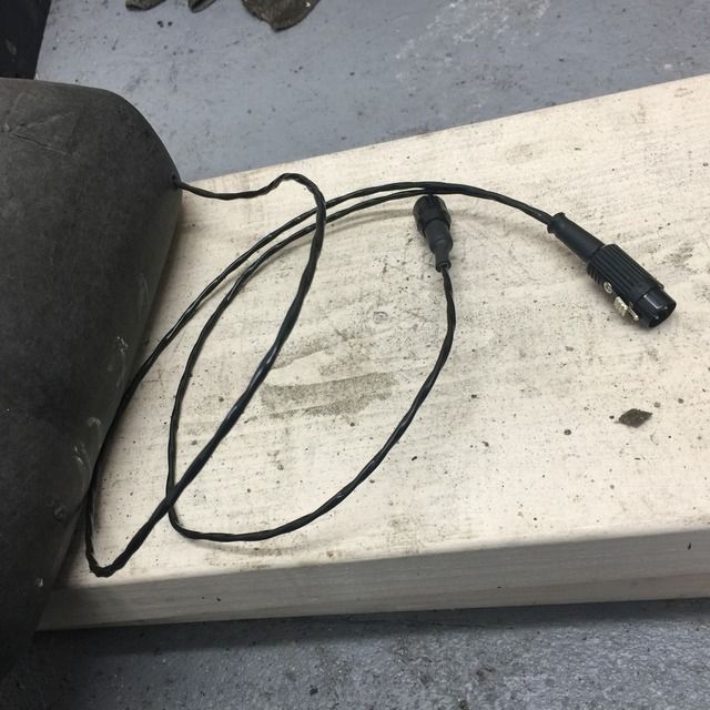

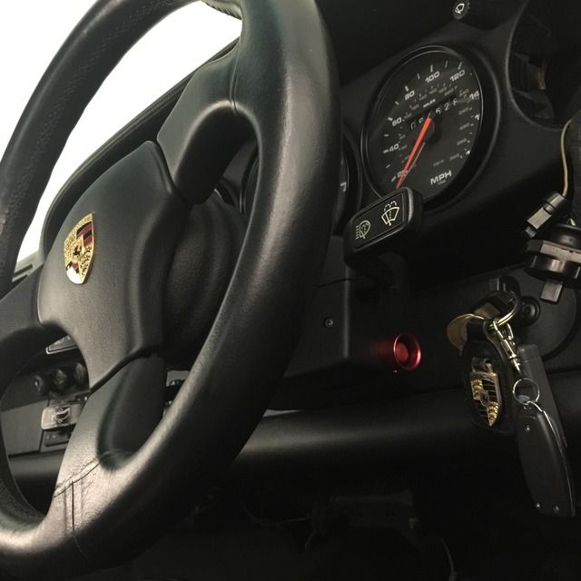

...which is a convenient segue onto the next job, to wire the extinguisher bottle > firing switch > control box. I'd been considering where to mount the "big red button" for some weeks, alternating between a hidden placement in the glovebox with the control box, or somewhere on the dash, or on the steering column shroud.
In the end, mounting on the dash was discounted - I don't want to drill holes there. If you remember back a year or so (!) I made a bung to plug the hole in the column shroud, where an original dealer fitted immobiliser once sat. With some careful measurement, I decided this would be the perfect spot; discreet enough, but visible "in the event of".....
http://img.photobucket.com/albums/v2...636432D8A1.jpg
Next, and final job on this sub-project was to build a very simple loom....

Passenger seat is also now connected and bolted in place.
Only 6 jobs remain...

The engine cover latch, if you remember, needed to be re-built after I discovered that the one I bought from the US - all nice and shiney - had a broken microswitch wire that was impossible to repair. So, time to make one good latch out of 2 not-so-good items.
I opened up the "new" item a few weeks ago, to investigate how it was assembled and to take dimensions of the tubes which are used to keep the two halves together.
Yesterday, I made both the forming tools and 2 new tubes from aluminium, thinking that this would be a nice, deformable material to use with a pair of forming tools. All great in theory, but in practice, I think they swelled up in the middle when being crimped under the hydraulic press. This meant that both pieces of the latch refused to pivot; completely locked.
This is the pair of formers I made on the lathe...
http://img.photobucket.com/albums/v2...4BCDAAE0F9.jpg
...which seemed to work well enough in principle. Plan B, after I drilled out the ally items (which were indeed absolutely stuck inside the locking plates and required a parallel punch to remove them), was to remake the tubes from stainless steel. Mild steel would just mean more delay while I got them plated before installing them.
After practicing how to hold 4 things at once (!), and making the OD's of the tubes ever-so-slightly smaller this time (so that they weren't an interference fit into the latch frame), it was time to assemble it in the hydraulic press and have another go. All-in-all, a lot better second time, as I could get the tubes central and the crimps even top to bottom...
http://img.photobucket.com/albums/v2...5B6CF4DAB4.jpg
http://img.photobucket.com/albums/v2...781A7009AD.jpg
A pair of indentations into each crimp makes it look like the factory unit again, and thankfully I remembered to install the correct switch into the rebuilt latch ;)

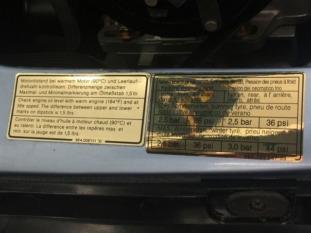

The only other job I got done yesterday was a finishing job - applying the replica stickers to the slam panel. Not sure if I like them or not, because although the quality of the printing is fine, the substrate is just a thin foil rather than the metal plates of the original stickers. They're also a lot more reflective, rather than the stock items satin finish. Not a big deal to remove them again if I decide there's a better option. Photo later...
Spenny_b 11-02-2015 03:35 PM
Back on track this evening.
First off, here's some pics of the reproduction engine bay stickers; of course, the valve clearance and firing order plaques aren't original to the 964 generation, I just quite liked them for their geek-ness.
http://img.photobucket.com/albums/v2...372B3F2CAD.jpg
http://img.photobucket.com/albums/v2...8AB7B1692A.jpg
http://img.photobucket.com/albums/v2...8128BA3630.jpg
http://img.photobucket.com/albums/v2...EAE3BB19A0.jpg
I have a new replica sticker the same as the original oil level check procedure; but from last nights efforts, the adhesive that Porsche used is a swine to remove!...As said before, undecided at the moment...more important things to focus on.

Received the brake calipers back last week, nicely boxed up....
http://img.photobucket.com/albums/v2...3D4D219EFC.jpg
....lo-and-behold, a nice set of painted calipers....
http://img.photobucket.com/albums/v2...5D429CCD2B.jpg
http://img.photobucket.com/albums/v2...97D0FB4C6B.jpg
http://img.photobucket.com/albums/v2...3F19BC3E52.jpg
http://img.photobucket.com/albums/v2...BD2D6D506D.jpg
http://img.photobucket.com/albums/v2...F78483F3C2.jpg
http://img.photobucket.com/albums/v2...254A9F207C.jpg
http://img.photobucket.com/albums/v2...57A0CC02BD.jpg
http://img.photobucket.com/albums/v2...BC3B896B8C.jpg
http://img.photobucket.com/albums/v2...EA9681B2BA.jpg
Think I mentioned it before, but these were a complete refurb, pretty-much regardless of whatever they found, so the fluid seals were replaced, as well as new dust seals (normally they're re-used unless completely shot)
Next job, to install them...easy in principle, as I cleaned everything up weeks ago, yes? Almost. I had to leave the original rubber hoses on, as there's fluid in the system, so each corner was clamped in the meantime.
New teflon hoses on standby, along with new spring retainer clips....the old rigid lines into the 22yr old original flexi brake lines....they cracked open eventually, but still refused to rotate about the copper pipe, so needed to undo by twisting the whole hose, clamps as well, with brake fluid peeing everywhere....tools, floor, me...all covered. Grrr, hate brake fluid. Lots of washing down with soapy solution to ensure calipers and anything else doesn't get stripped. The original spring locks for the hoses were also stuck fast with 22yrs of grime/wet weather/rust.
The plastic protective coil on the original lines was removed, cleaned and installed onto the teflon lines, new clips and new rigid lines up to the calipers.
The stainless spring spider wasn't re-plated as I'd hoped, apparently they were in good condition, but my usual attention to detail prevented me fitting them as-is, so time to get a fresh sheet of Scotchbrite Red and get-to-it.
I also noticed that the slider plates weren't sitting flat onto the base of the caliper by about 0.5-1.0mm, preventing me getting the brake pads installed....the common "plate-lift" issue that afflicts these calipers. So, removed them, cleaned the underside, removed some corrosion from the corners of the caliper and refitted (unfortunately this has compromised the painted finish but is now Dinitrol protected, and is hidden with the plates installed)...all good again.
Lucy spent the morning on Saturday helping me install the right rear caliper, bless her, in her little red overalls (she looks like a junior Red Arrows pilot!)...she now has a good understanding of different types of spanner, sockets, ratchets, screwdrivers and allen keys! I think I owe her some pocket money....

For various reasons long-and-boring, the installation of these was due to happen during the week, last week...work commitments in the middle of our final fiscal quarter meant that work had to come first, lots of travelling and therefore re-planning. Oh well.
Finished installing them last night...looking very nice and fresh...
http://img.photobucket.com/albums/v2...E4B345E872.jpg
http://img.photobucket.com/albums/v2...8879F65A3D.jpg
http://img.photobucket.com/albums/v2...0CE3FA2730.jpg
http://img.photobucket.com/albums/v2...05F26FAFD7.jpg
http://img.photobucket.com/albums/v2...AF44FC6925.jpg
http://img.photobucket.com/albums/v2...CDDD612F8B.jpg
http://img.photobucket.com/albums/v2...C270A49854.jpg
http://img.photobucket.com/albums/v2...1CEF86F6E0.jpg
Tonights jobs are to:
a) clear up the mess!...
b) bleed the system and...
c) to adjust the handbrake again; I think it's a little on the light side, so needs a wheel remounting and some testing/tweaking.
