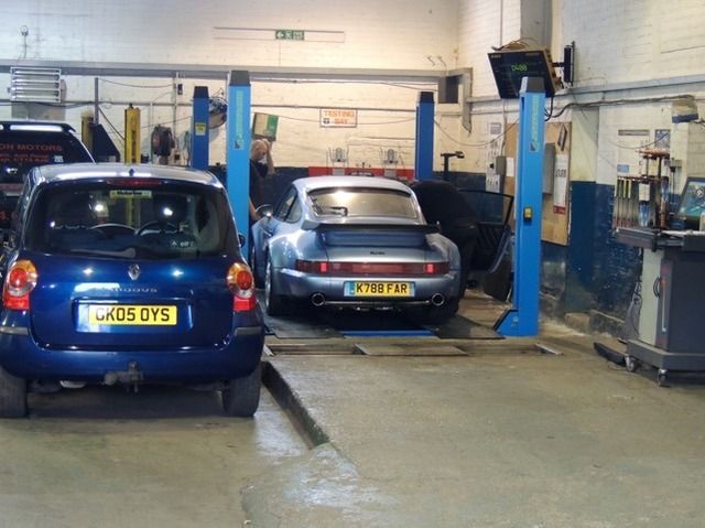

So, today was the big day for me and the car. Ollie, my Brother, was up with me at just after 8am helping to shuffle the fleet around (not helped by the battery in the Lotus being flat)....then it was time to get K-FARt rolling under its (her?) own steam....
Then off to the other side of town with Ollie following a safe distance. Of course, we went the long way around so I could get the brakes used a few times.

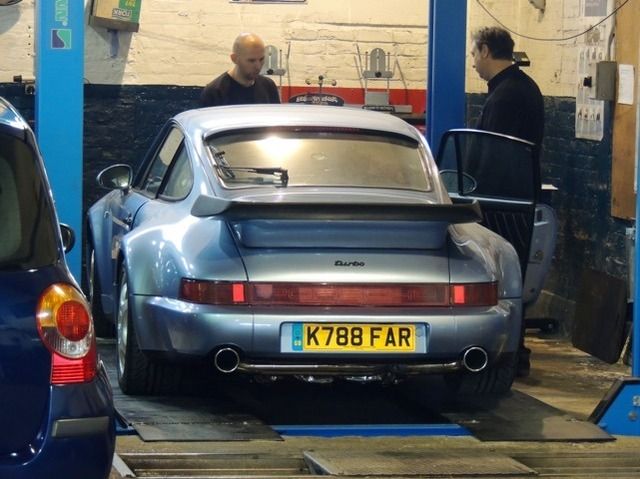

After all that, did the car pass the MoT?.....Nope.
A couple of niggly things; a brake bulb was out and the windscreen washer isn't working; Brake bulb has now been replaced and I did test the washers last night, but assumed it was because the fluid lines hadn't been primed that it wasn't squirting. Closer inspection this morning revealed that the washer motor wasn't even operating.
The emissions was also a fail. Again, for non UK guys who aren't familiar with the test, there are 2 x points at which it's tested; the natural idle and the Fast Idle between 2,450 and 2,850 rpm
The parameters measured are CO, Hydrocarbons @ Fast Idle (HC) and Lambda @ Fast Idle. With my car, the hydrocarbons count was extremely low, about as low as you're going to get at 5ppm versus a max of 200ppm. This is very good news, shows an efficient engine and gives us latitude to try and dial in the CO element. After 2 runs, the CO count halved from 2.233 down to 1.140 due to the cat really heating up (100 cell cat)...however, the max limit is only 0.300, so we're way out.
The plan of action is to return on Wednesday and see if we can extend our time using the gas analyser to dial-in the perfect blend of MoT pass and drivability. 95% of the MoT is done now, so that's good, we just need to nail this part without haemorrhaging the whole day.

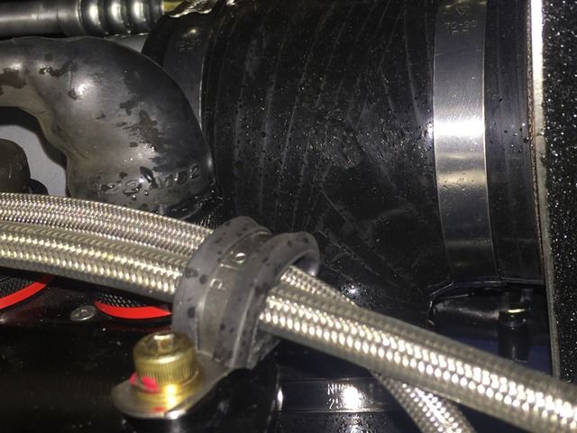

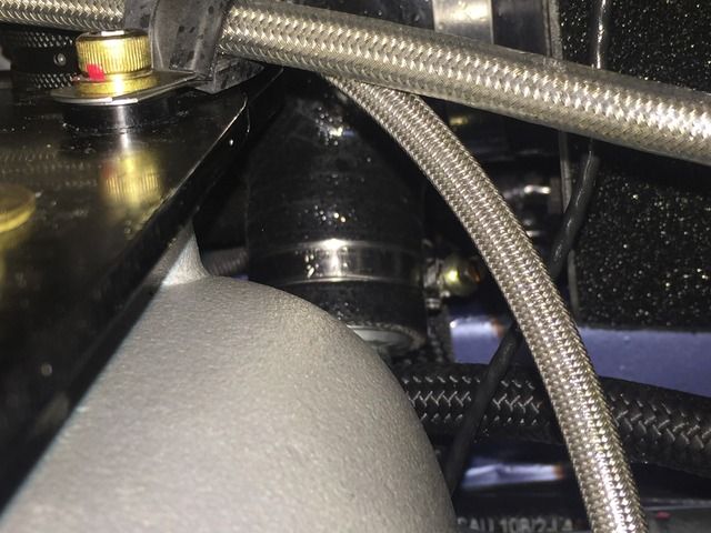

The work I did on Tuesday to fix the cam line banjo leak doesn’t look to have worked. Only had time for a quick cursory glance, but I did see a small pool of oil on the tinware skirt when we were doing the emissions check. Time to do it again, but this time I’m going to buy some self-sealing washers, the ones with a rubber gland bonded to the ID of the steel washer.
Investigate the dump valve

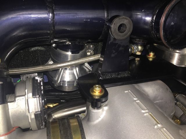

Actually, not the dump valve at all. There’s oil spitting evidence on the cold charge (exit) pipe of the intercooler directly above where the BOV is mounted, hanging upside down. Hmmm…why is there oil being sprayed? It can’t be *that* much oil, as it would’ve been detected in the emissions test, or rather, it wouldn’t have passed by such a strong margin….but there is oil nonetheless and I can’t help feeling it’s my oil tank breather catch-tank. A guess would be that under load, the vacuum in the inlet tract (where the catch-tank vents into) is drawing oil up and into the intake system. Arggghhh!!! This is the real pain in the arse problem to look into, as it’s going to be a significant rework to fix it, unless I say “screw it” and vent the catch-tank to atmosphere. I was going to dismantle the IC and associated pipework at some point, in order to rework the cold pipe and weld it a little more accurately to the IC….but I wasn’t planning on doing it this side of Xmas. Looks like I now need to remove everything, and presume that I’ll see oil in the inlet pipe, in the turbo compressor housing and through the intercooler. FU*K IN HELL.

After a busy week and just wanting to leave the car alone for a while, it's been a productive day back on the project.
First order of the day is to carefully strip the intake system, being cautious not to remove any tell-tale signs of where oil is coming from.
Report so far....
  • Intercooler is bone dry inside - no oil
  • Hot charge pipe (IC inlet) - no oil
  • The outlet of the turbo compressor housing - no oil
  • Cold charge pipe (IC exit) - no oil
  • The air intake tract - no oil so far, although it's still in place.
  • The oil breather into the intake tract from the air/oil separator tank - no oil
  • The inlet to the air/oil separator tank (from the main oil tank) - signs of oil, as designed
  • Pooling oil on top of the LH timing chain housing
  • More oil on the RH tinware below the top valve cover (cam supply)
  • LOTS of oil on the air shroud, under the intake manifold
Other findings:
1) The oil evidence I can see on the cold exit pipe from the IC is, I'm sure, excessive oil from the air filter when is adjacent to it. I'm not 100% convinced, as the filter is the opposite side of the pipe, but it looks possible that the BOV is blowing surface oil off from the filter, when dumping excess boost. It does feel stickier, much like the retention oil that's used on new foam filters. There's no trace of oil in the pipe that the BOV is mounted to, so it's for sure nothing in the intake air supply. Great news, and I'll try and remove as much oil as I can from the filter now that it's had chance to cover all the foam cells.
2) (talk about airing your mistakes in public)....The oil return from the air/oil separator tank is a small -3AN hose, feeding from the tank to a spare union on the crankcase breathers chimney plate. I installed a -3 adapter, which is still nipped-up tight, but the 90º -3AN union was less than finger tight. I remember that I struggled to get this lined up, so perhaps once I did manage to get it on and finger tight, I maybe got distracted and made a cuppa, and never tightened it fully....no signs of my red paint-pen....
Clearly, this is the source of the oil on the shroud...and everywhere else. What a stupid error, and has only been added to (although tiny by comparison to the crankcase breathing) by the oil return from the source separator tank.
3) The pooling of oil on top of the timing chain housing, I'm pretty sure, is where oil has run along the -4AN hose that is used to lubricate the turbo. It snakes slightly downwards from the top right corner, under the intake over to the front left hand corner, over the top of the timing chain casting (and resting upon it), before disappearing down through the tinware to the turbo. (you can just about make out a faint yellow-y path of oil down towards where it's pooled, and wetness under the -4 hose)
I can see no other possible source for the oil; the line that runs to the cam housing (new) is bone dry, the uppermost nut between the casting and the crankcase is also dry, and there is no other tell-tale wetness in the surrounding area apart from oily residue from where the oil supply line to the turbo rests on the housing. It's basically been used as a conduit. Or the housing casting is porous!? (joking).
So in addition to some cleaning up of the oil, that's where I'm up to before breaking for a well-deserved fry-up lunch. And to document this. So, best I disappeared back into the garage and carry on. Will report back later with more findings.
