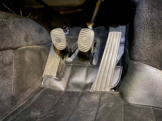

There was also one more interesting additional job…..(prepare yourself, it's another anecdote...)
When Chris (Northampton Motorsport) was solo driving the car down to Fearnsport (Silverstone circuit, about 10-15miles away) he was able to reconcile some thoughts on how the engine was driving, without interruption from somebody wanting to do live calibration tweaks. Apparently, when he arrived at Fearnsport and chatted with Matt, he queried the eThrottle pedal and whether it was perhaps broken. When Matt then informed him that the car didn’t have an eThrottle pedal but was still running the OE cable throttle, the lightbulb moment happened.
As long time readers may remember, many years ago I swapped out the Porsche throttle linkage on the engine for one I fabricated myself. It took many days to build and weld, and was done to accommodate an Audi eGas potentiometer, a rotary device operated by a short cable. I spent a lot of time getting the leverage ratios correct and bushing the pivots to make it as slack-free as possible. Way-back-when I do remember having a conversation about trying to use a BMW eThrottle pedal but dismissed it as looking too aftermarket and possibly not even fitting.
Consequently, I’ve always used a setup thus:
OE Pedal >>OE (and original) throttle cable to engine bay >> Actuating my home-brew linkage >> In turn actuating the Audi potentiometer >> Then the electronic signal from pot to ECU to 997 throttle body.
With the lengthy cable, throttle linkage “play” and then the short Audi cable, it’s little wonder that Chris described the driveability being like the engine is disconnected to whatever his foot was doing at the throttle pedal. Kind of kicking myself now. Like everything, hindsight is 20/20 and a wonderful thing.
As it happens, Matt had also investigated using a BMW pedal in another customers car (a lovely “Altzen” 964 RSR). I don’t mind admitting that I rather too hastily dismissed the use of said pedal back in the early days of this project. It looks absolutely stock when mounted correctly, as Matts other customer will also attest. So….Job #7 for Matt was to mount an E46 BMW pedal that I sourced, and get it wired up to the ECU. This was done, and I think you’ll agree, looks “factory”…..
Wiring is actually run back from the new pedal to the engine bay and interfaces to where the Audi unit was connected previously. If starting again with a new harness, then obviously we'd keep it inside the cabin and directly into the ECU, but at this stage that would be really messy, hacking the Raychem boots around and then "orphaning" the part of the harness that runs to the engine bay. Plus, it gave us a backout plan should the BMW pedal not work out for us. (spoiler alert, it did)

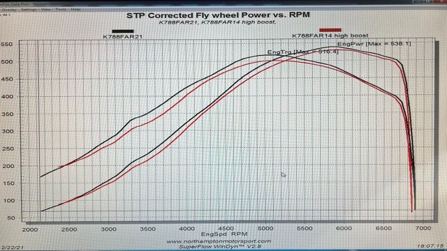

As you can see below, the red line is from the last session back in 2019, the black was this session. Headline peak numbers are +12bhp and +18lb/ft, but better still is the midrange increases of about +26lb/ft at 3,000-4,000. Peak hp is now 538.1, and peak torque 516.4lb/ft. That should be "adequate"
At this point it’s getting late and time to call it a day. Troy and Alex are happy with things, notwithstanding a real world test drive being satisfactory. A long drive home for me beckoned (in the M2C, not in the Porsche) with a plan to come back up the next day to do that test drive and all being well, to drive it home!

And….Oh. My. God. What a difference. That new pedal is just magic. No longer do I have to deftly dance the pedals like Walter Rohl to pull away from a standstill and not embarrass myself with either stalling or making a racket. It drives….normally. Pulling away is smooth, it doesn’t try and stall, it doesn’t get all lairy…it just “does”. In fact, at the moment, every drive I do I marvel at it. The simple things, eh?

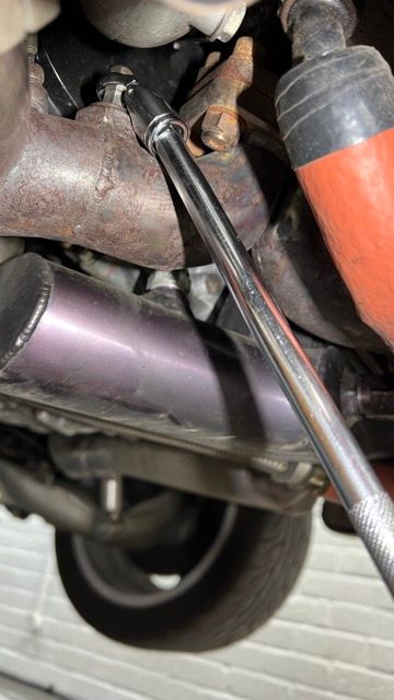

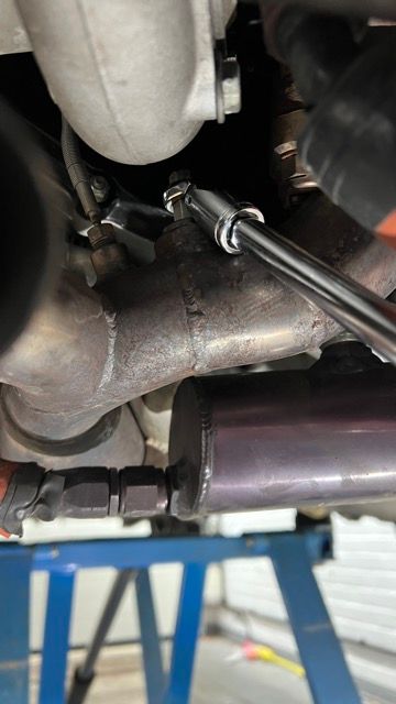

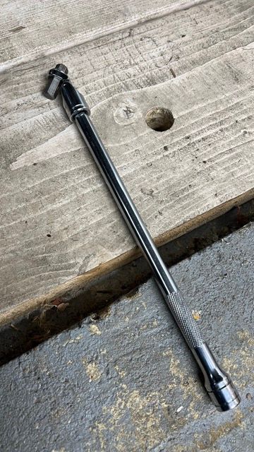

The following morning, early start, time to get the car on the lift for a proper inspection. Firing up the tractor, the noise seemed to be coming from the turbo area....was the housing cracked? Not that I could see, albeit with a heat shield hiding a lot of it. And then I saw it.....one of the blanked off Lambda sensor ports on the secondaries, that I had originally welded in there when intending on running 2x sensors. The one directly under the turbo compressor housing. A quick check with a piece of bent wire (it was too hot to use fingers) confirmed that it had made a bid for freedom but had left the ally compression washer in place. PHEW!....that's only a £5 and 5-day-wait problem to fix....unless.....
At this point Dad appears with doughnuts in hand (hahaha) suggesting a coffee and chat. Good plan, was just regailing the story-so-far and he pondered the same thing as me...."Wonder if we can retrace our steps and find the blighter?" Coffee on hold, jumped in the car, we split up to speed the operation and 5 minutes later he called me to say he'd found it!....no bid for freedom today, Mr Lambda Bung....
Miraculously no threads were harmed in the making of this tale. A quick wire brushing later and it's back in place. Some fenaigling of tools to be able to tighten it (the first time I've ever been able to make use of these socket>ring spanner tools). A completely uninteresting story really, other than FOR ONCE the hunt for a lost part turned out to be successful. What are the chances....

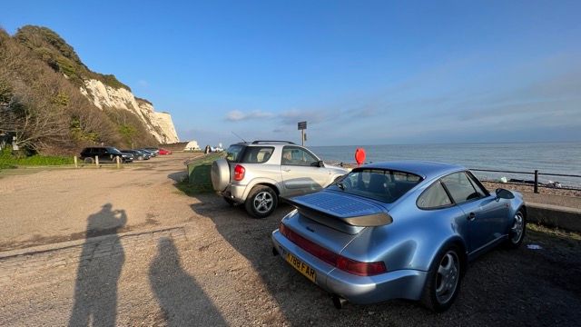

And we'll try that test drive again, shall we?.....
The car down at St Margarets Bay, near Dover. The "White Cliffs Of Dover" are in the distance in this shot....
....and the white house in the distance at sea level used to be owned by Noel Coward (playwrite, actor, singer....Mr Bridger in the original Italian Job), who then sold it to his good friend Ian Flemming....
So, has the PPS>Boost map change made a difference? It does feel a little more hair-trigger, naturally. But with the new super smooth throttle pedal, this is far more manageable than it once was. However, it also feels significantly more energetic and lively...."spirited" even. With normal road speed driving, it now feels extremely responsive, with just a very gentle squeeze of the throttle to teleport you right up and close any gaps in traffic. It also means that the previous transition from normal/relaxed to full-send is far better. Not as violent or pronounced because you've been building more boost up until that point, but is nicer and more controllable, really using the strengths of the twin scroll turbo and its building of boost lower down.
