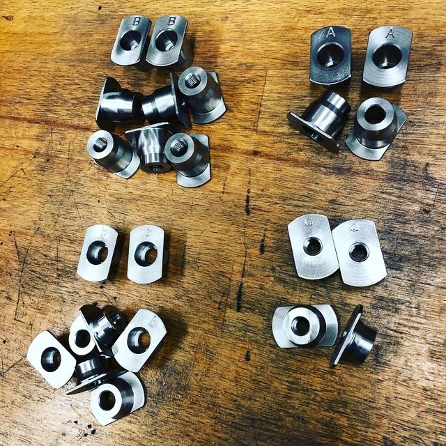

Morning folks, time for a long-overdue update.
Lots of progress, really am pleased with how it's all coming together (anyone following me on Instagram will have seen a lot of the progress already)
Heads torqued down with the cam carriers dry-fitted. Then time to build the carrier assembly with oil return tubes installed, and Threebond 1184 to seal between the housing and the heads. No drama there.
Knock sensor bridges then fitted - nice to see that my machining work on the underside of the heads has paid off, perfect alignment on both sides and ready for the sensors to be mounted.
Time to move onto the timing chain housings, now fully cleaned to remove the old Curil-T (jeez that stuff is a pig to clean off, there always seems to be a feint layer of it each time you think you've got it clean). Another dry fit of the housings to check how concentric the camshaft is relative to the thrust plate hole. The RH bank was more concentric, no idea why, but both were fine to use the gasket and with the o-rings installed onto the thrust plates with all 3 holes lining up fine. Again sealed with Threebond 1184.
Next job to re-check how parallel the sprockets are relative to the intermediate shaft. No reason why anything should've changed, and indeed it hadn't, 4 spacer shims on each cam (a 5th spacer would've brought the LH cam a little close to optimum, but without it it's still well within spec). Chain ramps reinstalled, and then I got to play with my new Stomski Racing chain tensioners.
Last time, I tried using clamps to hold the tensioner arms tight, but it was a pretty poor experience, with them getting knocked, then having to start again, a right PITA...can't beat having the right tools. Speaking of which, I also now got to use my pair of Mitutoyo Digimatic DTI's and PROPER Z-blocks. Again, last time I tried holding an analogue DTI on a magnetic base. It took lots of time to get it spot-on perpendicular to the valve, then the tip would slip off of the valve cap, start again....urghhh....I don't miss that method! The resolution on my analogue DTI was pretty high, so many sweeps of the hand to get the 1.26mm lift measurement...."did I just miscount?...or was I imagining it?....".....start again.
In the end, using a DTI on each bank, I did the whole timing exercise in comfortably less than 2 hours...AND got it spot-on 1.26mm on each side...no shortcuts or half measures, checked, double and triple checked, Chris was kind enough to mark my homework by watching a video I did of the 720º of rotation (such was my "that was waaay to easy" levels of paranoia!)
A razor blade held using (said) magnetic base for TDC observation. No idea why, but after many hours of checking TDC dwell, my TDC "Z" mark on the pulley doesn't align with the case parting line.
Once that's done, remove the Stomski's and substitute with the proper hydraulic tensioners ensuring that the chain never went slack. No problems there either.
Tuesday morning I started to build up the 4-5-6 bank with the rocker assembly and the TurboKraft rocker locks....
Valve lash set on the remaining 5 valves on that bank, get the valve covers on, and replace the timing box covers (Curil-T again, it worked well the first time....if it ain't broke...). Fitting the timing box cover to 1-2-3 chain is as far as I got the other day before other activities curtailed play.
Next job is to finish off the 1-2-3 bank rocker arms, cleaning them and replacing the RSR oil seals on the shafts with a new set and carefully inserting to avoid slicing the rubber on the cam housing.

Another productive few evenings, albeit sporadic with the odd hour or two here-and-there.
All the valve rockers are now back in, everything thoroughly washed, old RSR seals removed and replaced with a new set.
The TurboKraft rocker shaft locks are all in place, really nicely made items. All valve lashes set using the little tool I bought a few years ago. Really like this gadget, I've checked it numerous times with a feeler gauge, and it's spot on so long as you don't over-tighten the screw/foot too much before you rotate for 0.1mm clearance. Just a case of tightening it a few times to get the feel for how tight is just right, and as long as you can hold the thumbwheel still while tightening the locknut, then you're good.
Valve covers back on loosely for the time being, I need to finish the mounting posts for the CoP units. Timing chain covers also installed, along with the oil supply lines to the cams and tensioners.
The oil filter housing was flushed through and reinstalled with the new Wrightwood seals; easy job, another engine part out of my home office.
Intermediate shaft cover back on, new o-ring and a smear of Threebond 1184.
The cooling fan is back in place, primarily because the charging loom is still attached and run through the air shroud (I removed them all as a single assembly when I tore the engine down) - I needed to see how much clearance I have for the knock sensors, and whether I need to order them with a flying lead (same as the 964 Carrera part) or whether to buy a pair where the Junior Mini Timer plug attaches directly....leads me on to a question....
Q) Is there any electronic/sensitivity differences between various knock sensors, or are they all the same internally, it's just the packaging that changes? All the ones I've seen on the Bosch website specify a "Type Formula" of KS-1-K. Not sure what that means...
The Googling I’ve done so far is inconclusive as to whether there are sensitivity calibrations that are dependant upon bore size. I suspect this is wrong info, as the Bosch tables that describe each models application cover a variety of models of a manufacturer, as well as engine size.
The sensor on Syvecs' own site describes a frequency range of 1hz-20hz, which is most likely the unit I'll buy....just curious more than anything.
