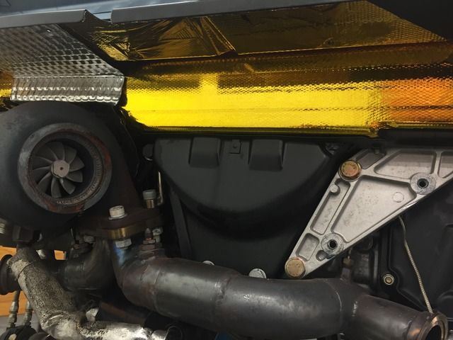

Spenny_b 04-19-2016 01:57 PM
I've got the bumper off, well worth spending less than an hour to get it removed, access is an order of magnetude easier.
It's also been a good exercise to perform an inspection of the components. A couple of points I've picked up...
1) Despite adding the various heat control measures, like the gold foil and Nimbus sheet metal shields, there's obviously significant heat travelling upwards...the rubber lined P-clips that hold the Lambda sensor harness in place on the top side of the engine tinware, are shot - the rubber completely burnt and crumbled.
2) At the time, it looked like a good idea to retain the Lambda harness in place; saves it getting caught, or dropping somewhere where it shouldn't. In retrospect, this makes it completely unserviceable should the Lambda fail. It's a bumper-off job to change it - that's no good, so I'll re-route it in a simpler way before reassembling everything.
3) I found a loose bolt on the silencer hanging bracket - needs split washers under the heads.
4) A few of the bumper fastener screws, that engage into the speed fasteners, have vibrated a little looser than I'd want. I'll fit new speed fasteners, clearly the original ones have lost their strength to hold tension against the screw.
5) Have now found an ideal route to thread the oil:air separator tank drain hose. It will now run down under the AC pump, where there's a spare rubber grommet in the tinware. From there, I can fasten it to one of the major engein oil lines, right up to the -8AN fitting that the turbo oil feeds into the drip tank. Perfect.
6) I may replace a lot of the thermal sleeving I've used on the various hoses that run near to the turbo and the silencer. I used the aluminised cloth sewn sleeves, but the extremes of heat have destroyed the reflective aluminium already. The material itself it holding up fine, if a little scruffy. Perhaps it's time to switch these sleeves for the orange silicon type. Doesn't look as nice, IMO, but it's about function not form.
I have to say that upon inspecting the components at the rear end, I'm stunned just how much heat has clearly been generated; lots of evidence of it, and I've only done 450 miles in total! In fairness, there's been an unnatural amount of idling whilst we've been tweaking the maps, so lots of static hot air, but even so...

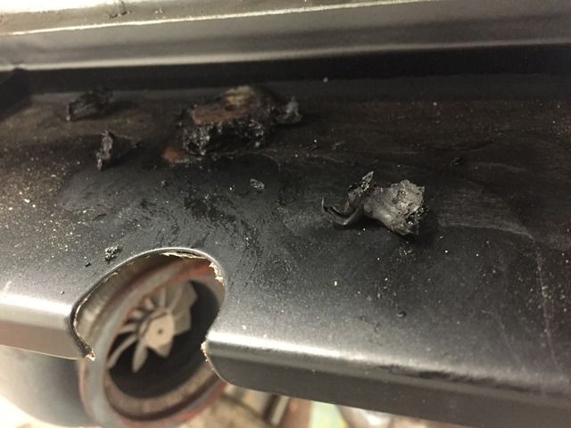

Spenny_b 04-20-2016 01:55 AM
Some pics from last nights night-shift. A good, productive couple of hours....
The nuked p-clips debris....
http://img.photobucket.com/albums/v2...3CD8E4A55D.jpg
These fasteners will also now be replaced with stainless items; the area was quite wet, some of the fixings already rusted.
Removal of the bumper and heat shields paying dividends; all the areas behind the shields look to be in fine fettle.

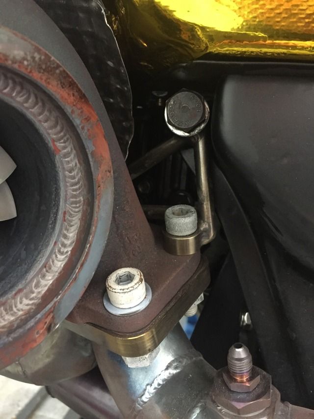

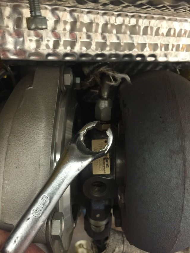

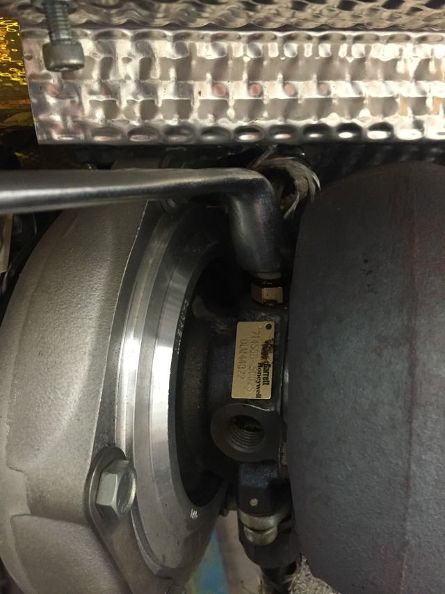

Access to the turbos supporting bracket fixing is now very easy (hoping to keep the turbo attached to the manifold for removal)
http://img.photobucket.com/albums/v2...C092EA5618.jpg
When originally fitting the oil feed hose to the turbo, I just about got by with the OE 9/16" spanner in my toolbox, but the width of the jaws allowed approximate 0.8659º of rotation before fouling the compressor housing. To remedy that, and in the same spirit of up-cycling my Grandads tools, I found one of his old offset ring spanners; brings the swinging height to the point of almost clearing the turbo housing and with the bi-hex ring, I can now really snug this hose fastening up nicely....
http://img.photobucket.com/albums/v2...FBAD2E4352.jpg
http://img.photobucket.com/albums/v2...17C2AC716F.jpg
So, not a million miles away now - just need to uncouple the heat take-off pipework and then start swearing at the 12 locknuts on the header flanges, then removing the system...definitely a two-man job with the turbo still attached.
Brainz 04-20-2016 05:55 AM
What is the small AN fitting for on the exhaust just before the turbo flange?
Sent from my Nexus 6 using Tapatalk
Spenny_b 04-20-2016 08:06 AM
It's one of the exhaust gas back-pressure connections, one on each secondary before the flange. They join onto stainless pipes that are about 50cm long before then interfacing to -3AN hoses, then into pressure sensors.
As it happens we've not been able to use them yet. Lots of work to install but we don't have a suitable map in the ECU to present the readings. Work for another day ($$$'s)
Also on the secondaries are 2x exhaust gas temp sensors that feed into a 4 channel AEM system, which then feeds into the ecu. That is up and running, and is useful info to see.

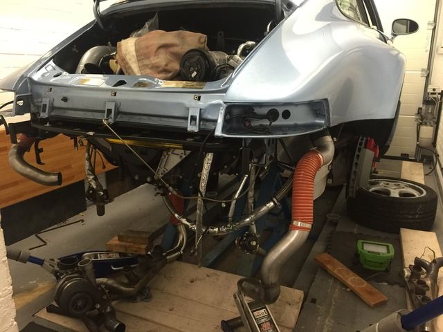

I can't believe how long this has taken, it's not a case of just getting the bumper off, there's so much else that needs to be removed, whole back-end of the car is in pieces, it seems. Talk about soul destroying, but there you go, it's necessary just to get to everything.
http://img.photobucket.com/albums/v2...F210D24637.jpg
Headers are finally now off, with the turbo still attached. A lot of the top-of-engine stuff has had to come back out yet again, just to get to the EGT sensor plug/socket....cunningly mounted under the inlet tract :rolleyes:
While it's all in pieces, now's the time to send the cold pipe out for powder coating. I've opened up the BOV as well, to see what spring is installed. After speaking with Chris a few weeks ago I may increase this spring rate, as it does open very easily when lifting.

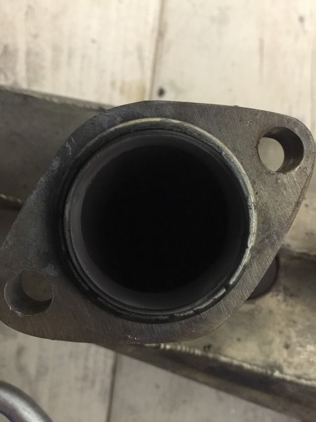

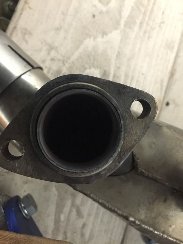

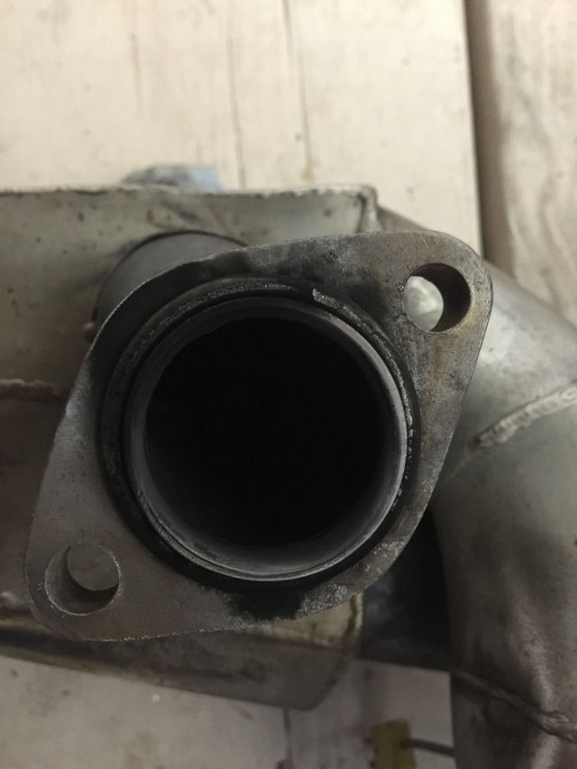

Looking at the headers and re-familiarising myself with how they seal, the blowing is quite obvious....
#6 - Not too bad, no evidence of soot on flange
http://img.photobucket.com/albums/v2...7D3ED487FB.jpg
#5 - Needs fixing
http://img.photobucket.com/albums/v2...4916221649.jpg
#4 - Not too bad, flange dirty but not sure yet if it's breaching gas.
http://img.photobucket.com/albums/v2...638BB7037C.jpg
#3 - Not too bad
http://img.photobucket.com/albums/v2...FDF1904AB5.jpg
#2 - Not too bad
http://img.photobucket.com/albums/v2...3379E9AD51.jpg
#1 - Worst of the lot, needs fixing
http://img.photobucket.com/albums/v2...7E33A779A5.jpg

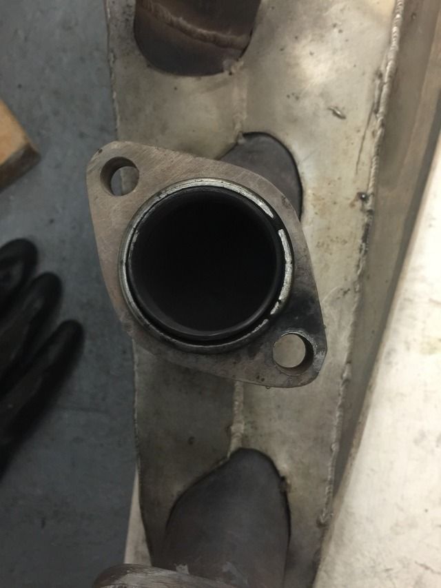

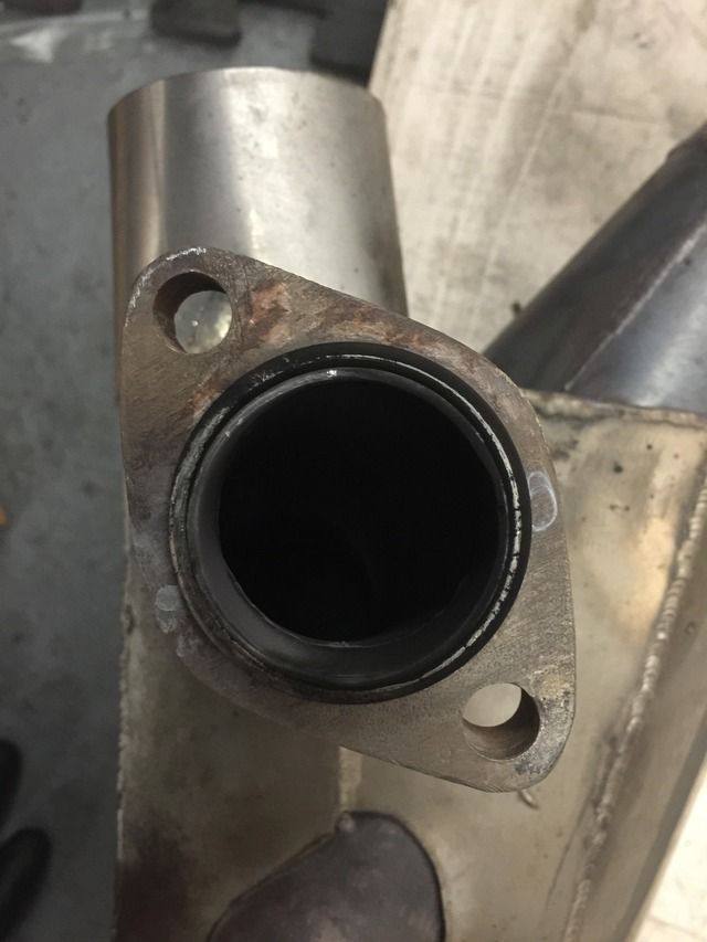

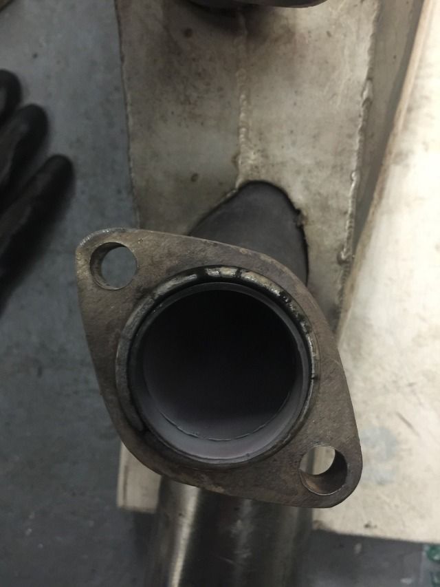

The first job will be to check how flat the flanges are; simple to check, a pain in the arse to rectify if required, with the primaries protruding through. I'll get the vernier out again and re-check the step depth in the exhaust ports.
While a lot of the top-side components are out of the way, I'll likely get the old dampers removed and fit the new ones. Getting to the 3x top mount fixings at each corner is impossible with everything installed. To that end, all the required components have been ordered from Porsche, so hopefully it'll be a straightforward swap in a week or two's time (and I get to use my torque multiplier again to undo the M14 lower damper bolts...."should be a breeze").
Spenny_b 04-24-2016 03:41 PM
Just some light duties this evening to report on.
A check with a (new) steel rule against each of the header flanges shows that they are indeed flat. Thank God. Checked in the 4 planes on each of the "diamond" surfaces.
Here's some corresponding pics of the ones from yesterdays sooty header photos:
1-2-3....
http://img.photobucket.com/albums/v2...BE61CA5F52.jpg
4-5-6...
http://img.photobucket.com/albums/v2...B02A17A694.jpg
Look like hell, don't they? Annoying, but it justifies pulling everything to pieces I guess.

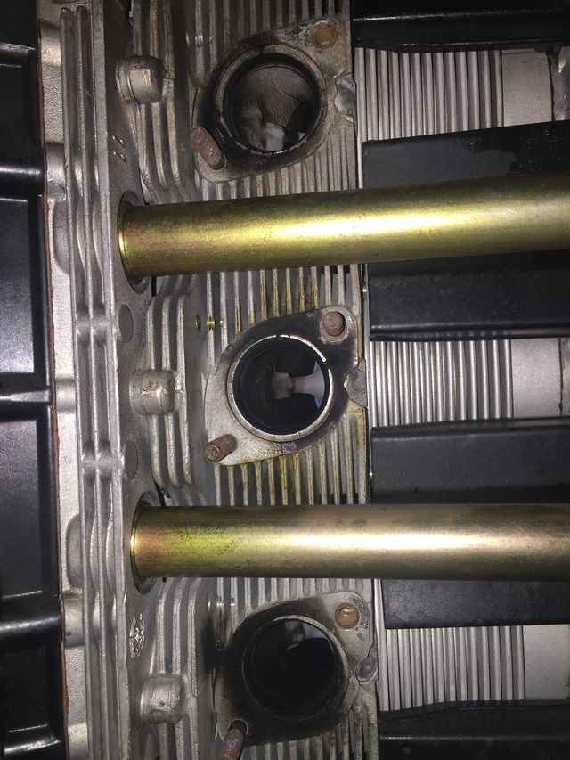

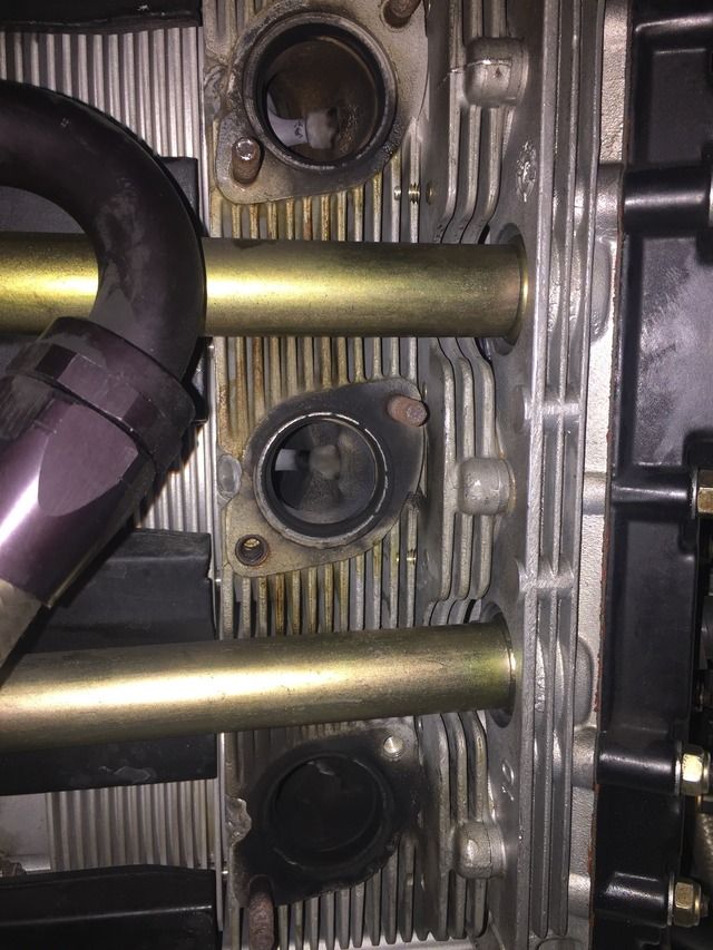

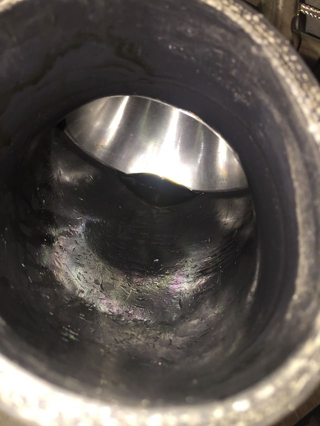

What's also annoying is that when I was casually peering down the intake elbow for the turbo, I saw this...
http://img.photobucket.com/albums/v2...B5A4F30354.jpg
I'm bloody plagued by oil issues. A quick shove of finger down the silicon elbow that accommodates the oil:air separator tank from the main oil tank, and it's dry. The end of the inlet tract (that enters into the turbo elbow) and there's signs of oil.
So, the only other place it can be coming from, is from the (long) breather hose that comes up from the turbo drip tank, through the tinware and across to underneath the inlet tract, joining half way along.

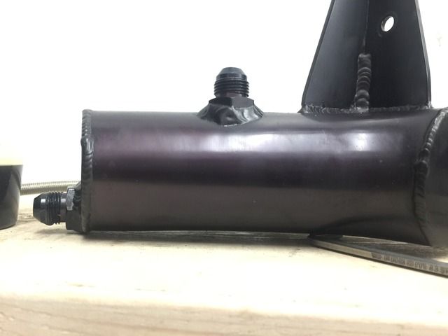

I confess to be a little puzzled when I removed the drip tank yesterday, as to how much oil drained out. It wasn't gushing out, but neither was it only a few drips. For once I had the forethought to grab a container before trusting the tank was empty and undoing the connection...
http://img.photobucket.com/albums/v2...C87A4B58_5.jpg
And when you compare that the size of the tank and its outlet...
http://img.photobucket.com/albums/v2...B4A9BB1E_1.jpg
Maybe this is normal, but my expectation was that because the oil feed into the GT35R has been restricted (versus the way the K27's journal bearing is flood-fed), that the auxiliary pump would have no problem keeping pace, leaving the tank empty at all times. In fact, I had considered whether the pump would be sucking air because of the lesser quantity of oil.
Now I'm wondering whether the aux pump is actually working correctly. I guess a check would be to use a short length of clear tubing in between the swaged hose and the oil tank entry, and observe the oil flow.
Or maybe that's a complete red-herring, the drip tank and Aux pump are fine, but the induction is sucking up the oil from the tank.
Or maybe the oil in the turbo is perhaps a turbo seal that's gone? (find that hard to believe, as there's evidence of oil upstream in the inlet tract, but welcome any educated thoughts)

WERK I 04-24-2016 06:31 PM
"Maybe this is normal, but my expectation was that because the oil feed into the GT35R has been restricted (versus the way the K27's journal bearing is flood-fed), that the auxiliary pump would have no problem keeping pace, leaving the tank empty at all times. In fact, I had considered whether the pump would be sucking air because of the lesser quantity of oil.
Now I'm wondering whether the aux pump is actually working correctly. I guess a check would be to use a short length of clear tubing in between the swaged hose and the oil tank entry, and observe the oil flow."
Or, you may have an air leak between the suction end of the turbo sump pump and the turbo sump tank.
