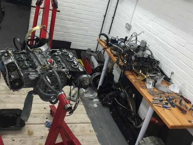

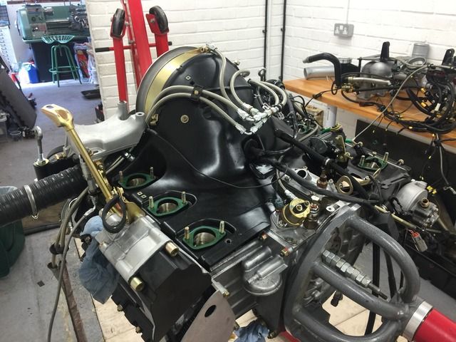

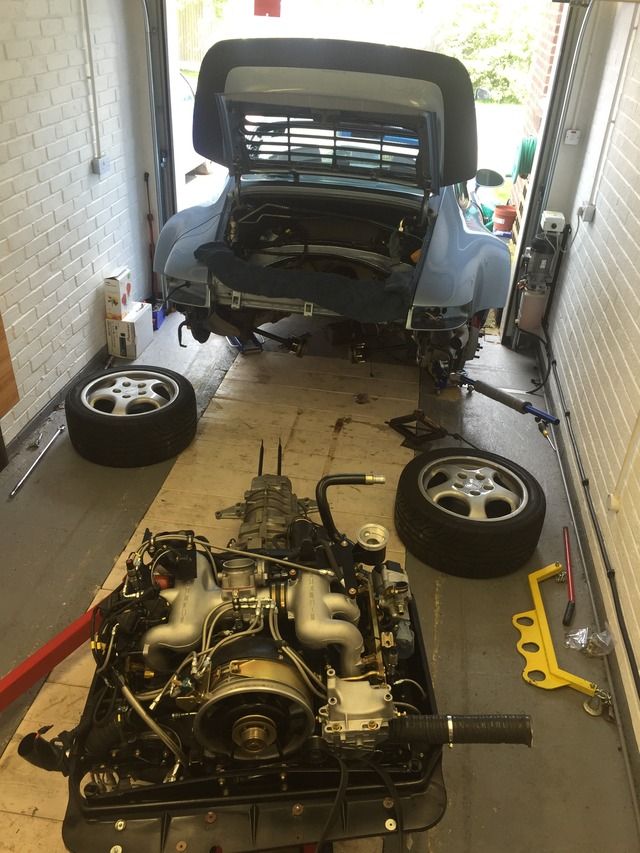

Spenny_b 05-17-2016 04:38 PM
Progress update....
Finally got the engine and trans removed by midday on Sunday (some car storage logistics got in the way on Sat). As John mentioned, getting a little quicker at this now, but not a job I want any more practice doing...
http://img.photobucket.com/albums/v2...6595B30308.jpg
Build-up the engine stand (it's a heavy bugger!), get the engine mounted, and it's teardown time.
Sorry Sir, I didn't quite catch that, "A complete EFI system, ready to go" you say? Well, yes indeed, it is.... Sorry, not for sale....
http://img.photobucket.com/albums/v2...53FB0C297F.jpg
The usual stripdown pics....
http://img.photobucket.com/albums/v2...2ABF01C297.jpg
http://img.photobucket.com/albums/v2...D96ED9E768.jpg
And this is where we're at as-of midnight this evening...
http://img.photobucket.com/albums/v2...0B95435BA8.jpg
http://img.photobucket.com/albums/v2...7D09FC361A.jpg
Lots of careful bagging and storing. Running out of space, may need to borrow a few wallpapering tables. Hoping to get the top end for each bank off by end of play tomorrow night.
