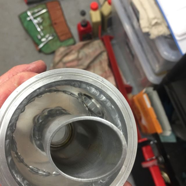

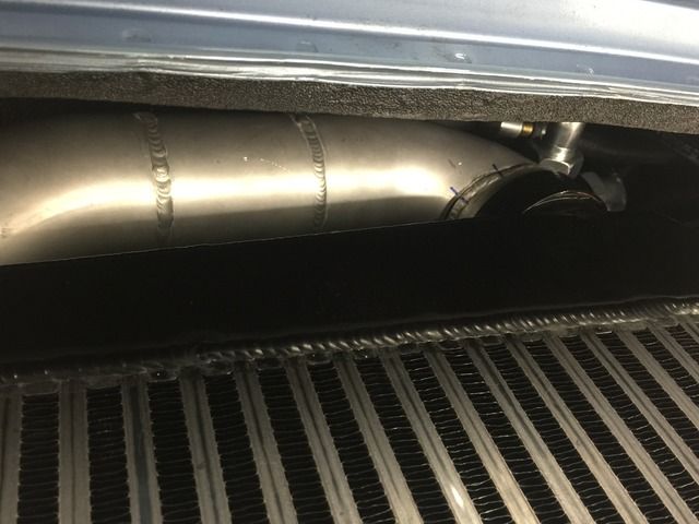

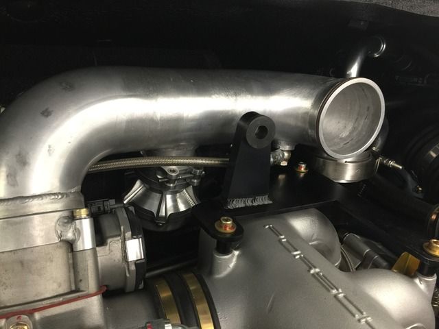

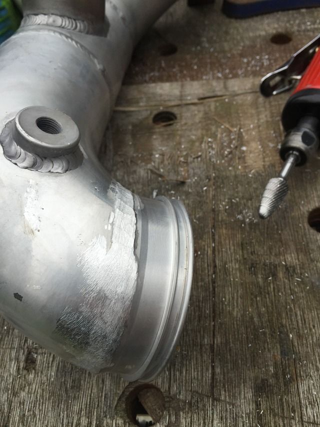

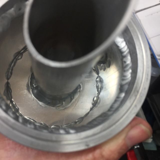

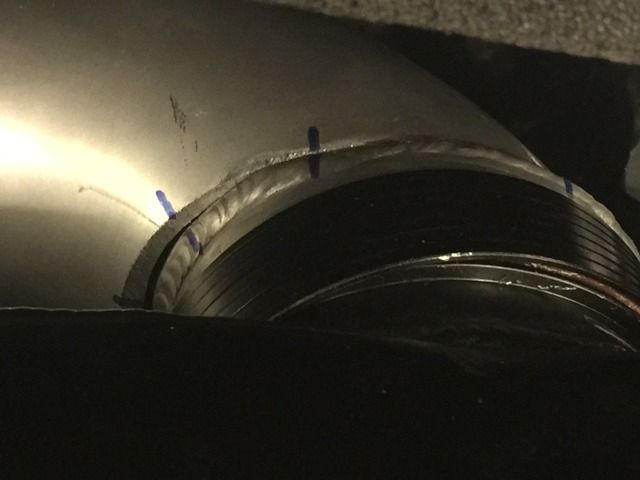

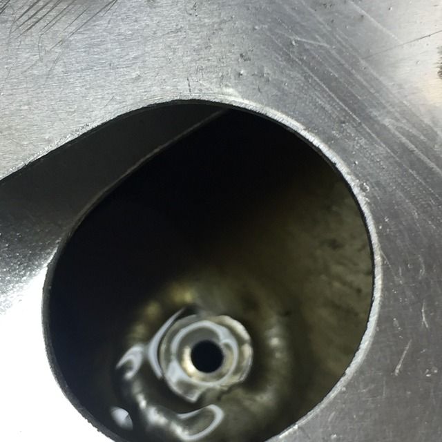

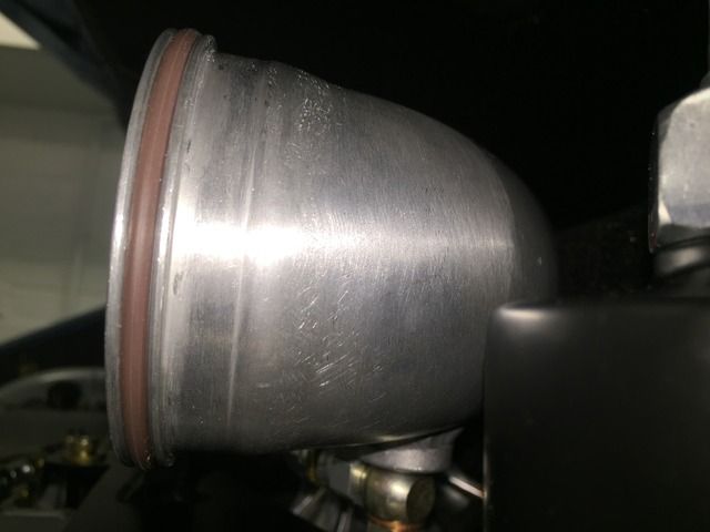

A job I've been to do for a while now, is to re-work the cold IC pipe (the IC exit pipe that runs to the throttle body). I got it slightly wrong when we fabricated it, perhaps some movement with the heat of welding, who knows, but it was negating the quick-release design of the IC, turning a 2min job into an hours wrestling/swearing match.
The part needed dipping into the chemical solution to remove the black anodising - my plating shop duly obliged while I waited, then time to start planning where to surgically insert the hacksaw. I have to say, I'm really pleased I took the plunge with this job - got it right pretty-much first time, didn't need Lewis to do in-situ welding and it looks a lot neater than it ever did (well, it will once it's powder coated).
http://img.photobucket.com/albums/v2...t/IMG_8321.jpg
http://img.photobucket.com/albums/v2...t/IMG_8322.jpg
http://img.photobucket.com/albums/v2...G_8329%202.jpg
http://img.photobucket.com/albums/v2...G_8336%202.jpg
http://img.photobucket.com/albums/v2...G_8334%202.jpg
I also took the opportunity to smooth out the two welds of the centre section, which is where the BOV is mounted....a lot cleaner looking.

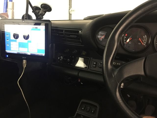

Next job was to check the plugs and COP's; I had a nagging doubt that a repeat of one of the ignition issues from when we were on the dyno (...almost a year ago. Can't believe I'm typing that). One ignition issue was down to an unseated pin in the harness, which was temporarily corrected at the time, and rectified properly soon afterwards. The other issue was what appeared to be a blown Bosch 3-channel amplifier, as we had a whole bank of dead lower plugs on 4-5-6. We still don't know what we did to fix it - possibly a slightly unseated connection onto that amplifier - and at the time we didn't care as the clock was ticking big-time.
Some testing via the diagnostics functions on the MBE Easimap software confirmed that all 12 sparks were present and correct. Thankfully. I've also bought one of these, as a way to quickly test COP operation; nothing fancy that shows a trace on a 'scope, but sometimes just a go/no-go is more than fine. I've not used it yet, but it should start flashing lights and beeping when it's layed on top of each COP. Will report back when I try it.....

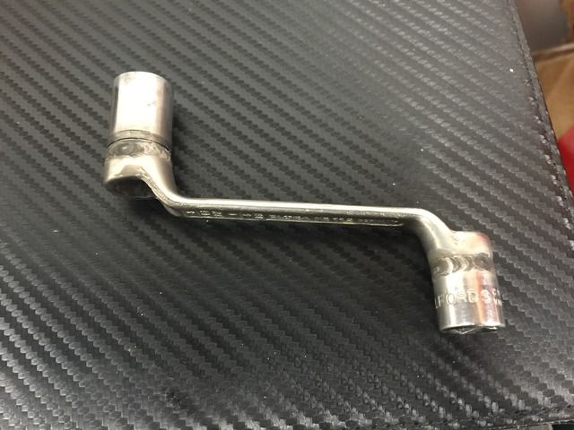

Another welding job next....making a custom exhaust stud nut spanner. It suddenly struck me, whilst upside down under the car, that I have a few tools that were once my Grandads. They never get used, but as it happens, the PERFECT cranked ring spanner was sitting in my tool box all the time. Perfect length and crank offset, but it was a Whitworth size!
A spare 1/4" drive 13mm socket, and a 1/4" > 3/8" adapter, plus a £5 note and a 12mile drive....
http://img.photobucket.com/albums/v2...t/IMG_8344.jpg
It's spot-on. It allows be to get a wobble extension bar on there, and another half to 3/4 of a turn on each nut without fear of rounding it off.

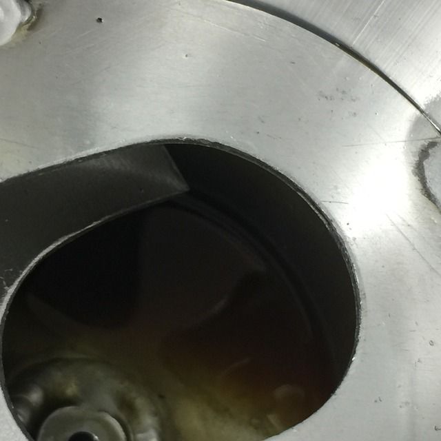

However....when I reached under the RHS rocker panel to fit a jacking puck, I noticed that the underside was wet with oil. Simple enough to check, just jack the car, remove wheel remove the inner arch to expose the oil tank, as a starter-for-ten. Sure enough, oil coming from the top ventilation 1" diameter hose (oil tank breather), and had run down the tank and under the rocker panel/shark-fin. All hoses still tight (after I previously removed, cleaned, and checked that they were indeed connected to the correct ports).
My best guess is that by re-routing the drain hose, all I've done is move the problem somewhere else, and still back-pressurising the breathing circuit. Chris was gracious enough to not say "told you so" when we spoke the other evening.

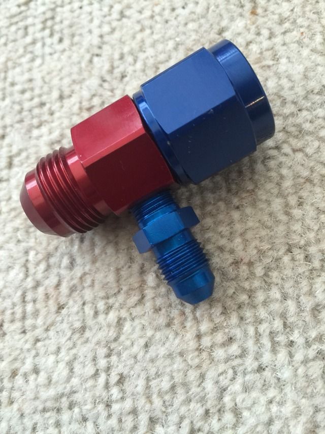

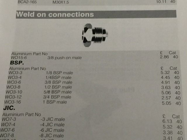

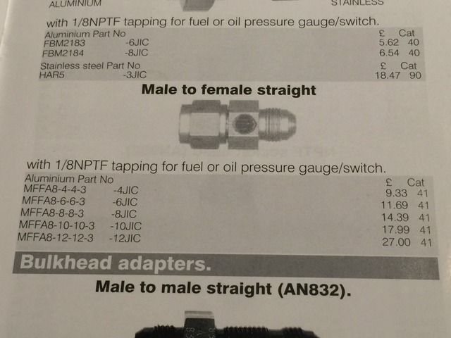

Looking through an old 2012 Think Automotive catalogue, I think we have a plan for the connecting of the drain hose into the turbo drip tank.
A -8 one of these....
http://img.photobucket.com/albums/v2...1007AE72AE.jpg
Plus a -4 one of these....
http://img.photobucket.com/albums/v2...956e82349a.jpg
Plus a new length of -4 hose, re-use the 90º fitting and some of that orange fireproof sleeving (for all the hoses near the turbo, they're looking a little cooked).
Some welding from Pete or Lewis, and maybe get it anodised, and it'll be job done. May need to shorten the hose which is to accommodate this adapter, but that'll be simple enough.

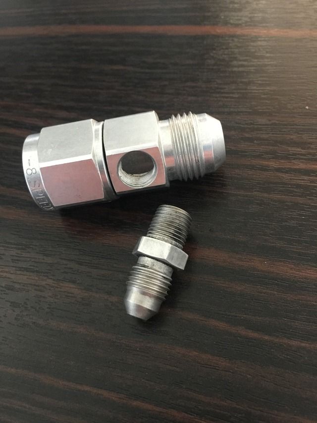

The items from Think Automotive arrived yesterday. Great news, Tino who was the "go to guy" there is now back! He left for about 6mths, real loss I have to say, but was chuffed to hear him at the end of the phone on Tuesday!
Parts that have arrived:
http://img.photobucket.com/albums/v2...AC5FDDB7_1.jpg
I also had a thought about where to plumb this -8AN "T"...first thought was at the very bottom of the -8AN breather hose, which vents from the turbo drip tank to the air inlet tract.
It could also go at the end of the short run between the turbo outlet and the tank inlet.
Both of those may mean reworking some of the tinware above the turbo, to cater for this additional hose, and possibly some shortening of existing -8 hoses.
Alternatively, the auxialiary scavenge pump pulls the drip tank oil via a -8 line, and if you remember, it is filtered via a Mocal inline filter assy, before the turbo oil gets to the pump (therefore, oil returned to the main tank is filtered, and the pump is protected from any catastrophic turbo failure).
I could return the OAS drain line into this -8 scavenge pump line, before the filter, so it would be pulled from the OAS tank (to a small extent) by the pump? Neater, and I could probably find an existing bunged hole in the LH tinware to feed the hose through?

The tablet PC is also now rigged up, with double-suction cup windscreen mount (although it doesn't sit in the windscreen - it rests nicely on the folded down glovebox door) so Ollie can keep an eye out on the EasiMap dashboard for anything abnormal.

Tonights job is for me to rig up said tablet, connect it to either my Wi-Fi network or tether to my cellphone (4G) so that we can use TeamViewer to do some live mapping. Steve @ SBD and I spoke at length last night about some tweaking that is needed (now that the bloody hose is connected) to get it driving nicer at slow speeds.
To assist with this, Lucy plonked herself in the passenger seat and used my phone to record the tablet with EasiMap running, whilst I drove around town, simulating the kangarooing symptom that is now evident. Despite what some think, I'm no "maximum attack" speed freak - sometimes it is nice to just cruise around at slow speeds! Plus, our town has a strictly enforced 20mph speed limit, which at the moment is very tricky without slipping the clutch of riding the brakes.
We also got a few data logs logged - all the hard data is useful but as Steve says, sometimes to see it first hand on a video and hear in the background exactly what's happening, is equally useful.
It appears that now the intake hole is plugged, the reduction in air into the plenum is akin to a lesser throttle opening, and igntion advance is being used by the ECU to "prop-up" the slow speed running. Hopefully, tonights session should a) make sure there's nothing disasterous going on, and b) dial things in a little closer, ready for the long-haul* trip on Saturday, making it nicer to drive.

Well....wow!
The perfect evening....a timely conclusion to the day-job, the sun had been out all day, nice dry roads...perfect for a drive around.
The technology proved to work absolutely faultlessly. First order of the evening was to address the cold starts, seeing exactly what it's doing and understand why its stalling for the first 2 attempts, then only just catching itself on the 3rd pull. Of course, only one shot at a cold start, so a good 20-30mins were spent fine tuning some things, and making some quite radical changes to others. Logic says that we've done should now work.
Don't forget, that because of the disconnected breather hose to the inlet, some parts of the map needed to be re-worked completely.
Until the point where we fired up the engine, we were pretty confident that this is now nailed. The caveat being, that Steve has made some huge changes to the low speed maps which may well now affect how the cold start performs tomorrow. In any case, idling is now a lot cleaner, somehow a lot smoother feeling.
Lots of experimentation, some things which are counter-intuitive and almost going against what the Lambda is trying to trim, by writing new compensation maps. As anyone who's done serious amounts of mapping will testify, change one thing and many other characterisitics can also change, things like throttling-off and how quickly the revs drop, how it transitions from one map to another, how the TPS map interacts with the pressure based map, and so on.
So, time for me to drive around with handsfree headphones in ears (Phone 1, iPhone 5S), the tablet in place but not being used (we found it to be a little hamstrung with its Intel mobile CPU, doing live mapping, Team Viewer and a tethered cell connection...just a tad too slow to make remote mapping comfortable), Phone 2 (iPhone 6+) doing the data connection, and my Mac on the passenger seat with the seatbelt on!
Quick photo of just the tablet in place - the mount does a really good job so long as its supported underneath. Too bouncy otherwise.
http://img.photobucket.com/albums/v2...A62AB18E_5.jpg
Steve was able to observe everything that was happening, with me correlating that
with what I was doing (or about to do), and what sensation I observed from the seat. A few regular stops in lay-bys for Steve to then make adjustments to maps, then another drive around.
From an IT persective, some interesting observations; even 1-2 bars of 3G signal is enough - just - to maintain the remote desktop session. 3 or more bars of 3G signal and it's fine, a nice constant connection back to the SBD Motorsport HQ in Surrey. Very little of my route had any 4G signal, so can't comment on that - it could be that just a single bar of 4G signal iwould deliver the same connection experience as 3 bars of 3G.
Secondly, my monthly data allowance with EE is 2GB. After about an hour of a live RDP session, I had visions of me blowing the limit and receiving a rediculous mobile bill. But no. I didn't check my month-to-date data use before we started, but after we had completed the work, my current period usage is only 460MB...so, Team Viewer 11 looks to be fantastically efficient; RDP isn't my field of expertise so I can only assume that it's really good at sending only change data across the wire. Whether there's any compression going on, I don't know. Really nice software, so simple to set up and works flawlessly.
This evenings session was about 3hrs of work....how does it now feel? Like a completely different car. Literally, night-and-day different.

2) The headers are leaking, and are now showing more evidence of this on the fins, now that decent mileage has been put onto the engine. When I described the ally "rings" that I was supplied with in the Victor Reinz kit, he looked puzzled and said that the official Porsche ones aren't round in profile (as if they were an aluminium o-ring) but instead have a flat flange on one side (faces the inside of the head) and a compressable surface on the header side. I'll order a set from my OPC and then bite the bullet to remove the headers. Worth it, I think, as it does slightly ruin the sound when idling.
