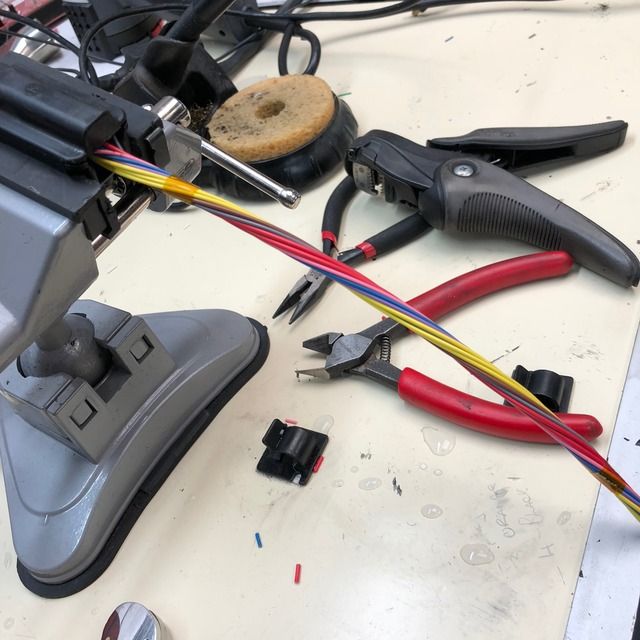

New engine "chassis" loom now made by Simon @ Sileck, and another grand job it is too. Made using Raychem Type 44 wire (as are the other harnesses) and wrapped in more Raychem DR-25 sleeving, plus "Claremont" green kevlar sleeving over the starter motor +VE cable. We've used a pukka Raychem "T" boot for the split outside of the shroud, the area that looked really quite scruffy on my version of the harness, where the glued heatshrink had given up.
The drawing board, literally...
http://img.photobucket.com/albums/v2...d/IMG_1908.jpg
Cannibalising my original (new) harness...
http://img.photobucket.com/albums/v2...d/IMG_1910.jpg
In progress, soldering onto the original Txx connector that interfaces chassis to engine...
http://img.photobucket.com/albums/v2...d/IMG_1895.jpg
Finished article...
http://img.photobucket.com/albums/v2...d/IMG_1907.jpg
What's left of my loom, made 5yrs ago. Connector plugs, grommets and covers carefully removed, as they're no longer available from Porsche
http://img.photobucket.com/albums/v2...d/IMG_1909.jpg
