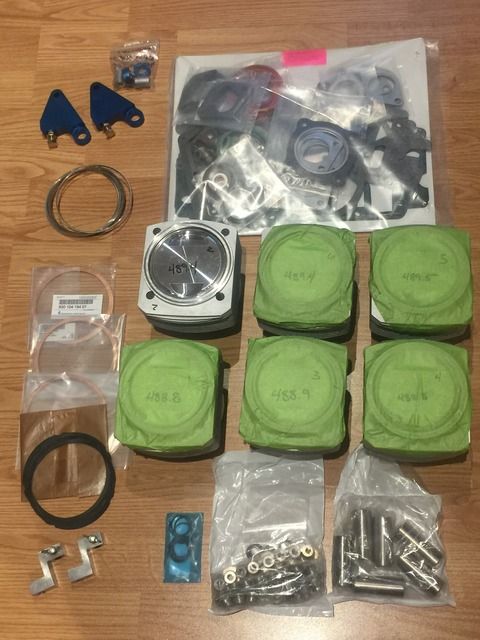

A week or so ago, I received a nice big couple of boxes from good old Chris and the gang at TK!
1) A set of reworked cylinders
2) Beautifully coated CP Carillo pistons
3) Some new Ni-resist flame rings
4) A set of TurboKraft rocker shaft locks
5) A pair of Z blocks; I now have 2x Mitutoyo digital DTI's, so why not be able to mount both simultaneously onto the engine?
6) A set of Stromski cam chain tensioners (I really didn't like using some G-clamps to try and do this the last time I built the engine...a bit too unrepeatable for me)
7) A Wrightwood top-end gasket set
8) 4 sets of cylinder base gaskets, various thicknesses, in order to dial-in the compression ratios.
http://img.photobucket.com/albums/v2...d/IMG_0337.jpg
Speaking to Chris over the last year or so, it very much made sense to ask the guys to look after the whole-shebbang, seeing as they're looking after getting the cylinders reworked, and spec'ing the pistons. So, Mike (TK) has looked after the ring-gap setting, thoroughly cleaning the cylinders (i.e., mega-cleaning them to ensure no honing residue is in the grain of the cylinder walls), and then assembling the pistons into the cylinders.
Piston assembly is something I have done dozens and dozens of times before, on many engines, and a few times on this engine whilst building it the first time.....but...such is my paranoia with making abso-bloody-lutely sure this second rebuild goes perfectly, that asking TK to ship them over to me pre-assembled means that it's another thing off the list of things that can go wrong.
Also worth noting that the rings on these new pistons are now 1mm rather than the previous 1.5mm. The crown and underside is also significantly different from my old Omegas, they look mega, really pleased with them.

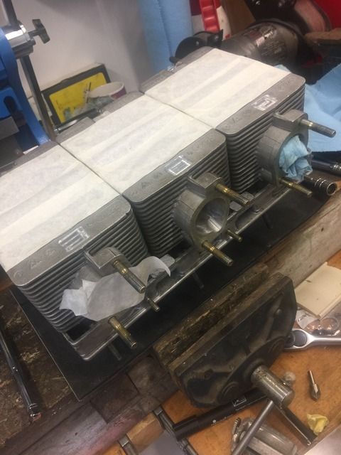

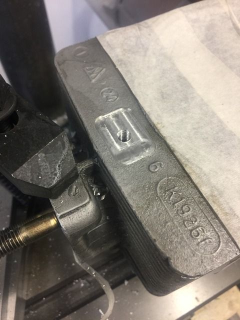

So this weekend was my first opportunity to actually get started with the rebuild. First job was to think about how to accommodate the pair of knock sensor bridges I bought many moons ago.
Mulling over several options, and after saying to Chris that I was determined to keep the 3x heads & cam housing all built (to save time with the rebuild)....it turns out I couldn't keep it all in-tact. Firstly, mounting the whole thing upside down to them machine the 3x mounting holes was very tricky. Not having a proper mill with a bed that's big enough to mount it, is the limiting factor; my pillar drill is uber-heavy and more than ample to do light milling duties, but my X-Y table just isn't big enough to mount it.
So....time to break it all down, remove the cams, rockers, shafts and then separate the heads from the carrier. This needed the use of my floor-standing hydraulic press....

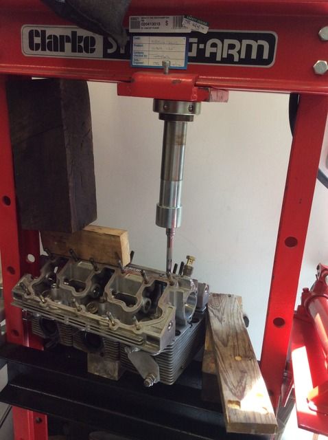

http://img.photobucket.com/albums/v2...d/IMG_0024.jpg
A nut onto each of the head studs (to save damaging the studs), and then a 13mm socket with an additional nut inside it, and a 3/8" extension bar, and it was all freed up very easily. A lot more elegant and less risky than smacking it with a hammer.

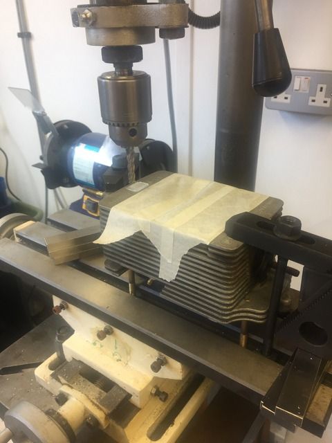

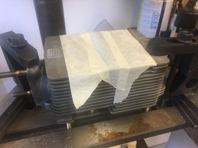

The cam housing will be fully cleaned up in due course, but onto machining the underside of the heads. Unfortunately I don't have a 16mm spot-facing tool, so I used my 8mm end-mill to machine a square landing area for the bridge to mount onto.
Heads clamped down nice and tight, and the job's a good'un....
http://img.photobucket.com/albums/v2...d/IMG_0327.jpg
http://img.photobucket.com/albums/v2...d/IMG_0329.jpg

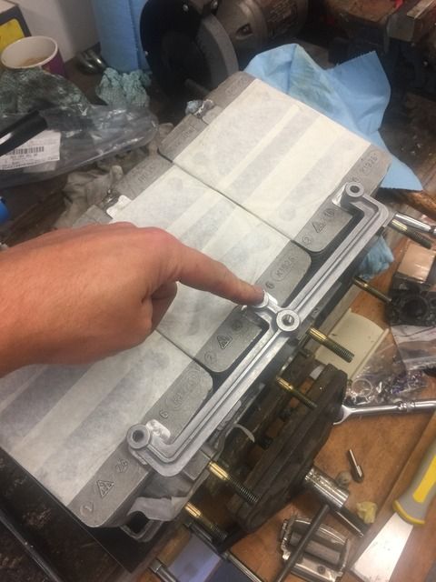

Refit the heads to the cam housing to mark the hole centres...
http://img.photobucket.com/albums/v2...d/IMG_0332.jpg
Once marked-up....
http://img.photobucket.com/albums/v2...d/IMG_0331.jpg
...time to then re-mount each head for drilling and tapping...
http://img.photobucket.com/albums/v2...d/IMG_0334.jpg
Lovely job. I'll clean the cam housing before re-fitting the heads and checking the bridge mounting. This was for just the 1-2-3 bank; tomorrow night it's time to do 4-5-6. Should be quicker, as I now have the procedure sorted, blocks of wood at hand, machine clamps set up, etc, etc.

First job, finish off the drilling and tapping of the holes on the underside of 4-5-6 cylinder heads. A gentle test of arm strength, and all was good, working very slowly in a considered manner.
[Sidenote] My arm had been healing really well for the last 3wks, and a consultation with the fracture doctor the day before had been very positive, even going so far as to say that I could try driving (in a safe empty car park), and if in full control, then I could drive on the roads again. His parting words were that unless I fell on it again, I won't displace the fracture at this point in the mending process.....(you know what's coming next, eh?) [/sidenote]
Cylinder heads finished, no problem at all, very pleased. Basically a repeat of the 1-2-3 procedure from a few weeks ago. Another job off the list.

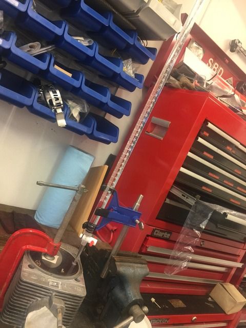

While the heads are broken down, now was the time to perform my cylinder head volume measurements. I had a piece of thick perspex from years ago, doing the original CR checks, but it was a square piece made in a rush and needed rounding off. So I moved my belt sander outside and set up on the workbench (messy job, sunny day) and carefully sanded the Perspex into a circular disc that matched inside diameter of the cylinder head. This was working brilliantly, I just needed to drill another hole to let the air escape from the chamber whilst I was filling it with water.
As you can see below I set up a rig to hold my new burette and had two attempts to fill the cylinder head chamber. The calculated volume this time was 87.7cc versus the calculation I did a few years ago using a stacked flame ring which gave me a volume of 90 cc. The G-clamp is just nipped up enough to seal the perspex to the head (with a layer of grease),not tightened enough to deflect the sheet concave, and alter results....in fact, fill #2 I did it without the cramp, so I could position the head with the air pocket uppermost.

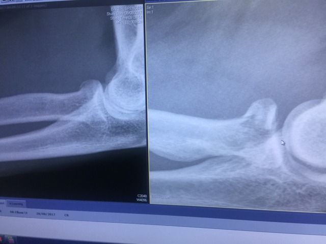

So everything is going very well but it was time to pack up the tools outside. I went to carry the belt sander indoors, which was fine until I got within a foot of the workbench, at which point I must have twisted my left wrist in a way that it wasn’t supposed to go and the next thing I knew I was in excruciating pain. The sensation was very much like a dislocation combined with the trapped nerve sensation you feel when you’re back "goes". Apart from anything else it was actually quite scary and for 30 minutes I could barely move. I was quickly turning the air blue with some robust Anglo Saxon, turning a not-so-great shade of red and foaming like a rabid dog. Long story short, and after nine hours in our local hospital A&E department, a before-and-after x-ray showed that I had snapped off the top of my radius bone (the radial tip, which was previously "only" fractured), see the photo below.
http://img.photobucket.com/albums/v2...d/IMG_0698.jpg
(in the LH pic, the shadow at the radius of the bone was the original fracture, which I can't help feeling doesn't show the full extent of that first break. Spot the difference to the RH pic)
Without a word of a lie it was an order of magnitude more painful then when I originally broke my elbow! I’m currently waiting until Tuesday afternoon when I see a specialist who focuses on elbows and shoulder injuries (not the same guy as last week! So much for his confidence in its strength), and it will be decided whether I need to have an operation to pin that bone back into place. Until then it’s a case of taking a concoction of painkilling tablets. That’ll teach me!
I don’t think I’ll be able to do any more work for at least six weeks and at this point I ought not to be too adventurous. My arm really is now permanently in a sling, I dare not take it out. Arse.
