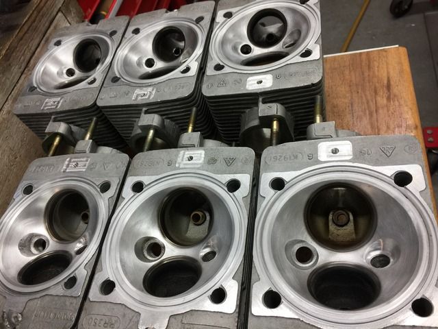

Hey Pat,
I've been out in the workshop this evening doing more lapping in of the cylinders to the heads (wasn't entirely satisfied that they were as good as they could be last week). You were right, and something I've never noticed - the factory spark plug castings *are* different on one of the heads!
The shape on 5 of the heads....
http://forums.pelicanparts.com/uploa...1510096086.jpg
The shape on the other head. Clearly it's come from factory like that, as it's the raw casting surface finish....
http://forums.pelicanparts.com/uploa...1510096126.jpg
Now interestingly, 5 of the heads have an identifier of "6" under the intake valve...(excuse the dirty grime - lapping paste that I only wiped off - full cleaning in the tank tomorrow)
http://forums.pelicanparts.com/uploa...1510096418.jpg
And the odd one has an identifier of "4" and also has less well defined Porsche part number on the left of the photo....
http://forums.pelicanparts.com/uploa...1510096479.jpg
No idea what's happened in the cars life for this to be the case - no point worrying about it, can't change anything other than buying a set of CNC machined heads.

Good evening Spencer,
Yes, it is strange to see that, because normally breeches must be identical to have a well-balanced CR.
It is not very reassuring at first sight, but now you have maybe way(means) to improve the balance of the volume of breeches, there are no modifications to be made.
Not grave for the dirt, I know what what know how to work on an engine. :)
